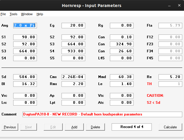

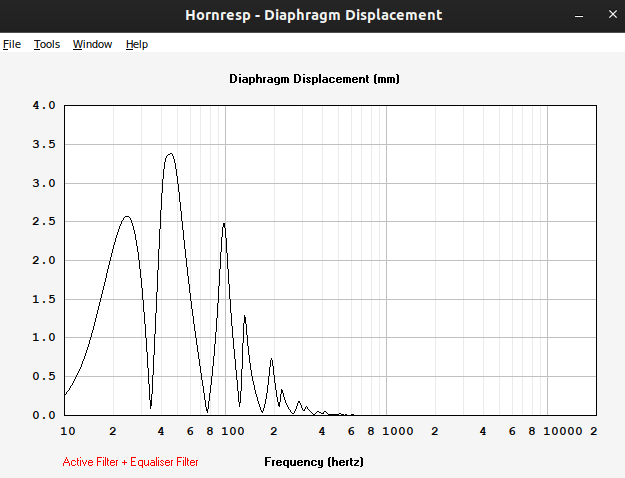

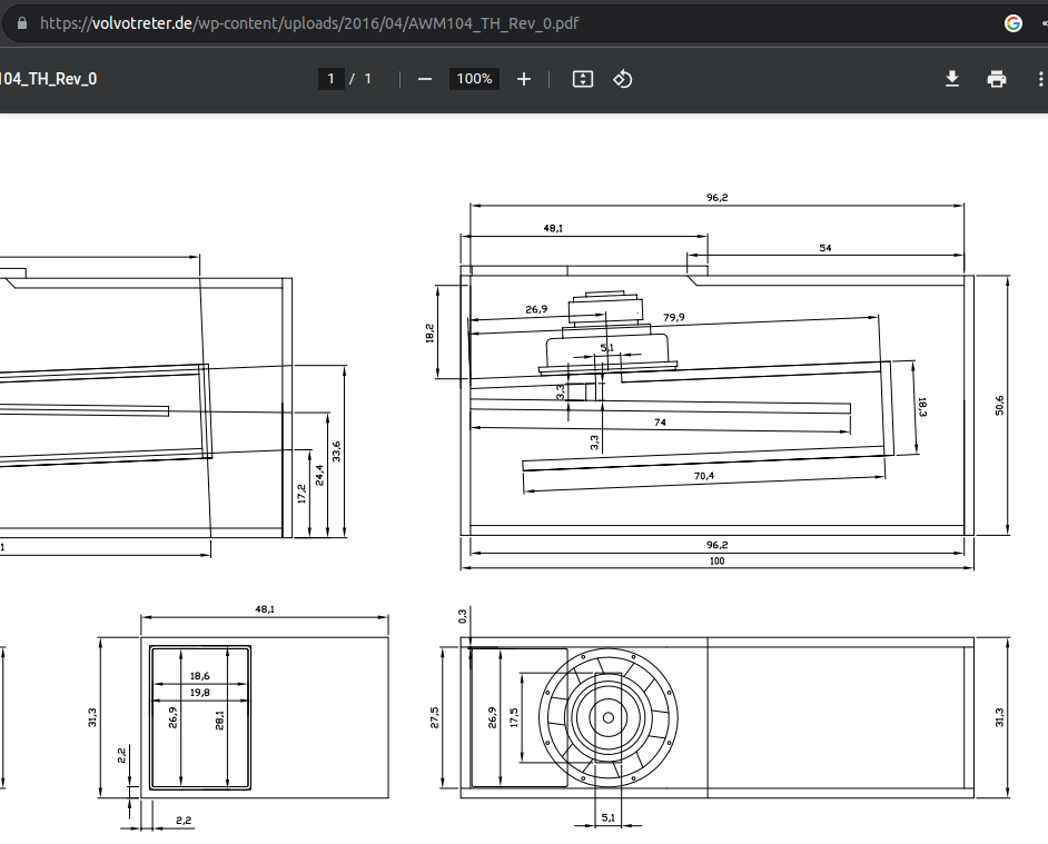

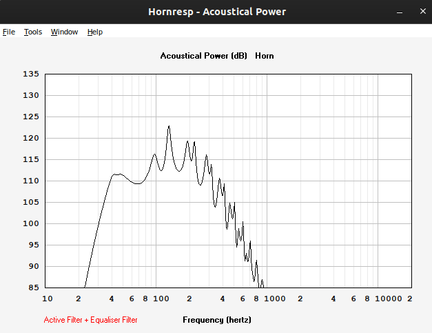

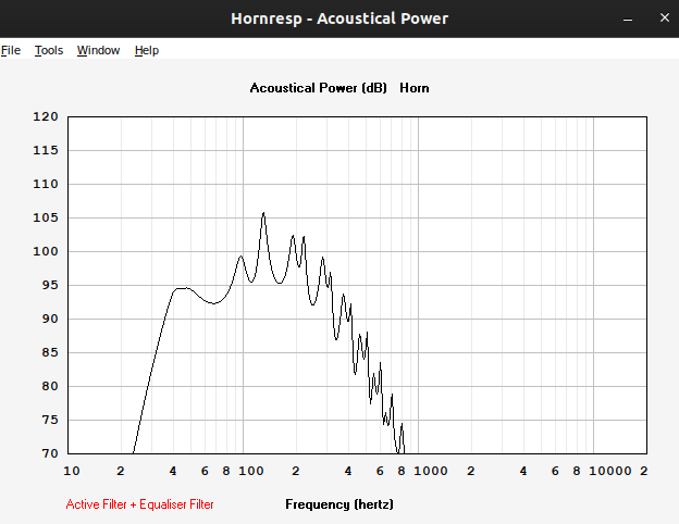

Had a conversation with Mark (Kravchenko_Audio) and exploring a tapped horn with the PA310-8. I plugged away on some sims and this might be an option. There were some good designs out there, I have to make sure the horn expands. I started with volvotreter's design with the AWM104 as a layout:
https://volvotreter.de/wp-content/uploads/2016/04/AWM104_TH_Rev_0.pdf
My plan was to expand it vertically to increase the height for expansion. Then reconfigure the output port so it fires out large flat side instead of straight up from the skinny side. On paper, it looks like a rocky ride, but extends out way past 300hz. The plots show 2.86V in grey and 20V in red. I simulated it with a low pass 2nd at 180hz and high pass 4th order at 30hz. Then added a notch filter at the 40hz peak. Having tapped horn to 300hz doesn't look pretty, but it may actually work

The Master has designed. I did a quick check on the first posted design. It needed help. This was all I could come up with as well.
The multiple entry horn needs support to about 300 hertz. This design might do it Greg.

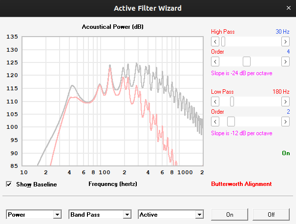

Oh wow, I get it, the second uses the dts style folding scheme. Brilliant. I’ll explore this approach. Thank you!Basic ~32 Hz TH, ~32 Hz DTS

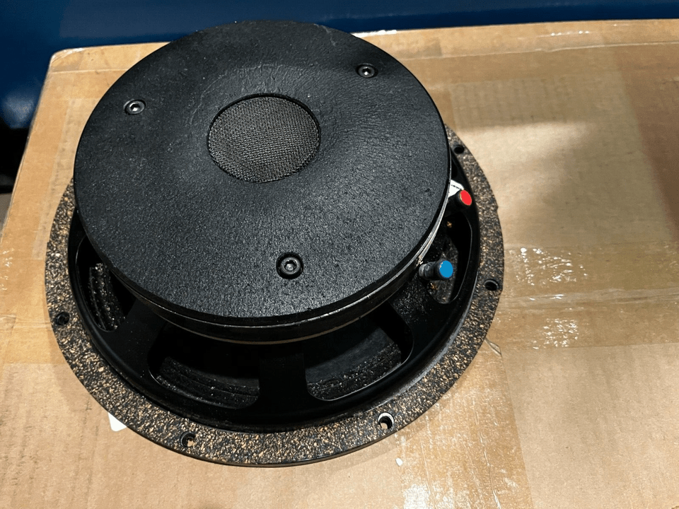

With Black Friday sales at Parts Express, I resisted the temptation to go buy the two PA310's and instead get a DATS V3 to test what I have and use for future projects anyway. I have two very nice prosound woofers similar to a number of prosound woofers used for horns like evm15l / EVm12l:
I figure I measure those for exact specifications and use that to test some concepts with various enclosures as OSB is cheap. That being said, I could at least test two combinations to determine what direction to go:
So - I'll measure these woofers and see what is possible. Thanks for the help everyone!

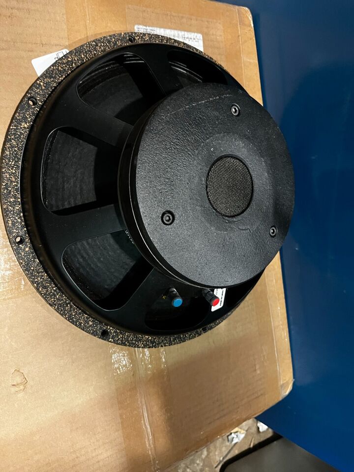

- RENKUS-HEINZ SSL 15-6 - 15" Woofer / (Same as McCauley B1540)
- RENKUS-HEINZ SSL 12-7 - 12" woofer / (Same is McCauley M1220)

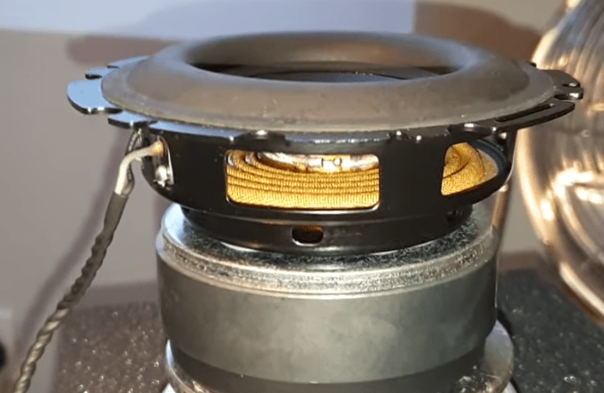

- 4" apple homepod high excursion woofer (maybe a flat an skinny tapped horn, like various exodus anarchy tapped horn designs) It's impressive with regard to excursion! (

Ok Some advice for the DATS. It can be quite the variable piece of test equipment. So give it time to charge up, and do an average of tests with a few minutes in-between.
The design work that Greg did will need to be tweaked to use it with your drivers.
That Apple driver looks interesting. Is quiet. The excursion is about 6mm. A lot less than it appears to have. You need to pay attention to the driver scale and the actual movement on the tinsel leads to the voice coil.
Thanks! I’ve tweaked around with his design, learning more on hornresp. I gather to aim for flat low end while peaks and valley will not be so great in reality. The impedance peaks get really high, not sure if that is going to be of a concern. With the DATS at least I’ll know what I have and see if it works in a sim and give that tapped horn a try for this range first. The 12” I have on hand is quite narrow depth wise. This came off the loudpseaker with the cdt-1 point source mid/tweeter coentrant horn.
With understanding your impedance and T/S parameters you can design or have designed for you an enclosure that will perform as simulated in Hornresp. You can verify that by testing the enclosure with your DATS and then comparing the position of the impedance peaks to the simulation. The magnitude will always be different as Hornresp does not account for any loses in it's simulation. There are always losses mechanically in an enclosure.

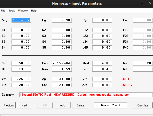

Bought some Renkus-Heinz speakers for the 15" woofers to match the woofer I have now, the 15" McCauley. It turns out it also uses different woofers, the 18Soudn 15w700, which is a good woofer. Troelsgravesen uses it up to 650hz on the Loudspeaker-III kit and he claims this has amazing bass. http://www.troelsgravesen.dk/The-Loudspeaker-III.htm

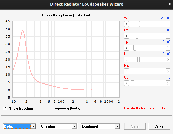

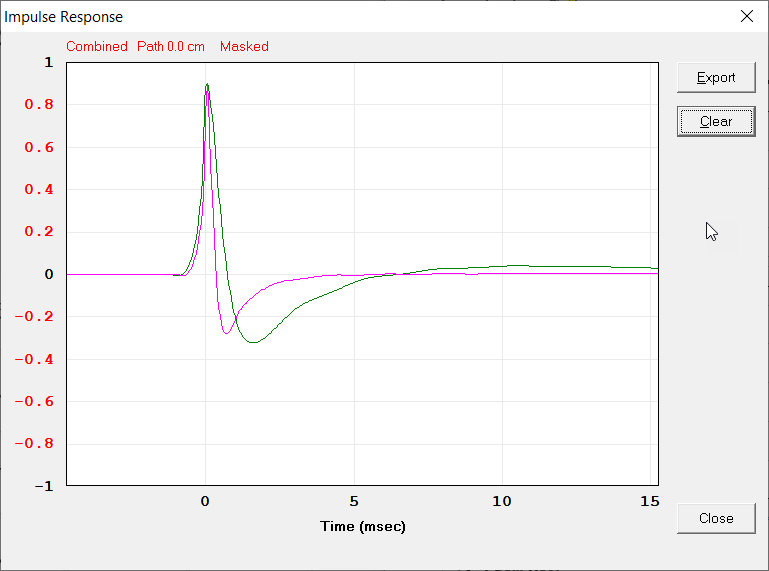

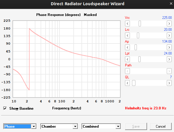

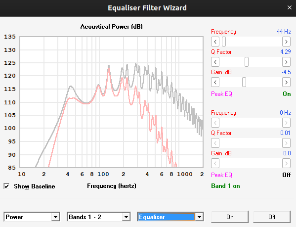

Using his box tuning and 225L enclosure volume gave a good sim in HornResp with very low group delay.

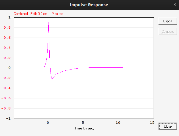

The impulse response is best I have seen for a reflex cabinet:

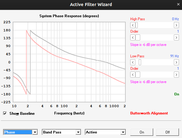

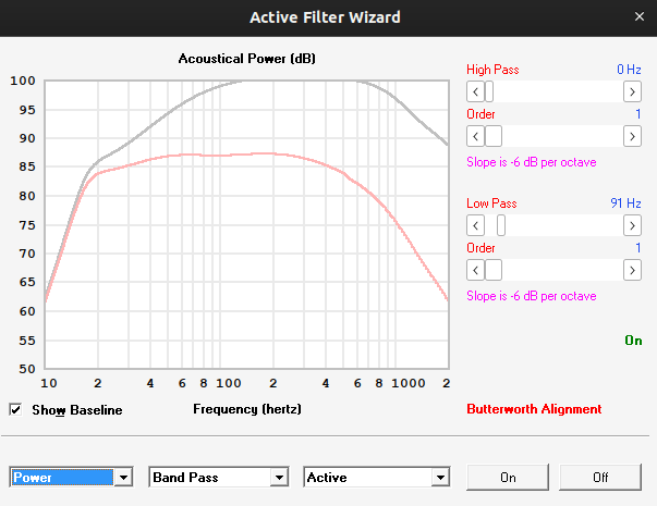

adding an active low pass 1st order filter plus the parameter EQ in middle flattens it out.
Phase it not really affected:

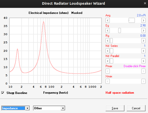

Efficiency is high for bass reflex where it counts too:

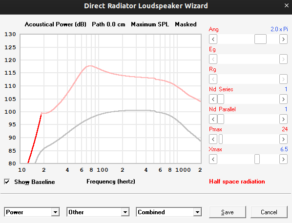

Parts Express is having a clearance sale on the 18" PN470-8 for $149 each + an ADDITIONAL 25% off at checkout. Grand total of $247 for the pair including free shipping. Looks like a really good driver for the $$$.

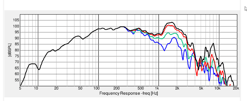

Seems well behaved under 500hz, the 18" cone could match the directivity of the mid-hi horn if I run it to cross at 400hz, has a natural acoustic roll-off at that point.

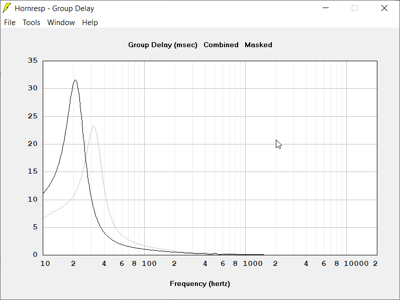

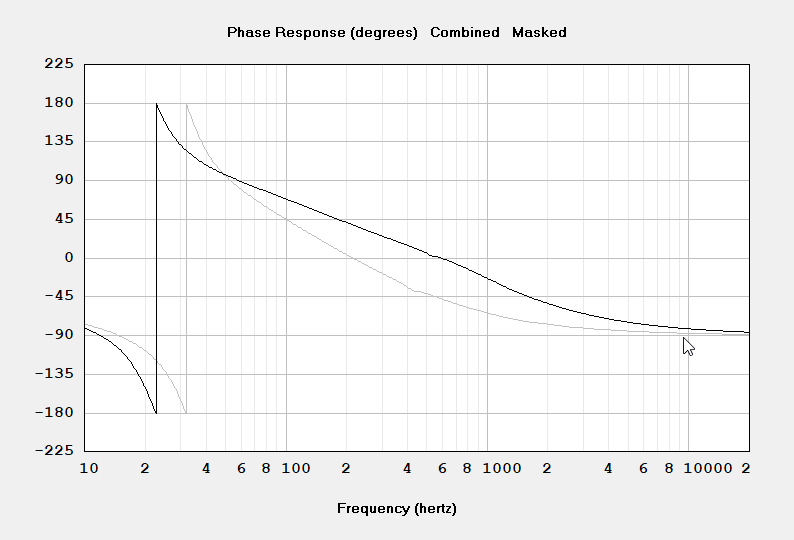

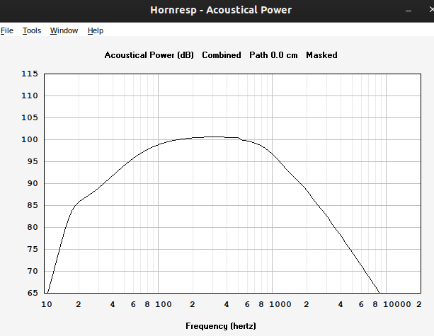

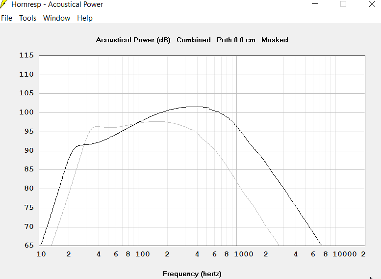

Here's a comparison to the grey (PN470-8) tuned to 33.9 vs 15W700 tuned to 20hz.
Better extension to 30hz by 6db.

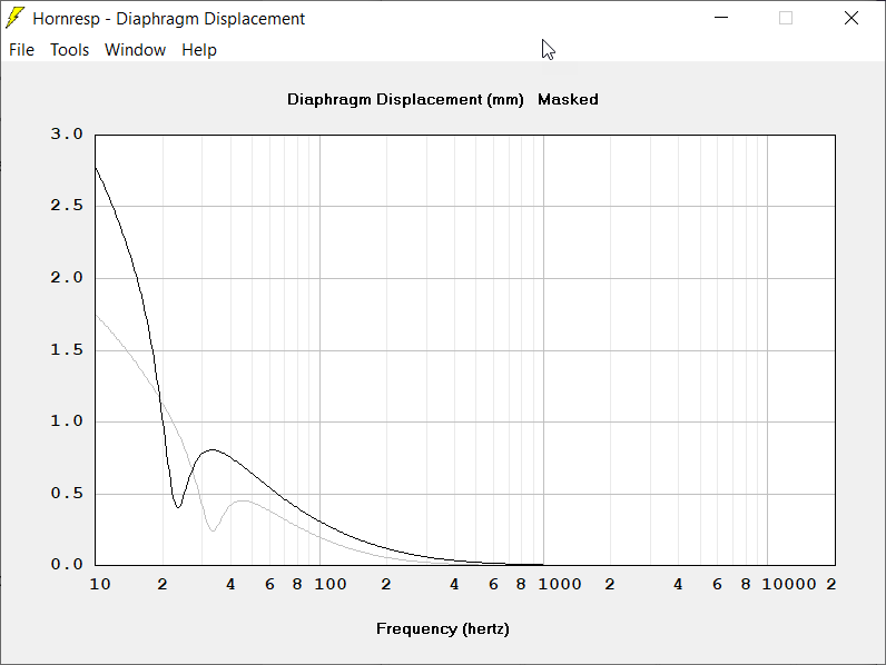

Excursion down by 50%
Phase shifted up a little.
group delay shifted up, but under 23 msec around 32hz, very reasonable performance across the entire band:
impulse is much tighter for PN470-8:

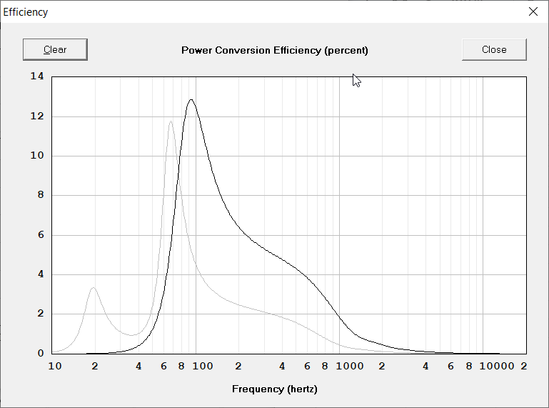

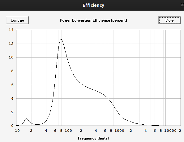

Here's the power conversion efficiency PN470-8 (grey) looks much higher in the 20-80hz range vs the 15W700 vented.
I could take the 15W700 woofer and use it as a midbass in a sealed Q-.5 cabinet (black plot), I get higher efficiency in the 90-500hz plot. I have another prosound 12" driver I may consider as well.
