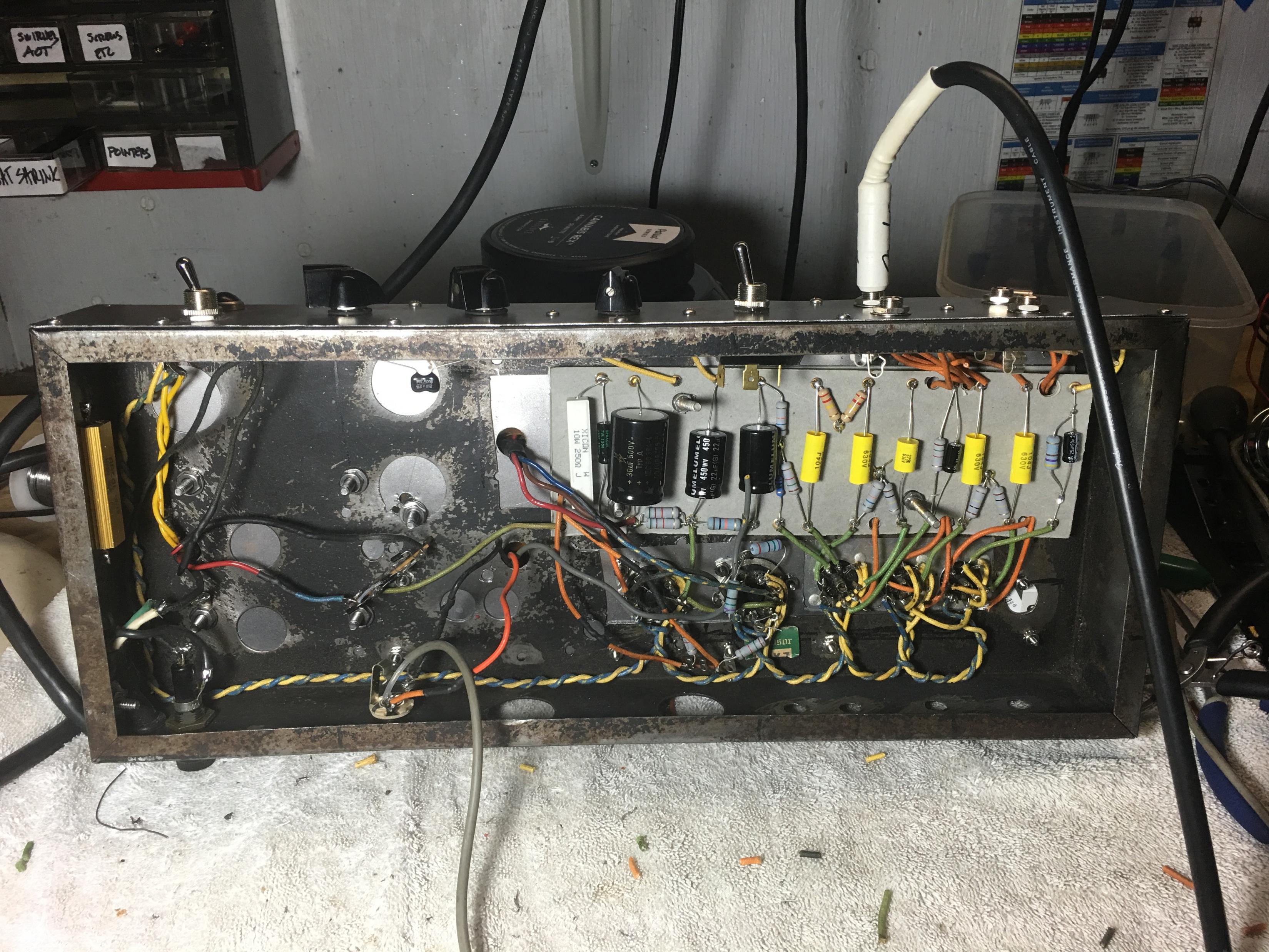

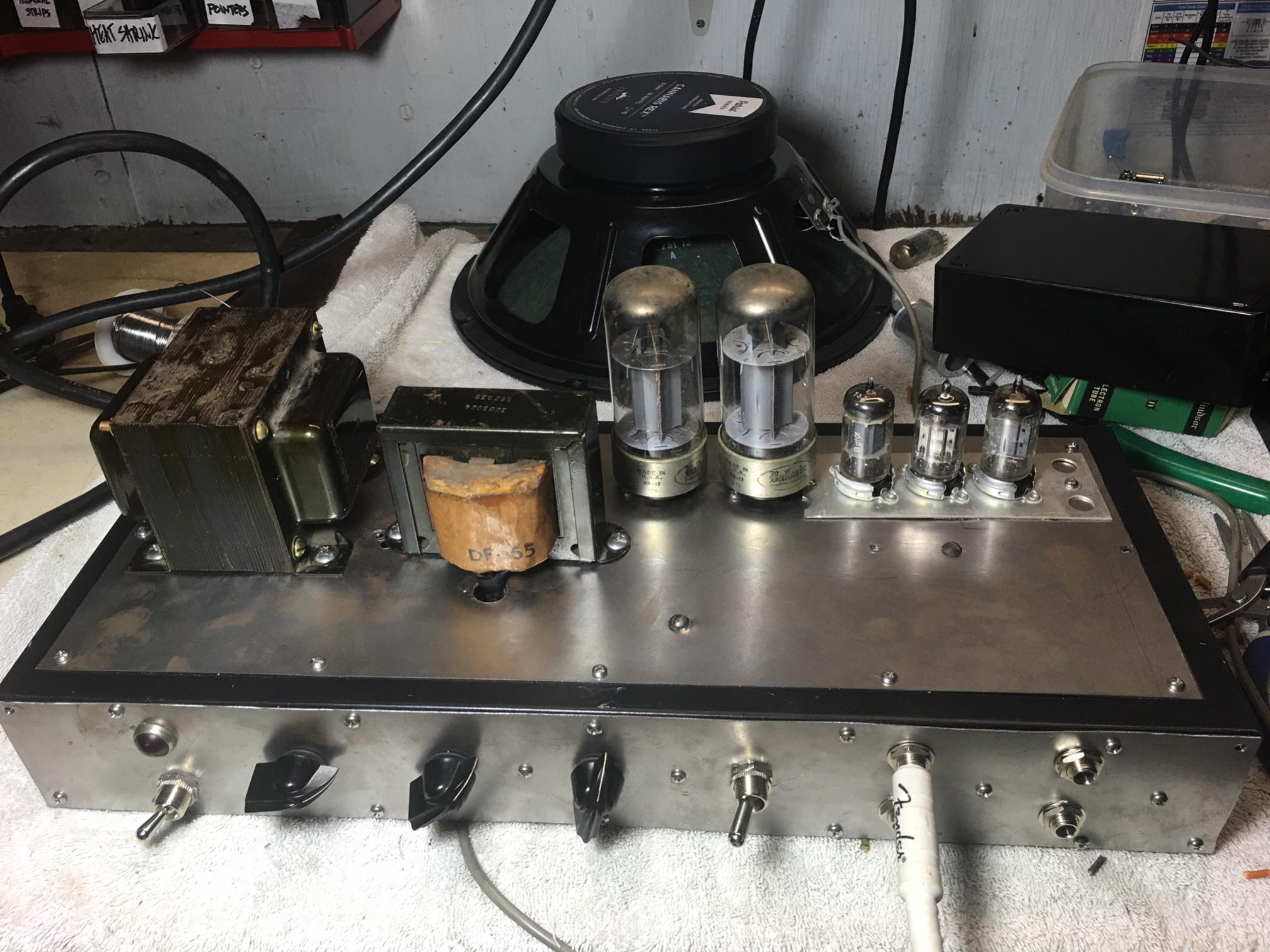

I have hodge podged a Fender 5E5 (the cathode biased pro, not the fixed bias 5E5A pro) using an assortment of parts. I used the power and output transformers from an old Bell PA amplifier that had a destroyed chassis. I built the amp with a solid state full wave bridge as the Bell power transformer also used a solid state rectifier and therefore has no 5V rectifier winding). It's built on an old chassis hulk that I saved and cut a new sheetmetal top and front for.
Anyway, apart from the diode rectifier it's mostly a stock 5E5 circuit. I am getting 449VDC B+ coming out of the rectifier (according to schematic it should be about 395), and the output plates are at about 450VDC. A little high I thought so I swapped out the 6L6GCs for 7027s and tied pins 1&4 and 5&6. These tubes are more robust and should be able to handle higher plate voltage. Cathode voltage is about 29 volts. Doesn't seem too high but I don't know what's spec for the 5E5. The amp is singing, and everything seems to be good.
Still, that B+. My question is, with initial B+ that high, should I adjust any part of the circuit for longevity? Or are there warning signs you could tell me about? Though the amp sounds good and is playing fine I haven't really given it a long soak yet for fear of issues with the high voltage.

High? 450v? MANY MANY commercial amps out there with 500v on the 6L6s and even higher. remember, it is dissipation that kills the tube, not voltage alone.
Your schematic says 395v, but that is with the original transformer. Yours makes 50 more volts. OK so it makes 50 more volts. Your amp runs on 450 now, not a problem.
You mention 29v of bias on the cathode, but not the cathode resistor value. So we have no idea what current flows through the tubes, and thus what dissipation is going on. At 450v on the plate and 30v cathode, we have 420v across the tube. That times cathode current will be roughly the dissipation. (Ignoring screen current)
Just calculate current by Ohm's Law. Whatever the resistance is by the voltage across it. I = V/R So fill in your cathode resistor value.
7027s probably sound nice, but in my view are overkill for this little amp. 6L6s will due fine.
Ah, wait, I just enlarged your photo, it appears you have a 250 ohm cathode resistor. 29v across 250 ohms gets me 116ma, divide by two, and thus 58ma per tube. 58ma times 420v, and I get about 24 watts per tube. That is hotter than I'd like myself, that's 81% in common parlance. Are the plates of your power tubes getting red areas?
Me, I;d shoot for more like 40ma per tube. But 80% isn't a killer, but it will be harder on the tubes than a cooler setting.
You can experiment with other cathode resistors, like 300 ohm or more. We would want a larger amount of bias than 29v.

you have to do the math.
410v across the tube, but we need current too. So I = V/R = 34/400 = .085A = 85ma, or 43ma per tube. So dissipation is 410 x 0.043 = 17 watts. That sounds eminently reasonable to me.
Does it still sound good to you?
In my opinion, that is hot enough bias that you should get good sound, yet cool enough to not overly stress the tubes, and so have good tube life.
