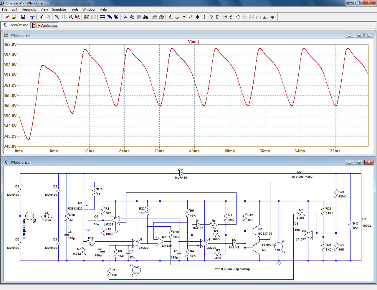

High Voltage Variable Supply on a Shoestring

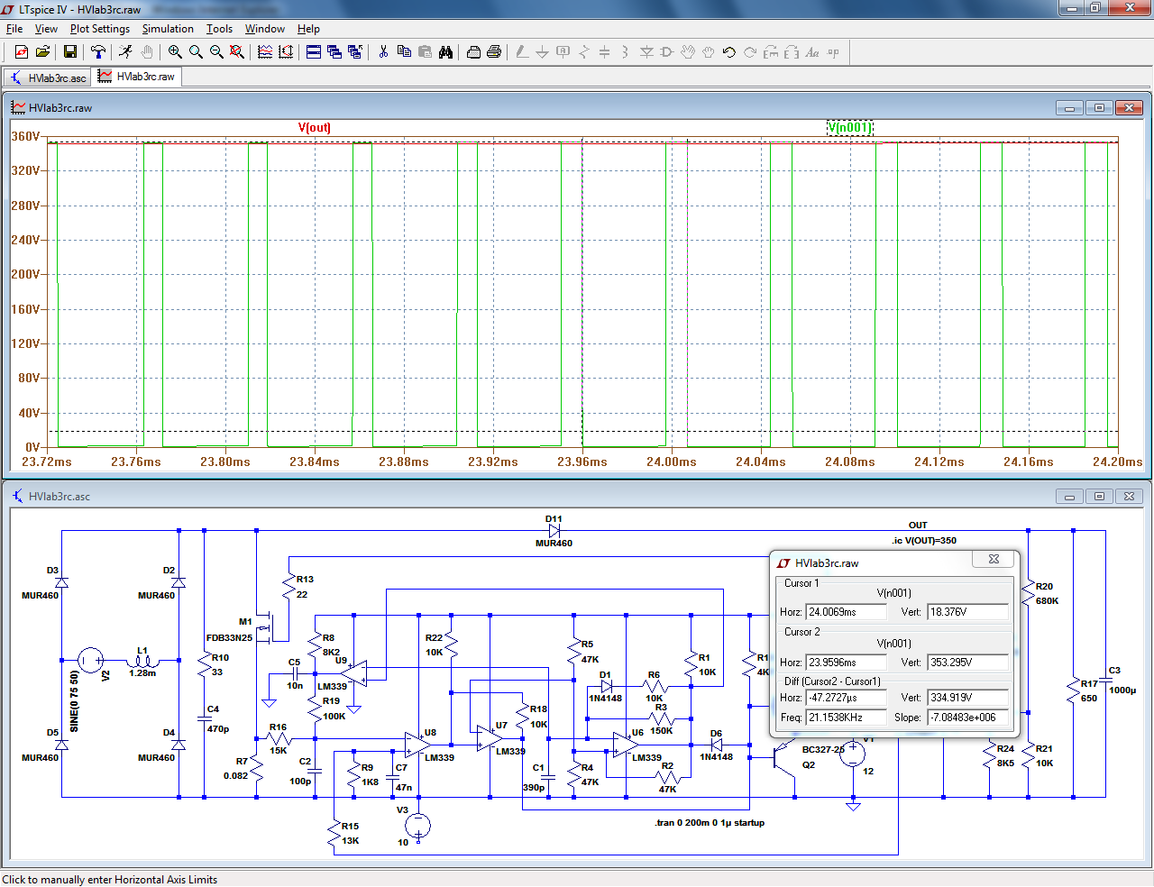

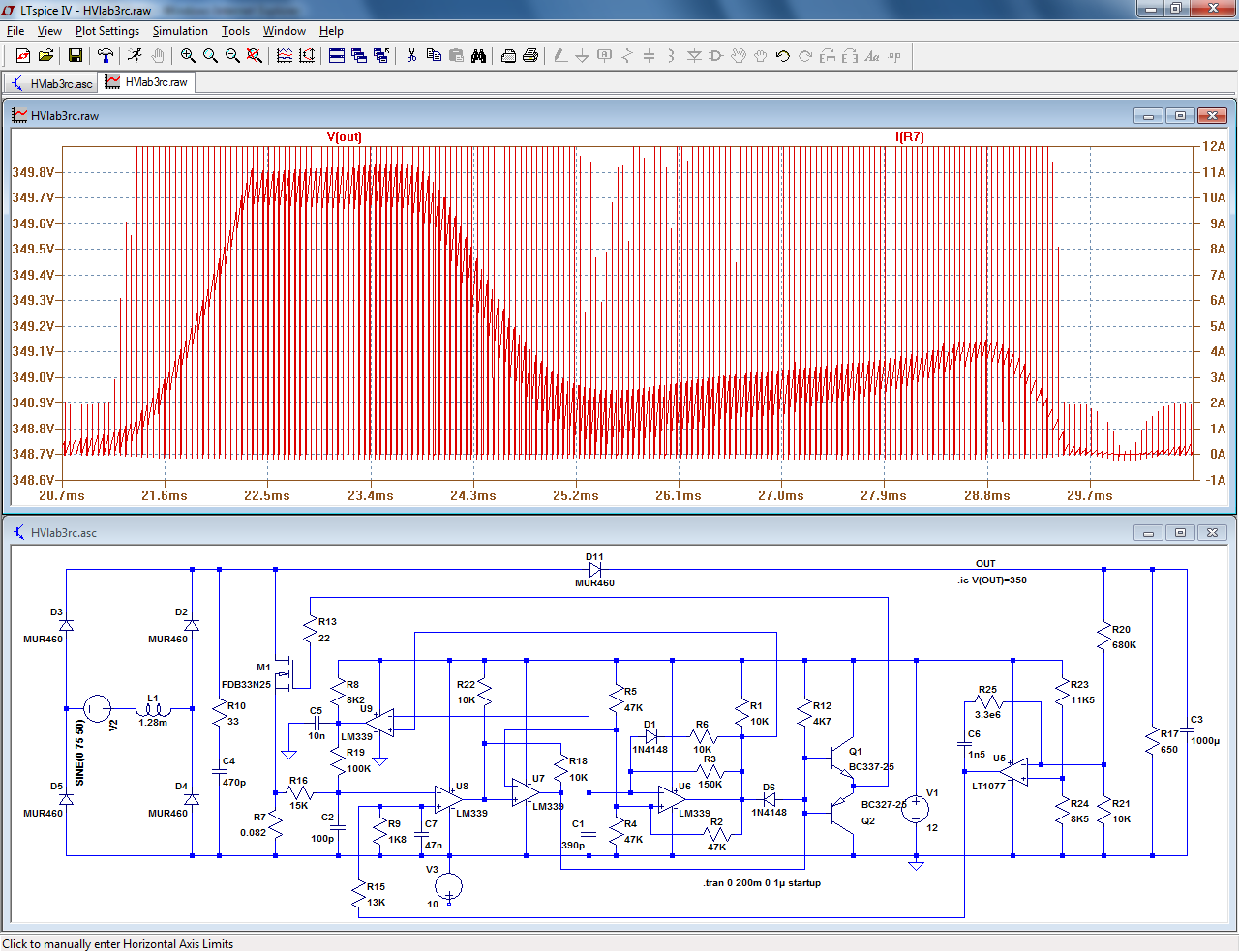

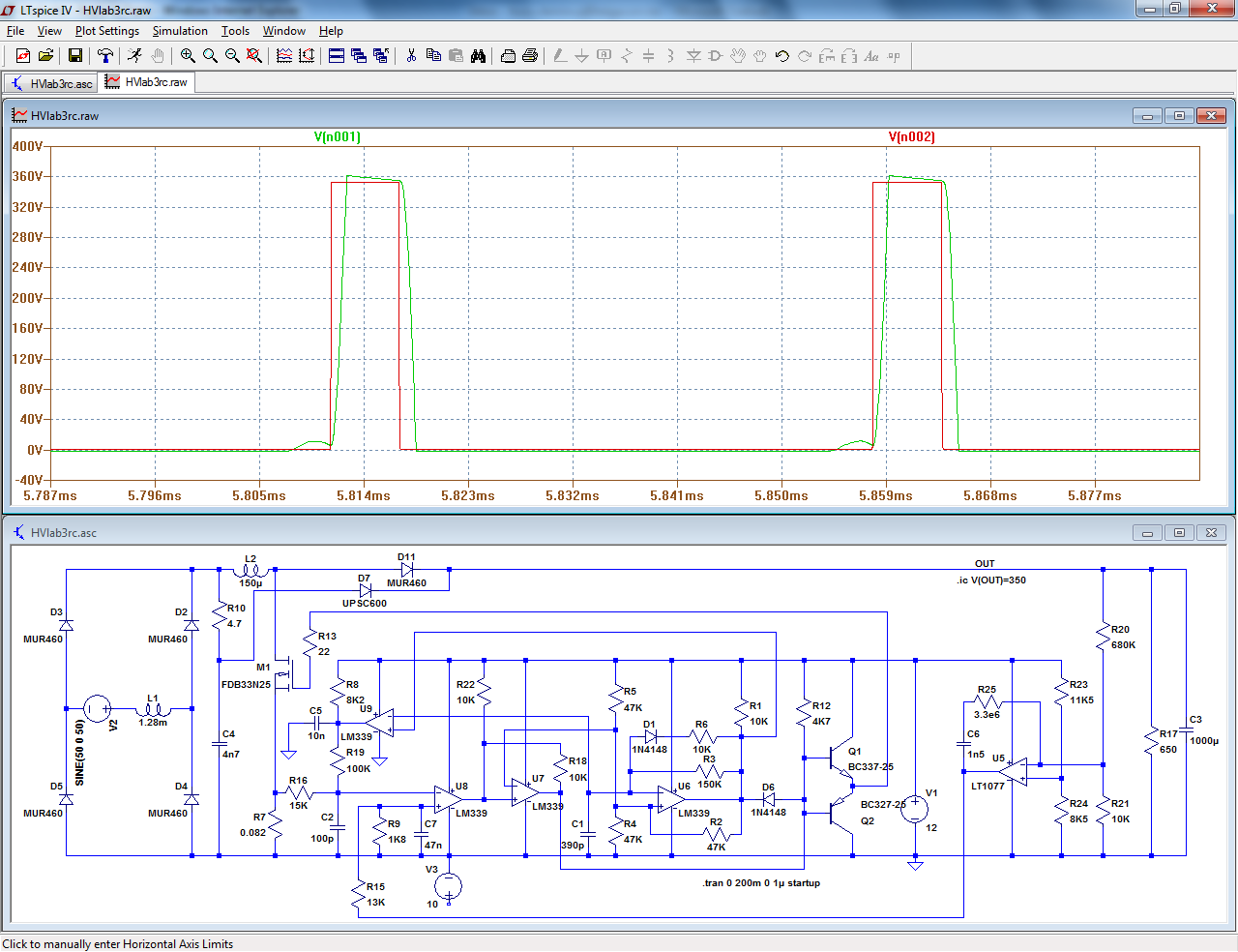

Below is a simulation of the worst case, at the sinewave peaks of 325V chopped by the 4KHz switching frequency.
If the mains has an impedance ~=∞, the fundamental leakage is ~10Vpp.
This looks large, but of course the mains impedance is nowhere near infinity
Why infinity? It's closer to 0. Then you can see that basically all current (divided by turns ratio) goes to the mains. At much higher freq 1 uF can help, but not at 4 kHz.
The 2 states of switching cycle seen by primary in your model should be not 325V and 0V, but 325V and a negative voltage depending on DC output voltage and turns ratio.
Yes, the high impedance fundamental voltage will be about twice as large.
The actual voltage seen on the mains will be lower, but rather unpredictable since the impedance of the mains at these frequencies could be anywhere between a few tenths of an ohm to a few ohm.
