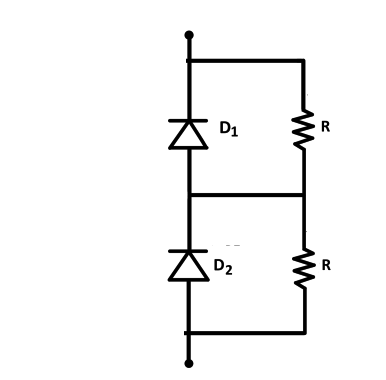

Going back to the original question of this thread, do these diodes in series need equalising resistors? Do we have a difference of opinion here?
Or is the recommendation to use 1200V diodes and forget 2x 600V in series?
600V diodes should be good enough. No series pairs needed. The screenshot shows LTspice analysis. I guessed at the transformer and capacitor parameters in the absence of better information, That mostly affects the diode peak current waveform but the voltage part should be accurate.
andyjevans, perhaps a good idea to read the datasheet for those 600V C3D2060F, especially the max levels for repetitive and continuous forward currents. SiC diodes are poor performers compared to the humble Si diode. They also need other heavy derating for temperature, so heatsinking is likely another practical headache.
Wrt reverse voltage capability and leakage for series connection, then like a Si diode, although there may be static voltage imbalance for the same level of leakage current, the two diodes in series will not see a higher level of leakage current than allowed by the 'worst' diode. So even if mains voltage did push one diode to have to withstand a peak voltage that would normally cause its leakage current to noticeably rise into the knee/avalanche region, the other diode will suppress that rise in leakage current, so no avalanche current level would be reached until both diodes had excessive PIV across each of them. So imho, the huge hassle of adding balancing resistors with acceptable voltage ratings is mute, given suitable derating margins.
There are similar issues with dynamic balancing of voltage across series connected diodes. Although the junction capacitance is higher for these SiC, it is the batch difference in capacitance when inverse voltage is out past 100V, where device capacitance is circa 10pF. It would be a concern if your devices were from different batches/manufacturers, of if you knew that high dV/dt transients were making it through the secondary winding, or you were using choke-input filtering without transient protection. Also note that adding balancing capacitors may be just as much hassle as with resistors, as the Vac rating of the cap needs to be acceptable, and the capacitance tolerance needs to very tight or you go to the effort to match capacitance of all those added parts.
trobbins - thank you! I have not even a fraction of your knowledge of these devices. So am I right in thinking I can leave out the resistors and capacitors in these series resistors? I would want for safety reasons to use 2 diodes in series, as per 6A3sUMMER's advice. The B+ is around 350V and current anything from 20mA to 150mA.

This link goes to discussing the design margins that may be appropriate for diode PIV. P.14 indicates above 280-0-280 is reasonable to go 2x 1kV PIV, so pro-rata for 600V PIV, and double for full-bridge (so say 340Vac).
Even though you may have a low load current, the turn-on surge depends on the first filter capacitance and transformer, which means you should imho still do a PSUD2 type assessment of what happens in first 10ms or a bit longer, and check against diode datasheet limits. Perhaps best to choose a power transformer and measure its winding resistances, and set up a PSUD2 model.
