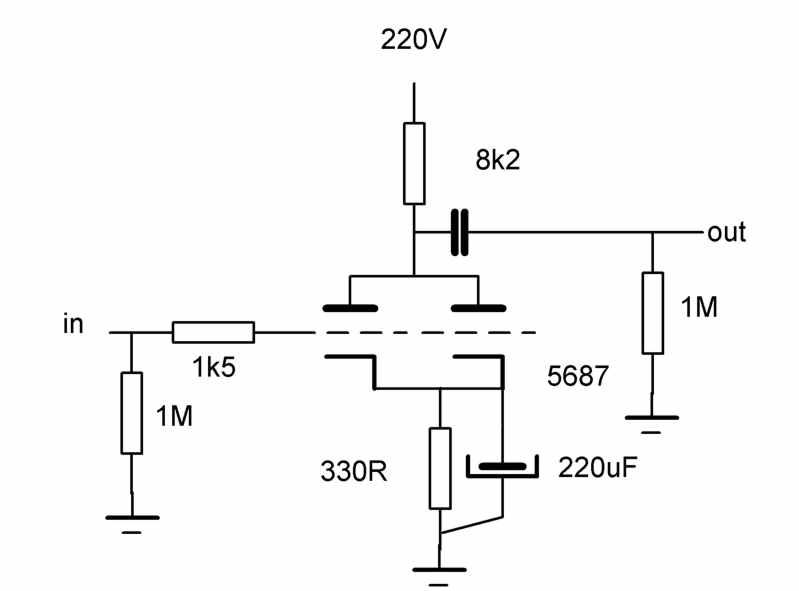

To clear a little bit- attached is the schematic of the preamplifier that needs that regulated power supply- guess I could do that in the first mail of the thread.... Current per ch is 14mA and plate voltage of the tube is 105Vdc. Thanks for Your replies- maybe this will help somebody (fdegrove 🙂 ).
best regards
daniel

li_gangyi said:
isn't that a buffer instead of a pre-amp? okok...a preamp with unity gain...you could really do with a few chokes and some caps...why do u f33l like using SS regulators?? because they are cheaper??
That "buffer" has a gain around 13-14......🙄
I have tried a few chokes and resistors and I would like to try it with some regulators- to see what is happening..😀
