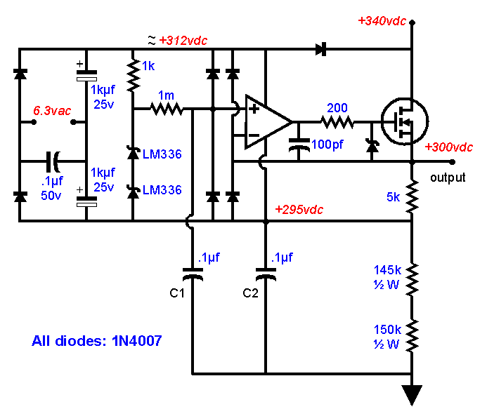

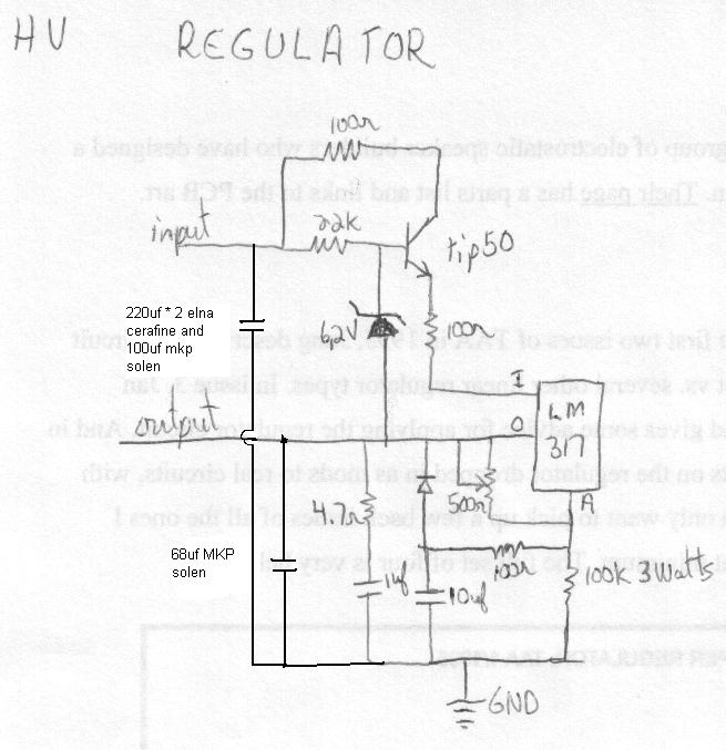

maxpou Member Joined 2006 2006-04-29 8:11 pm #1 2006-04-29 8:11 pm #1 Hi everybody, i have a power amp hybrid no feed back with a SRPP input circuit and 6 output mosfet irf130 and irf 9130 matched. But i think my PS is very bad. Somebody know this PS, it's noisy or good. thank You!!! Attachments hv regulator-1.jpg 51.9 KB · Views: 501 maxpou Member Joined 2006 2006-04-29 8:14 pm #2 2006-04-29 8:14 pm #2 Hi, i would like to know which power supply is best. Attachments floating regulator.gif 11.1 KB · Views: 474 Status Not open for further replies.
