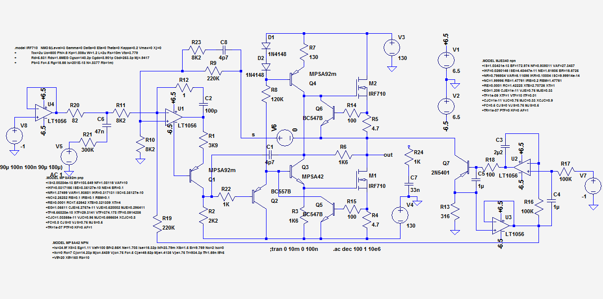

I have developed a number of HV amplifiers and opamps for various purposes.
This one is used in my Early-meter, and is tested and functional:
attachment.php
It uses supplies of only +/-130V, but the concept can be pushed to higher voltages.
Ignore the front section upstream of R11 and the output after (and including) Q7.
It is designed for 100mA max. output, but this can be upgraded too. It is protected with a current limiter.
The limiting factor would be the Vceo of the MPSA transistors.
You could still get a 325V peak output with +/-200V supplies and a H-bridge configuration.

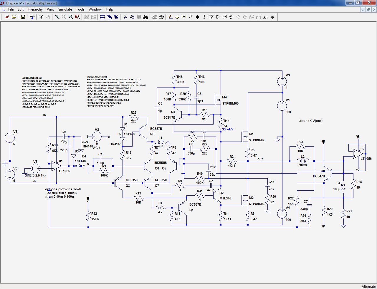

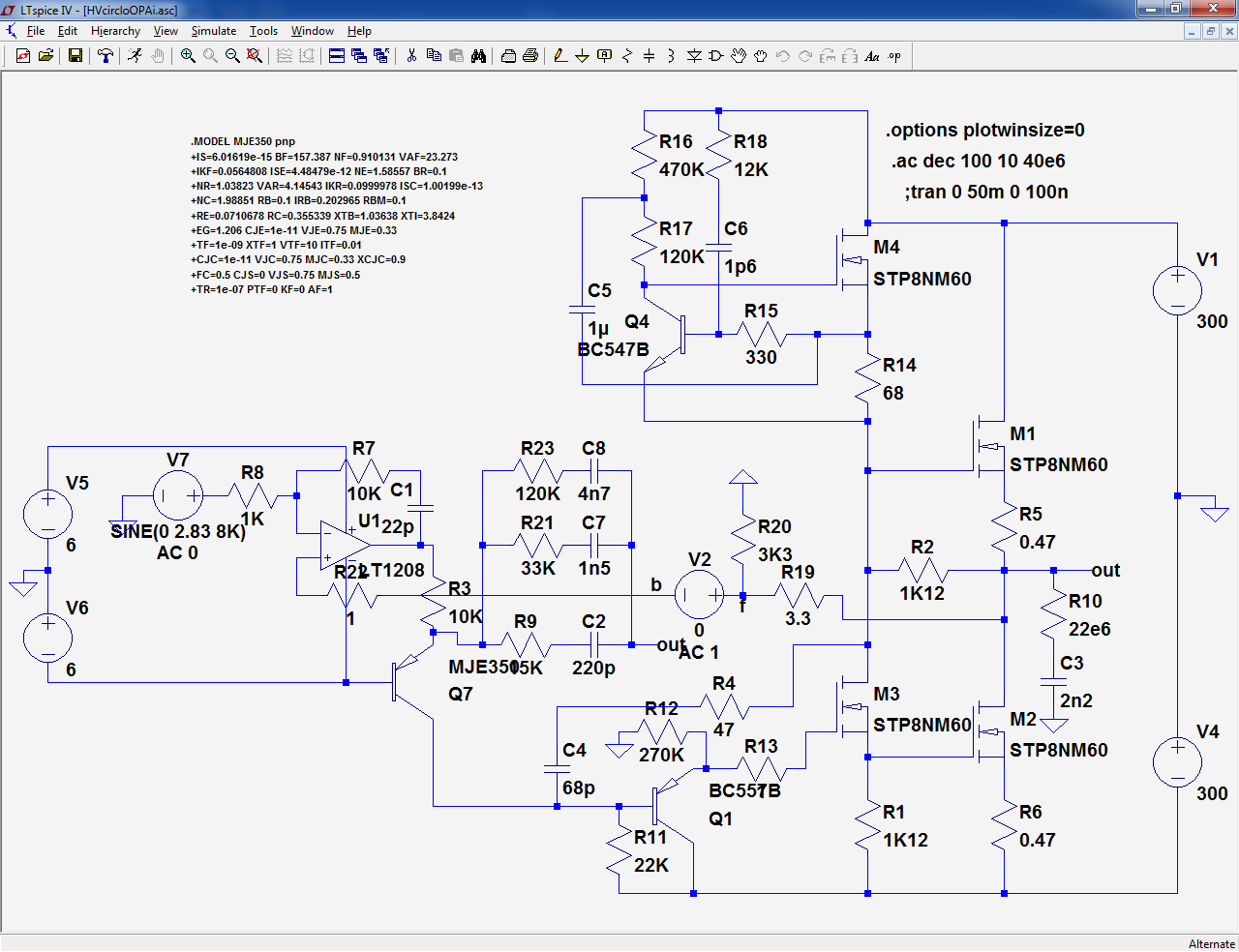

Alternatively, you could use NMOS transistors for the CCS and the VAS, as in these examples:
attachment.php
attachment.php
They have been designed for a transformer tester, but they have not been completely built and tested.
They should be workable though.
Q2 needs to have a 800V Vceo. I used the MJE340 in the sim because I had the model, but I didn't have the model of the 2SCxyz that should be used.
In the full MOS version, M3 and M4 can be low-power types.
These circuits are designed for 1A output, but they could be upgraded for higher currents.
  • 2opaCCsBipFin.asc
    2opaCCsBipFin.asc
  • HVcircloOPAi.asc
    HVcircloOPAi.asc
  • Final.asc
    Final.asc
