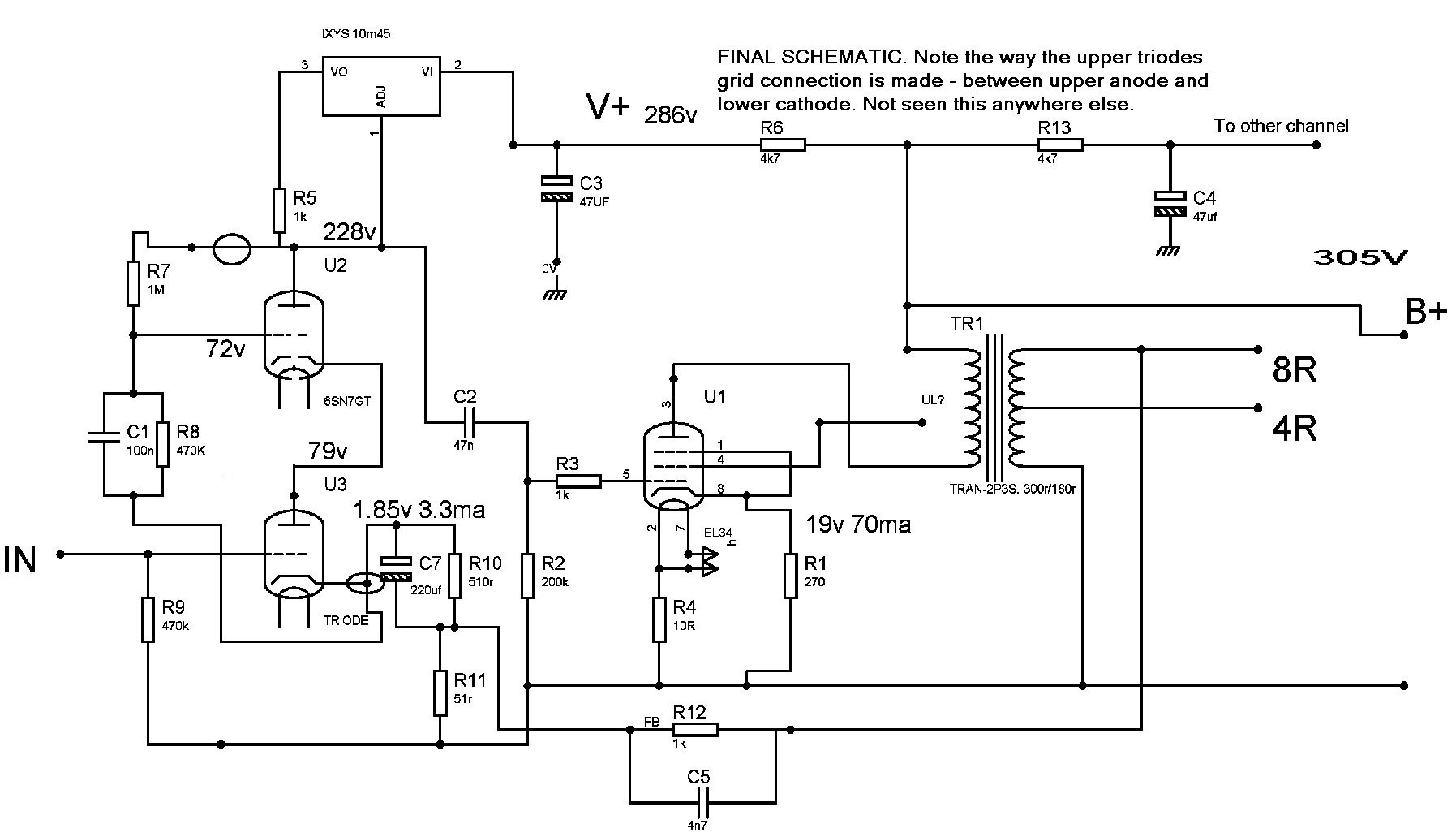

My amp has been modified to remove the 6SN7s and the VAS mounted in a separate chassis at present (using an Akido) so there is no global NFB.
I will leave it like this for now and maybe then install the opamp in the EL34 chassis supplied from the HT via a Zener stabilised supply. I can then experiment with NFB to see which my ears prefer.

Yes, I wasn't expecting too much but I various mods and ended up with a respectable amp. This was the final scematic before I swapped to an Aikido. (The UL tap is connected not as shown) Also the anode of U2 only connects to cathode of U3 not as shown.

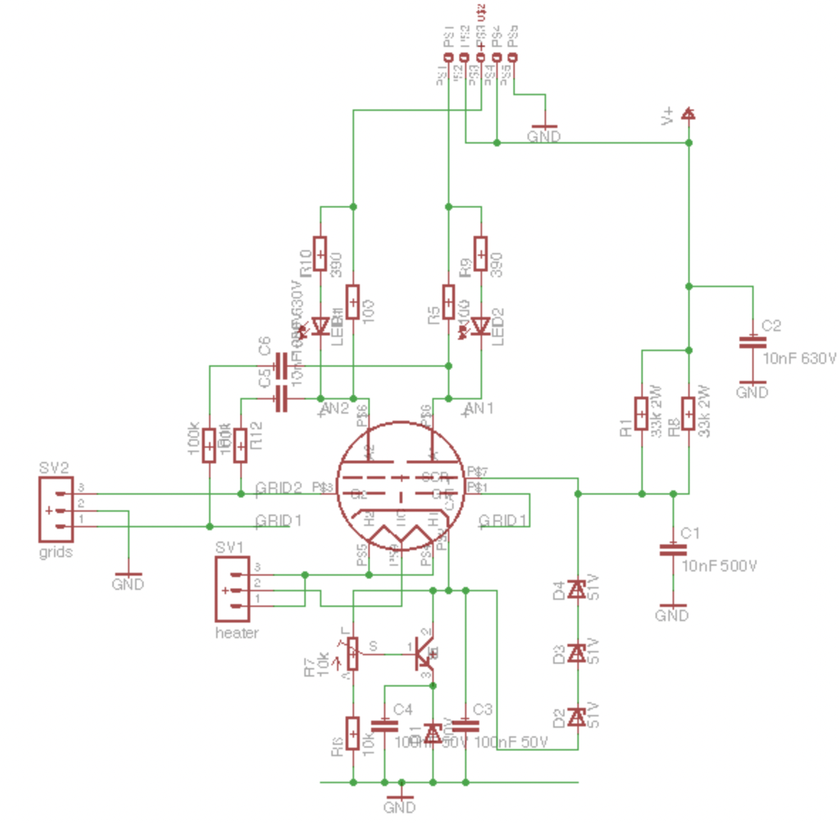

My approach was use an inverter to step up the power supply just for the valves, and a DC-DC converter generating +/-15V for the opamps, with high gain tetrode (actually an RF dual tetrode, QQV3-10) as the power valve.
Power section, with differential input, this feeds a small OT:

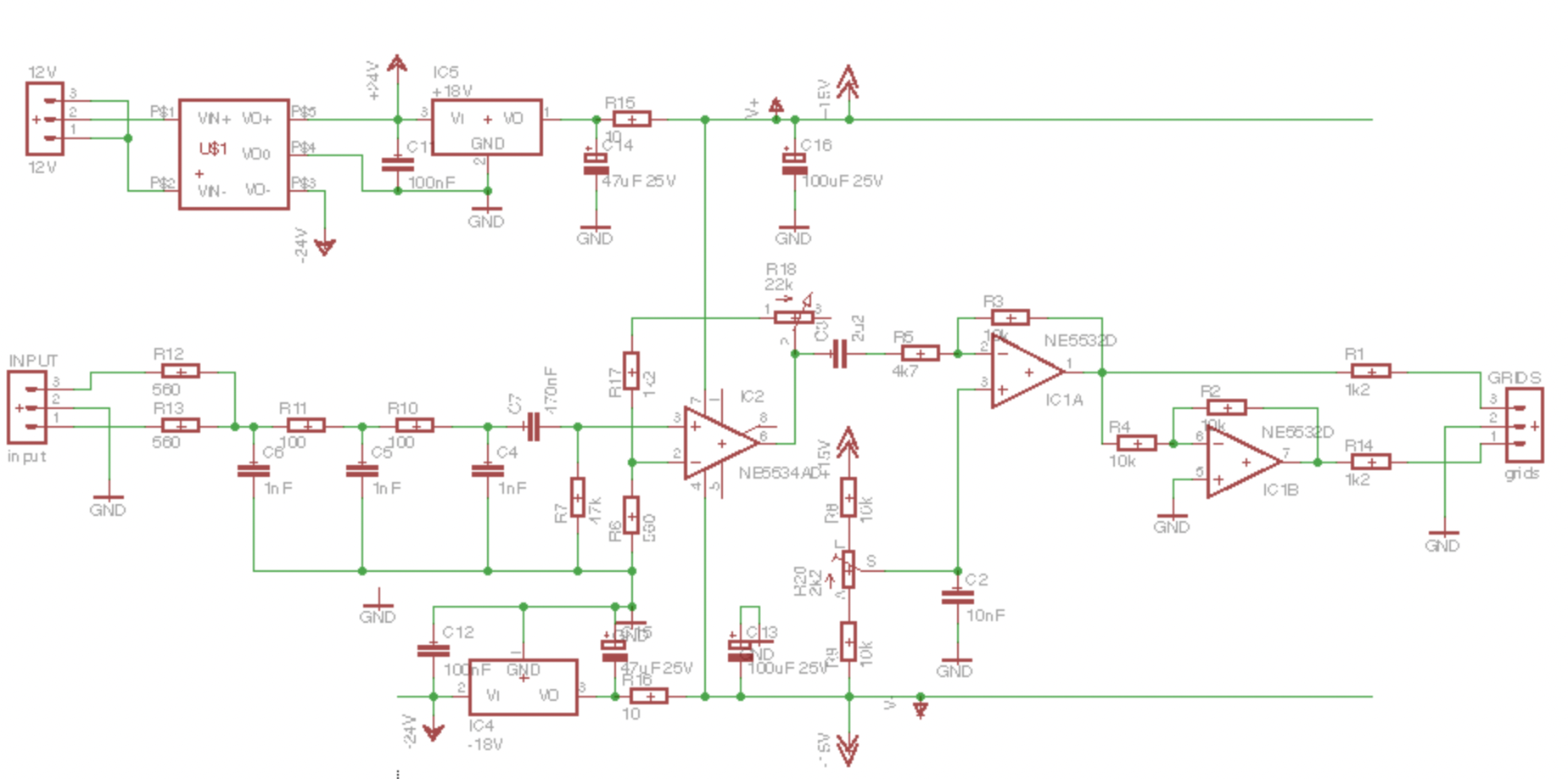

The input section, input network with RFI filter, gain stage, feeding an adjustable offset buffer and an inverter to generate something like 16V rms differential output to drive the QQV3-10.

The whole unit driven from 12V battery or mains PSU - its s toy guitar-amp style amp (but too low input impedance for a real guitar, just a vanity piece really).
The lack of mains transformer solves the hum issue, only 10nF caps needed to decouple the HT...
The two LEDs in the anode circuits allow visual indication of offset + bias adjustment, tune for same brightness for offset, just starting to illuminate for bias!
