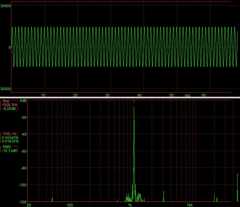

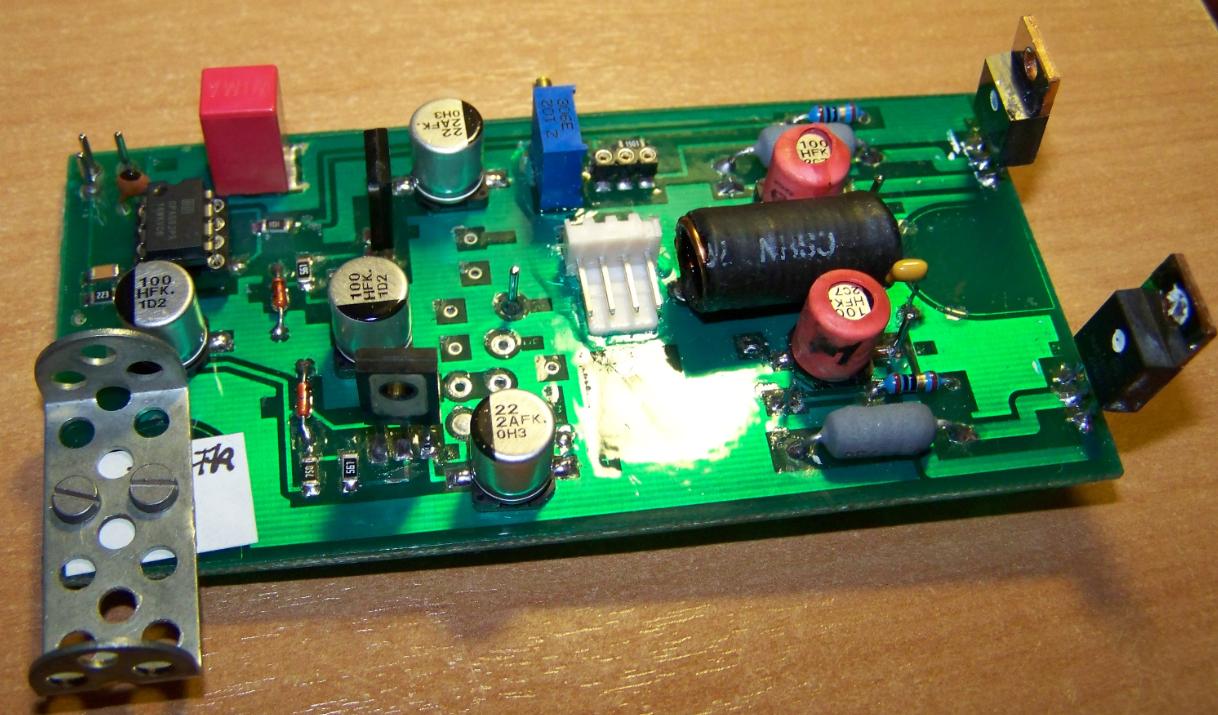

Attached is a distortion measurement of my circuit with no load. A Xonar DX soundcard and Wavespectra was used for recording. With 8R load connected, distortion quickly rises to >0.01% tough. Maybe paralleling several output T's would help here as it reduces current variations. Is it worth the trouble to try and match the output T's?
Actually I was supised to see how well the real circuit correlates to the simulation. The only thing where Spice is always far off is the distortion. This is probably because a.) it assumes ideal components with identical characteristics and b.) no parasitics are simulated such as stray inductance on the PCB.

Try a 4R load and if the distortion rises a lot then adding more on the output may help and may make it worse depending on if you have enough current to drive them. Matching is a good idea.

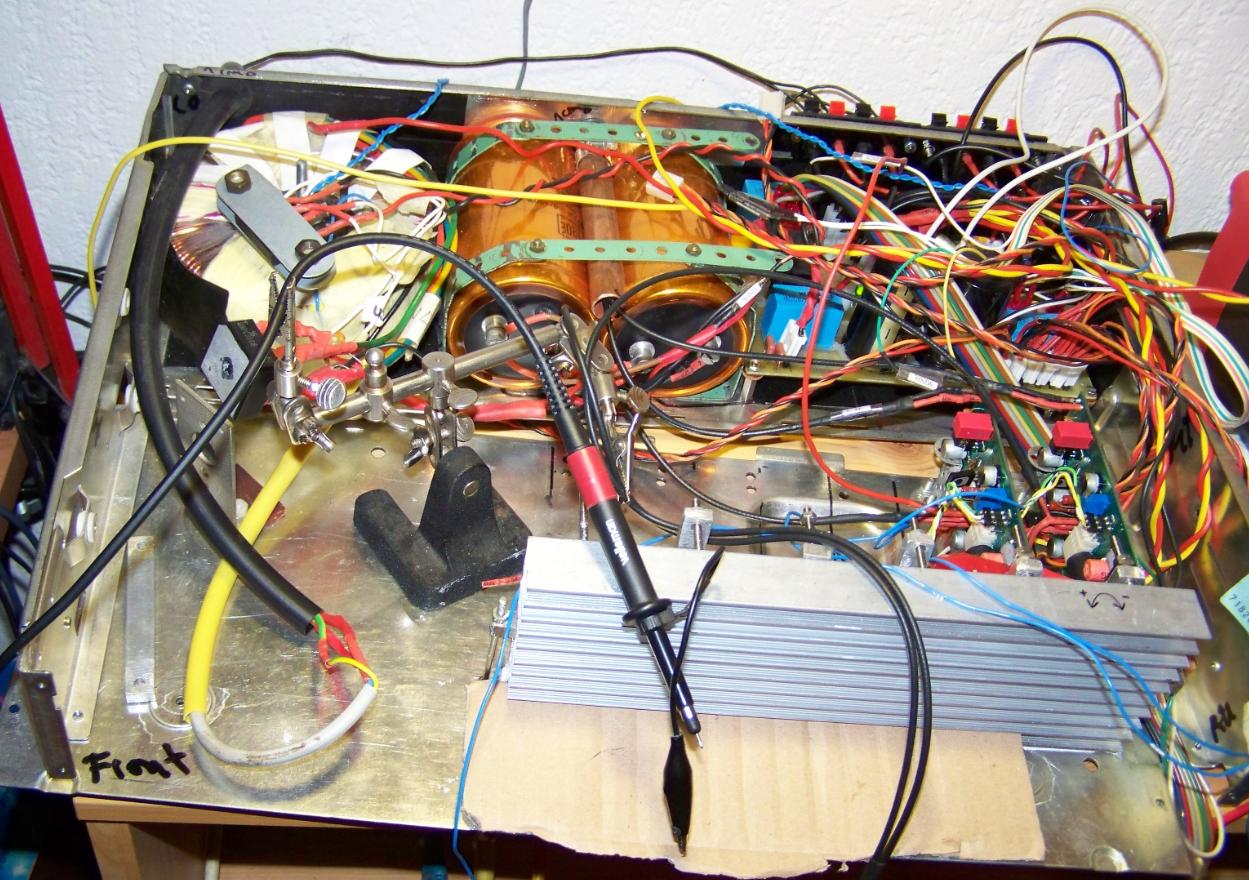

Just a little update, the amplifier is up and running now, so far I have installed three channels. This is going to be a 5.1 amplifier for my PC (mostly for gaming purpose). Theres a switch-controlled relay on each PCB to toggle between speaker and headphones output.
So far it works well, bias current is stable once the amplifier is warm.

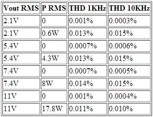

Also attached is the THD measurement results.
Obviously the output stage is the limiting factor here.

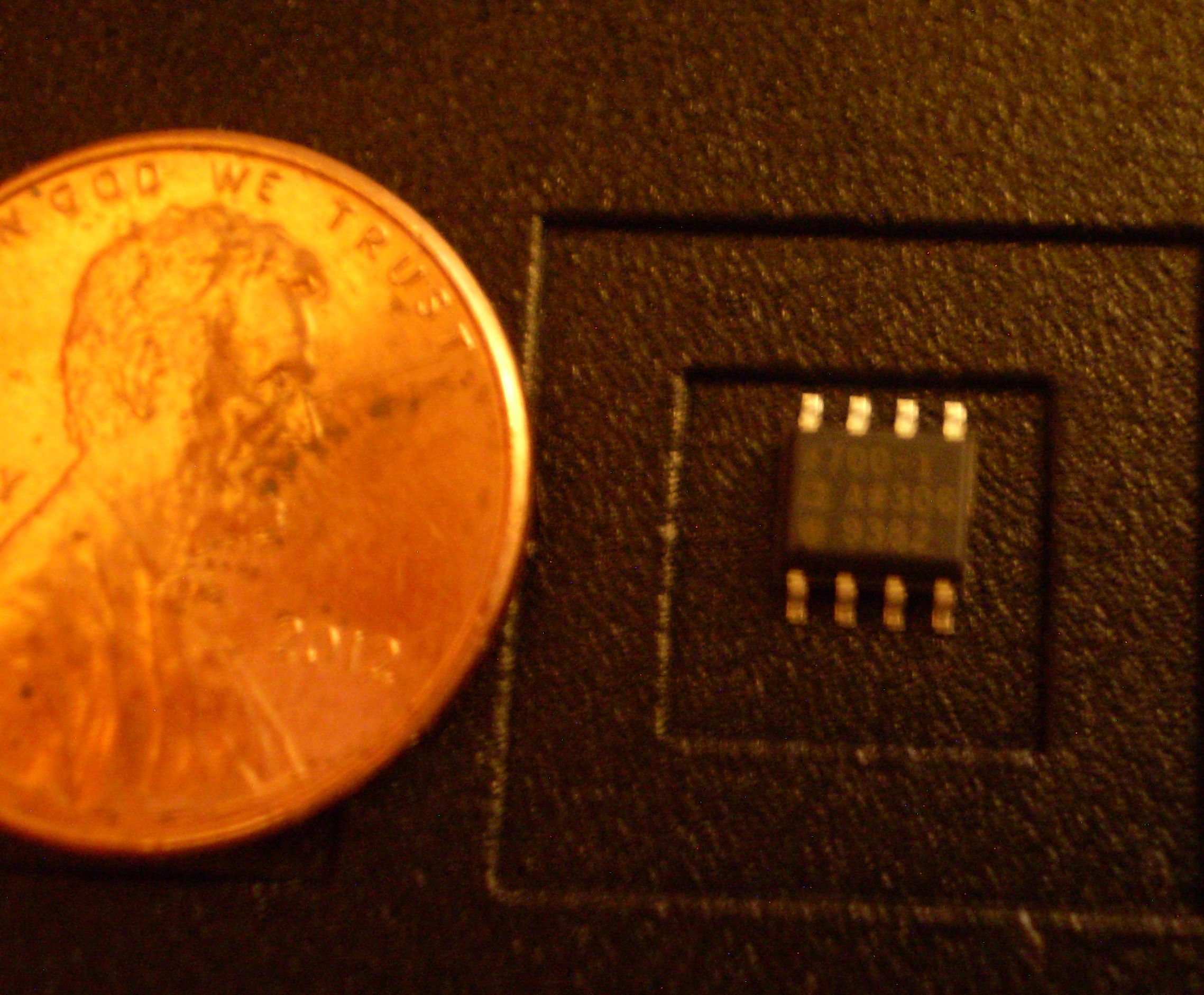

I just received two of the ADA4700-1's today!!! 🙂
It will be a while before I get to testing them as I have few other projects that I must finish up first.
When I do I will certainty post my results here.
They are in a a SOIC package and that is not so bad to work with and with a fine tipped iron you could solder some 30ga. wire wrap wire pigtails to the chip if you had to.

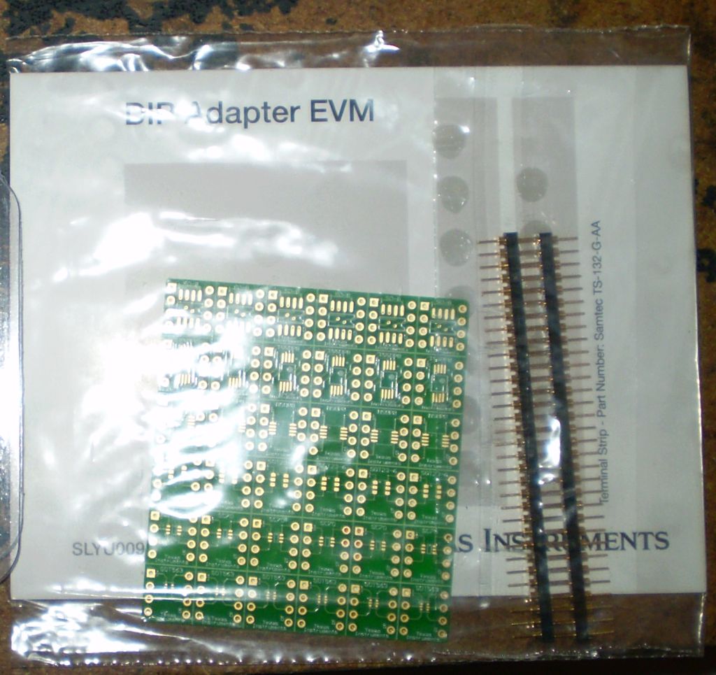

TI makes I great little adapter kit for $10 that allows you adapt 6 different package styles to 8-DIP.
It can be found here,
DIP Adapter Evaluation Module - DIP-ADAPTER-EVM - TI Tool Folder
It is a very quality board as expected from TI and comes with with gold plated pins and pads as well!!
It is a much cheaper alternative compared to some of the other adapters I have seen even if you only use the 6 X SOIC-8 partitions from the board.

Many thanks Gerald for the heads up on this adapter - I have just ordered a couple from TI. Excellent value for the money with shipping included in the item price and will solve so many prototype and DIY challenges.
