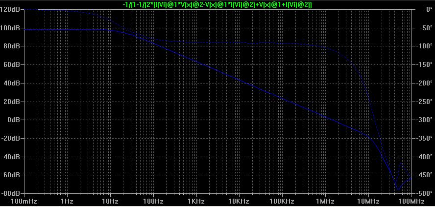

How would I go about simulating loop gain of the *CFP stage alone*? Can I use Middlebrook methode also?

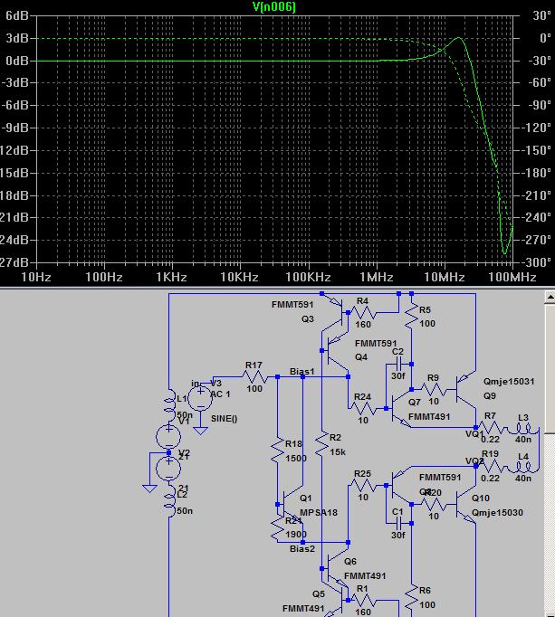

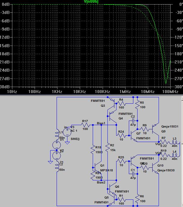

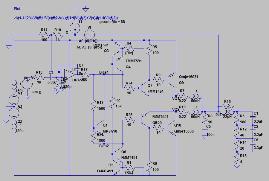

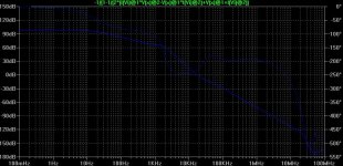

This morning I experimented with 10R base stoppers in my PCB test platform (ie no breadboard weirdness), and they did absolutely nothing to stem the oscillations of the compound pair under load and driven close to the rails from the op-amp and without any global feedback. However placing a 1/10 resistor in series at the output of the op-amp (R9/R10) helped reduce the oscillations visibly, albeit with a small voltage loss at the load. In the end it is only the caps C6/C7 that stop the oscillations completely. There are no oscillations under no load and the test load is purely resistive. To drive an inductive load I have used a 1R/18nF Zobel at the output (not shown on schematic).
I attach a very simplified schematic.
The first pic shows the loop gain plot; phase margin is 70° with 40nH series inductance on the emitter resistors. The second plot shows the same circuit with 10mH inductance. So we can see that inductance is a possible source of instability, but this is very unlikely to happen with reasonably sized wirewound emitter resistors. If in doubt, 1R carbon resistors can be placed in parallel.
With 2pF compensation for the op-amp, phase margin is improved to 80°.
GBW of the OPA552 is 12MHz and fT of the MJE15028/30 is 30MHz. Driver fT is 150MHz. The output stage has a gain bandwidth of around 28MHz but shows a nasty peaking in gain at 15MHz (3rd pic). Adding 47pF between driver B-C gets rid of this anomaly and limits bandwidth to 12.5MHz (4th pic). So it can't hurt to use these caps and also a small compensation cap (~2pF) to slow down the op-amp a little.

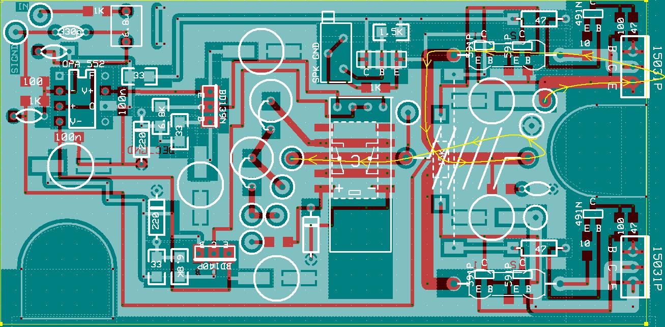

I've also attached a PCB layout for this circuit (4,2x2,1 inch for a single channel) using mostly wired parts and some 1206 SMD resistors and electrolytics. The FMMT491 transistor is only available as SOT23 AFAIK. There's bypassing for the output stage and op-amp, and also each channel gets a simple zener+emitter follower "regulator" for a clean supply voltage. There's a NAiS TQ2SA-5V relais to switch between speaker and HP output. I plan on using this for a 5.1 amplifier for my PC; it would also allow for 5.1 headphones.

The source of my oscillations was simply a wiring error on the breadboard. It simply wasn't the circuit shown in post #1. I didn't observe any oscillations since correcting the wiring.

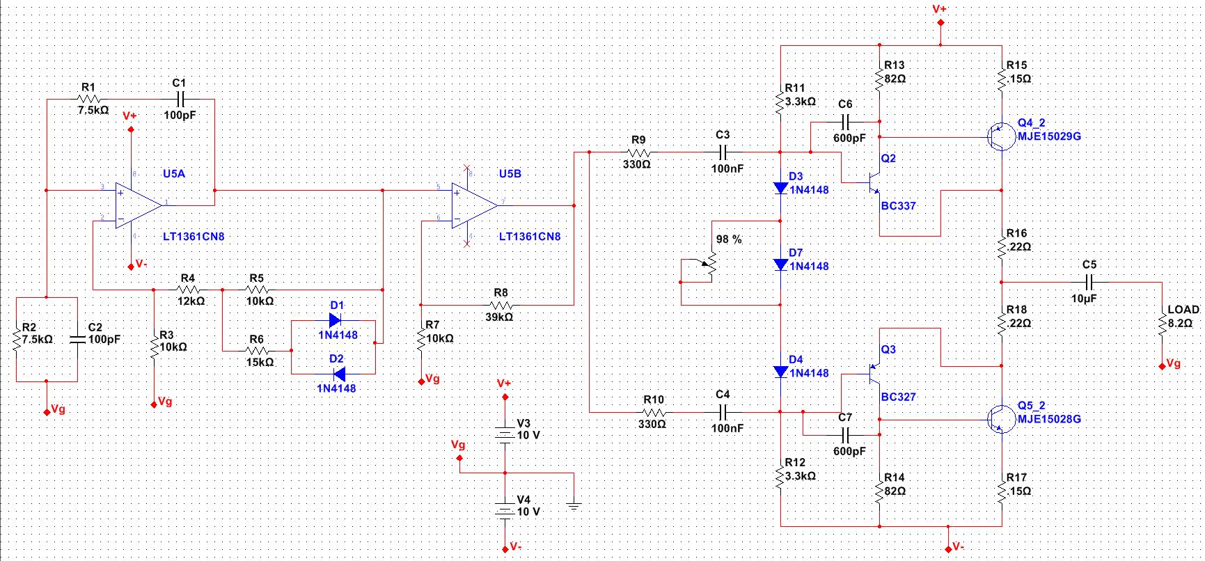

Weird way of doing things and I can image distortion being high?
Why weird?
I do not have the rig to measure distortion, I just look at the curve on the scope and am happy when it looks clean and when the output shape on load matches the input shape. I cannot simulate it either - none of the oscillations were evident on the simulator. many designs look perfect in simulation when in fact they suffer from temperature instability, oscillations, variation of components values etc.
@akis
I also don't understand your circuit. What is the purpose of the first op-amp?
What is C3/C4 needed for? The bias spreader already puts the required VBE between the transistor bases, so there is no need to AC couple a signal to both of them. Also the feedback loop is not around the output stage which increases distortion (unless the output stage is very linear at first).

My circuit is similar to yours in that there is a push pull with compound pairs and unwanted oscillations. That is where the similarity ends I think.
Why weird?
You can't see millivolts on top of volts on a scope so you can't see the distortion, it's very hard. There's no point in C3, C4 and R10 there should be global closed feedback to minimize distortion perhaps use one BD139 instead of three diodes? It makes for easier mounting and overall simplifies the circuit. You can at least simulate distortion in multisim as well as use frequency gens so you don't need to make them. Yes simulation is way off real life but it can give use proof of concept.
