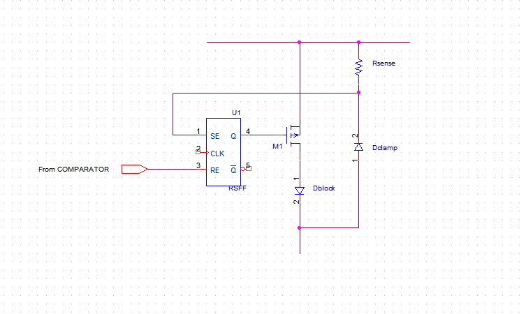

Chocoholic, do you believe that a Zero-Voltage switching design would be unconditionally reliable even without faster diodes?
There is always a chance that the system might be forced out of the soft switching mode. Disturbances, or during start, or with catastrophic input signals, or load dump, or load shorts.
In designs, which would just generate some more heat in this case there would be no reason to add the diodes.
BUT here with these unsaint high voltage devices, such an operating mode has a high chance to become lethal. I would not dare to keep out the diodes in this application.

Is there a reason why you would put the series diode in the source leg?
I would tend to put it in the drain leg, where it doesn't influence the gate drive loop.
BTW: Probably you will need a real driver or at least two BJTs to drive the switch.
It's in the drain of a p-MOSFET. 😕 . But the whole circuit... I don't know what it is supposed to be. Smoke generator?

The conceptual schematic does not include any details about the actual implementation. Obviously I'm not planning to use an integrated flip-flop. In fact I feel this is going to be the hardest part to design, because even if it has to behave as a conventional S/R, it requires high output current capability and a very well defined 0 to 1 transition voltage at the set input, as the difference between the current leaking trough the diode's parasitic capacitance and the diode forward current is going to be small. Insensitivity to dV/dt and a reasonable speed (I think 250 nanoseconds of propagation delay would be fine, so it needs not be the fastest digital circuit ever) are also a must.
The problem lies not only in the design itself but also in getting it done in a simple, easy to layout way.
To protect against bad loads my idea is to route part of the output current to ground by an inductor. This should make some of the ripple current independent from the load, which is important to avoid excessive ripple voltage at the output, since load capacitance is only an order of magnitude above parasitic capacitance. Protection against shorts is inherent in the circuit (edited: maybe not, but I would implement it in the form of duty cycle limiting and not in the output stage, which I think should be as simple as possible), protection against open circuits would be provided by this inductor, and the flip-flop design warrants the circuit would stall in case of almost any failure condition I can imagine. This would be solved by resetting the circuit, either powering it down or pressing a dedicated button.
A circuit firing one of the flip-flops at startup is needed but it's my least concern right now. The loses during this first shot are going to be big in terms of power but tiny in terms of energy, as the small 50 pF parasitic capacitance needs to be filled to 1kV through the transistors only once.
..oohps. p-chanel? - Yes, obviously p-chanel. Sorry, I was blind.
The final design will use n-channel mosfets, but this one is just for testing the concept in spice and a complementary design is easier to debug.
Hm, if we guess that the gnd of the flip flop is connected to the source of the p-chanel, we can be sure that the Mosfet is always OFF.
The output of the flip flop can only deliver gate signals with the polarity which keeps the MosFet OFF. Strange.

Nobody except you seems to understand the intension of your circuit.
Any hint?

Don't think of the flip flop as TTL level (0 = 0V 1=+5V) digital device but as one whose output voltages have been choosen so 1 equals the voltage needed to turn on the mosfet and 0 the voltage needed to turn it off. It would be something like 0 = 0V and 1 = -7V. The one and zero voltages at the set pin wouldn't be "TTL standard" either, but this does not make the block stop being a flip-flop.
...still don't get your intension...
What is your plan to do with the clock input?
It would be great if you could describe, which event shall trigger the flip flop to show 1 (MosFet ON), which event shall trigger the flip flop to show 0 (MosFet OFF) and how long these states shall last.
