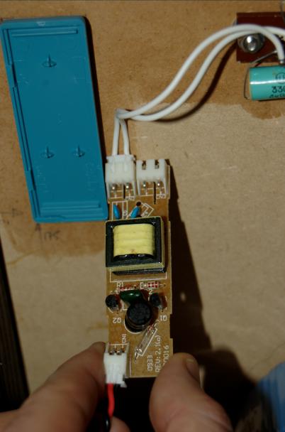

Mine give about 1100V RMS. They have a little series capacitor at the output, as a rudimentary current limiter I suppose; if I remove that, I get even higher voltages. Exactly how much, I can't measure anymore without a HV probe.
Because the frequency is so high, one could easily make a multiplier ladder with many stages, and keep the losses down. Using more than ~10 stages at 100/120Hz requires huge capacitors to reduce the losses!
Here's some photos. I said earlier I used 4.7nF caps, I was wrong, they are 3.3nF 🙂

Thanks kavermei ,
I have a few of those in a box somewhere, ill have a look, i suppose i could test them with a standard multi by hooking one up to a standard step down trafo of a known step and test the voltage that way.
might be just the thing i need rather than building a complete bias from scratch.
