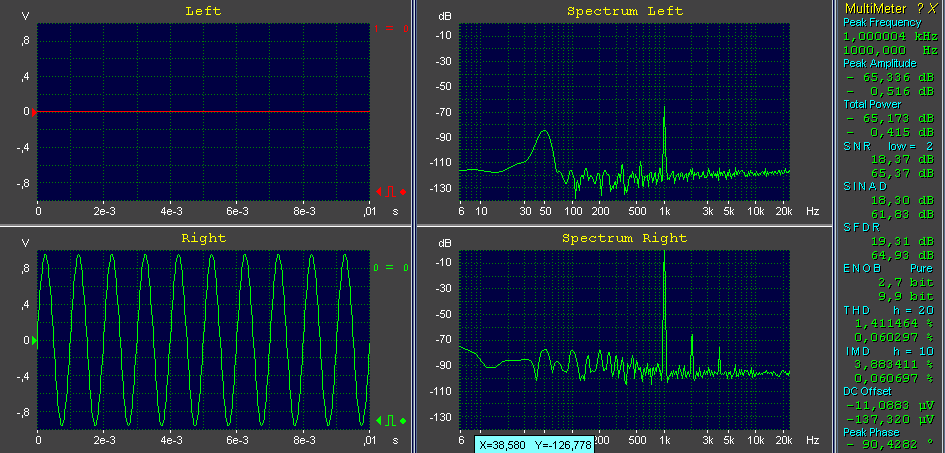

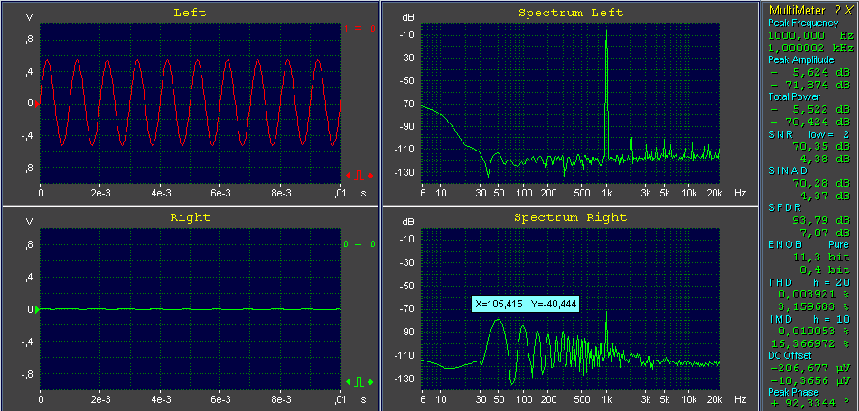

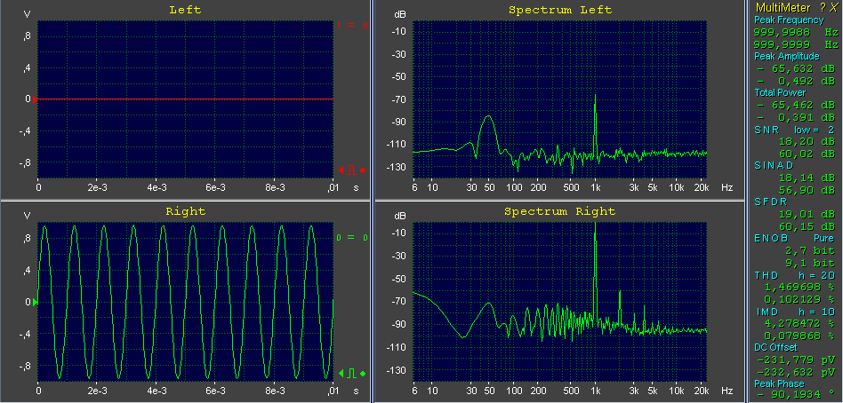

Made some modifications.
Replaced R4 and added input caps.
This doesn't help. Actually when going from 2kHz to 4kHz there is indeed a 6dB degradation in THD.
Since the extra filter capacitors are directly related to the extra resistor in de power supply lines, I'll add these later on the new PCB.
Since it seems that this has indeed a lot to do with the half-sine waves on the power lines, I'm going to re-layout my ppower supply.
After that I'll try improvements with R34/24 and R21. I think I won't be able to measure any imporvements there in the current situation.

Finished the new power supply: no improvements on THD figure.
Measured the soundcard: Behaves very well under loading with 10kOhm resistor.
So it must be something in the amplifier itself. Design off the new PCB has started. I really hope that that modification is going to improve something, so that I at least have a starting point for further improvements....
