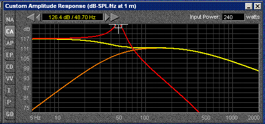

A car with the windows down is a lossy bandpass enclosure with a really high tuning frequency, this is also why they sound louder with a window down.
example;
The orange trace is a standard sealed enclosure (alpine type R 12'' in 45L)
Yellow trace is the above enclosure in a car (low frequency roll off not modeled)
red trace is what happens when you roll your window down(4th order bandpass, 45l rear, 800L+ front (cabin space) 500mm x 800mm hole (window opening)
You can also hear the high group delay from the bandpass effect when you wind down the window.
