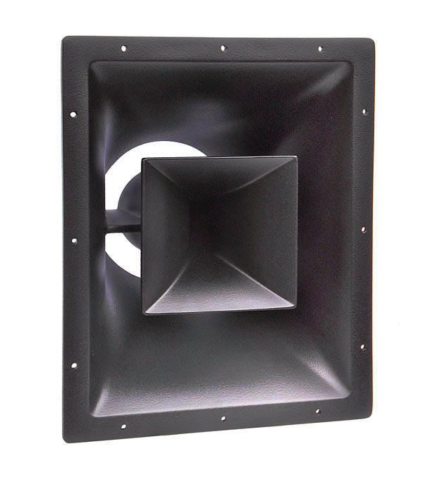

Flipping through their catalog, particularly in the case of wanting to stick with a single mid/high per side, the 870qx seems enticing, although I see OP's heart is set on a particular HF waveguide already.

The 92mm outer dia max constraint does limit CD selection significantly, but I'm not sure if the DE360 Limmer show measurements for would run out of steam before the B&C 8NSM64 or RCF MR8N301 midrange drivers specified. If it's an issue at max SPL, a quick search shows Celestion makes a few CD's <92mm OD with 1" throat and somewhat higher power ratings than the DE360, other manufacturers may as well.

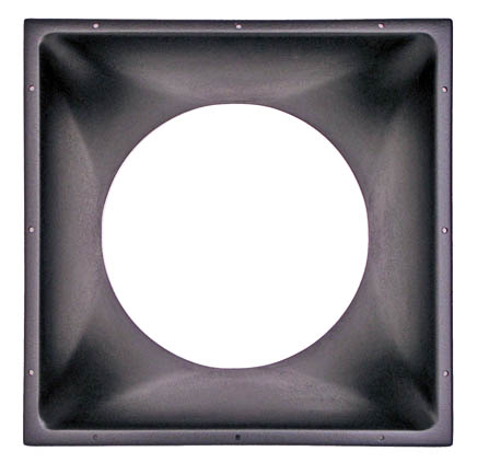

With regards to a 15" bass cab, Limmer's 085 waveguide looks interesting. I'm thinking of something analogous to the QB5 alignment but with mechanical assistance instead of (or in addition to) electronic - tuning a larger box to put a bump around 80-120hz to help the low end. Unsure if the extra weight and physical size of the larger rear chamber and added waveguide is justifiable vs. just bringing a second pair of cabs, but an interesting thought experiment nevertheless. Looking at the plots shown, they do specify a higher tuning for the cabinet used with the waveguide so maybe this is what they're doing already.
