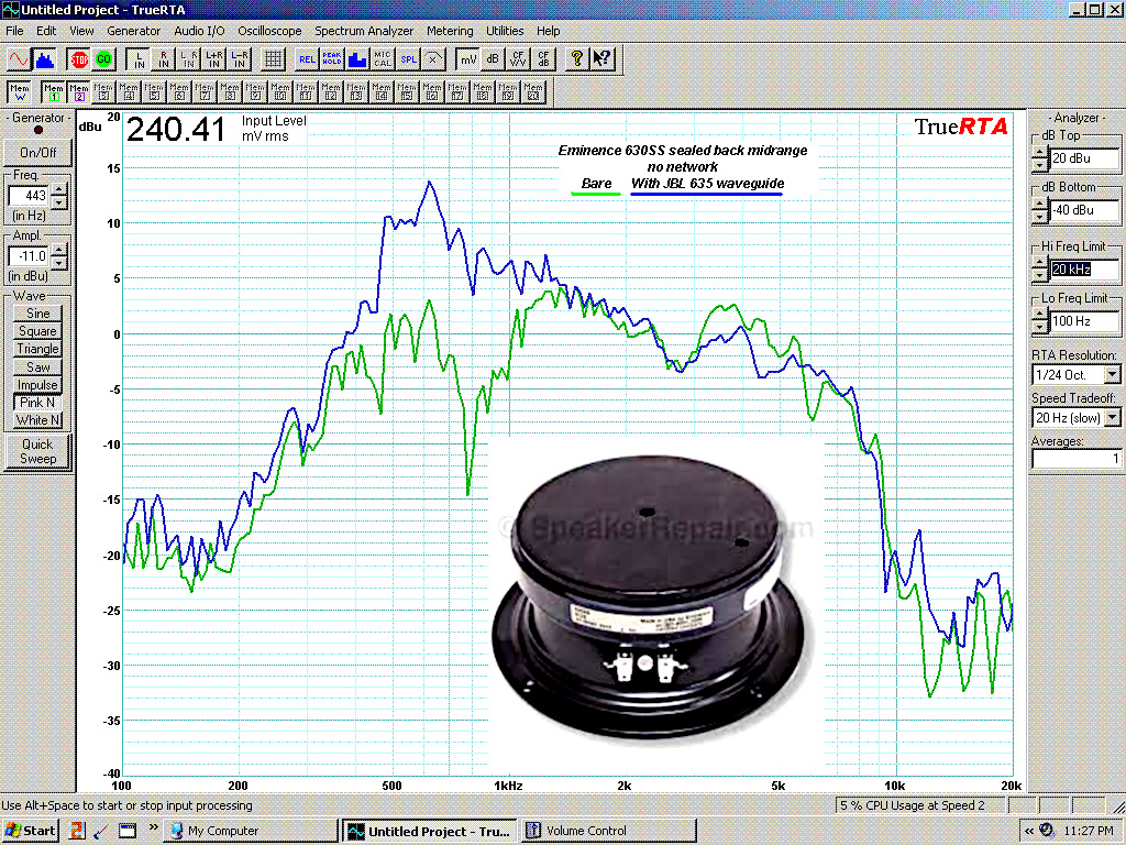

The little single 6.5"JBL waveguide did as below with a sealed back Eminence 6.5"
I believe all I’ll be able to get down to before a very steep natural roll off with the JBL horn is 500 or so. I know the most important frequencies for vocal production are roughly 300/400-2,000hz, and that’s the basis of why I’m wanting to cross at 400. Along with a safer HF range and more comfortable LF. I doubt 100hz would make a feasible difference,
