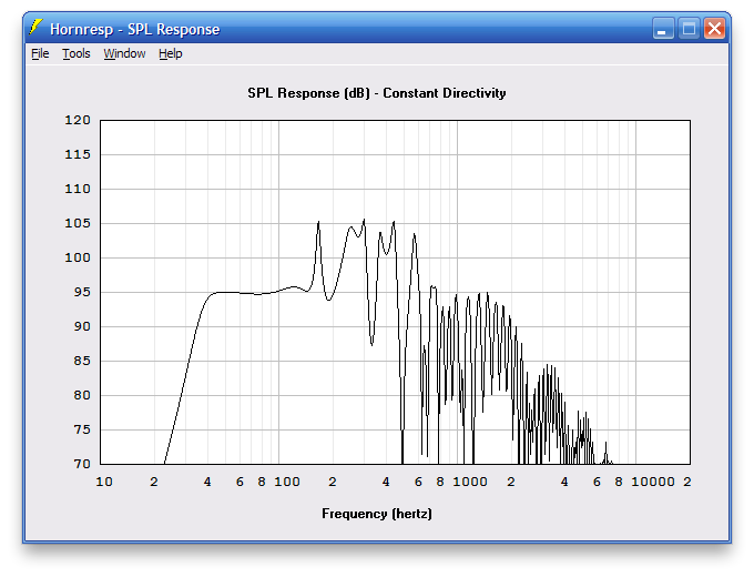

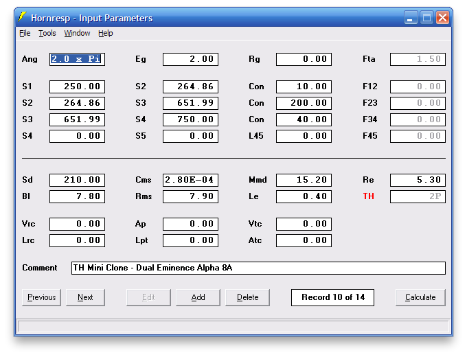

So far the design I'm happiest with is 2x Alpha 8A's in a 40hz tapped horn. Essentially a clone of the TH mini but adjusted a bit. This models with a ruler flat response and 95dB sensitivity. It'll likely be usable up to 200hz or more depending how bad the resonance harmonics measure in practice. Pics included below.
Anyhow, I'd like to know if this project sparks any ideas with folks, particularly for drivers or alternate alignments/approaches.

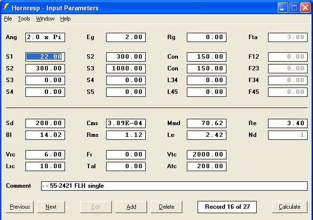

I keep coming back to the $25-$30 mcm 55-2421 in a FLH. I set up a 12v redneck soccer field system for a friend using these. (actually it was running off of a pair of my dual driver 55-2421 cabinets) Dual battery on a diesel pickup runs all day. My tops end up eating more juice than the subs...
However, this is exactly the same size (120liter) as your TH, uses only a single, cheaper driver, and gives a couple more db output. Standard 80hz cross flattens the midbass spike, and you end up with flat from 40 to about 160-180.
If you have the travel room for a couple of them, you can set them up in a 'V' shape, put a piece of plywood over the top, and gain even a little more output. A pair of these running off of a T-amp, should get you 95db at 10m. While that is not earth shaking bass, it'll fill out the bottom end, and get you good sound, on very little power.
Take them indoor, and put them in a corner, and they really come to life.

Your attached calculation assumes indoor use, so it's useless outdoors. Apply a 12 dB/octave filter starting at 120 Hz to that calculation and you're getting close to the real output the speaker will have outdoors.
They're half space (ie groundplane). No room gain is assumed.
I've not heard of this second order fall off at 120hz due to being outdoors. Can you explain further or provide a reference?

There is no room gain in that calculation. Hornresp does not have a room gain feature AFAIK. It does assume halfspace radiation angle, which I believe is a reasonable assumption.

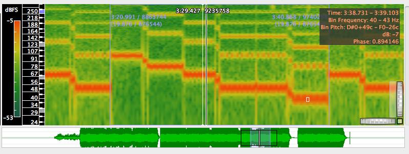

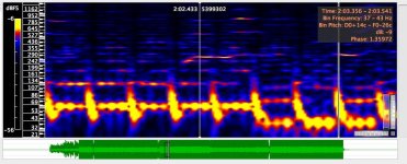

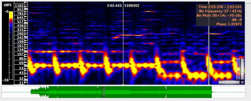

This discussion got me curious, so I looked at some tracks in a spectrograph. Now, these are mp3's, so the bass region will have been crushed, but for our purposes, that makes them a conservative representation: if anything the raw audio will have more energy in this region.
Top image is one of Skream's remix of La Roux's In for the Kill. The fundamentals are all 100-40hz, with the lowest right on 40hz. There are a lot of harmonics, but the next harmonic is about -6dB and they drop faster after that. I'd guess this is why the emphasis around 100hz in your system works so well, it brings up the first harmonic of the bassline to the amplitude the fundamental would be if it were present.
Second image is a remix of Coeur de Pirate's Comme des Enfants, a much more poppy track. Again we see lowest fundamentals at around 40hz, and that the bulk of the kick's energy is in the 40-80 region.
So, while writing off below 80hz might be a good compromise depending how loud you want to go, I don't think it's true to say there isn't much content there in dubstep (or in dance music in general).
I make electronica music with some of my friends on occasitions, some for sale at iTunes some free at http://www.retrofox.dk/, so I know what I'm talking about. After listening to it for a few minutes you will not notice the deepbass missing provided you have the 3-6 dB peak in the 100-120 Hz range ... outdoors that is.
As any sound engineer will know sound behaves quite differently outdoors but you can either take my word for it, or test it yourself.
