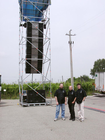

And this is a pro system made by some friends,
there are three Stage Accompany mounted in every box, and they are 16 per channel ;-)
ciao
Filippo
www.audiofanatic.it
