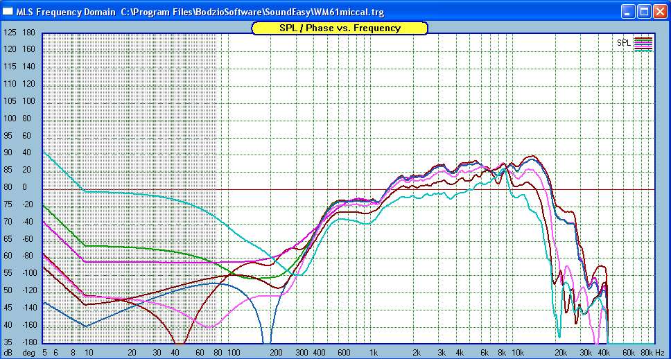

Gainphile, I'm going to guess you could cross them at 1.4k, but I'll let you decide - here is a graph of an open back Neo3, at 0, 15, 30, 45, and 60 degrees, with NO baffle at all. I've been using it this way for a couple of weeks, and think it is a great improvement - particularly, vocals are noticeably more articulate. I had previously been using them on a 28cm baffle, which in retrospect, made them sound like they had baffles step problems. Although I hadn't noticed it before, vocals now sound like they are noticeably less nasal.
The only deviation from an ideal dipole pattern is between 7 and 9k (although above 2k the pattern narrows a little due to driver dispersion, ie, above 2k, at 60deg, the response is down 7-8db versus the ideal 6db - but still the off axis response is very smooth compared to baffle mounted drivers. ). The tweeter is supposed to be 90.5dB/2.83V/1m, although I haven't measured.
Enjoy
PS - it is hard to read the graph at 8k, because the 0deg and 45deg lines are both brown - at 8k, the dip is 0deg (unfortunately) - the upper trace is 45deg. I guess the good news is that the on axis null is filled in off axis. I listen to them at a 30deg angle. What I think is going on is the grill of the driver is causing an on-axis cancellation at 8k, which disappears off-axis due to the changing path geometry, combined with off-axis 'baffle' peaking (the baffle being the tweeters frame), usually seen at much lower frequencies with drivers on baffles.
