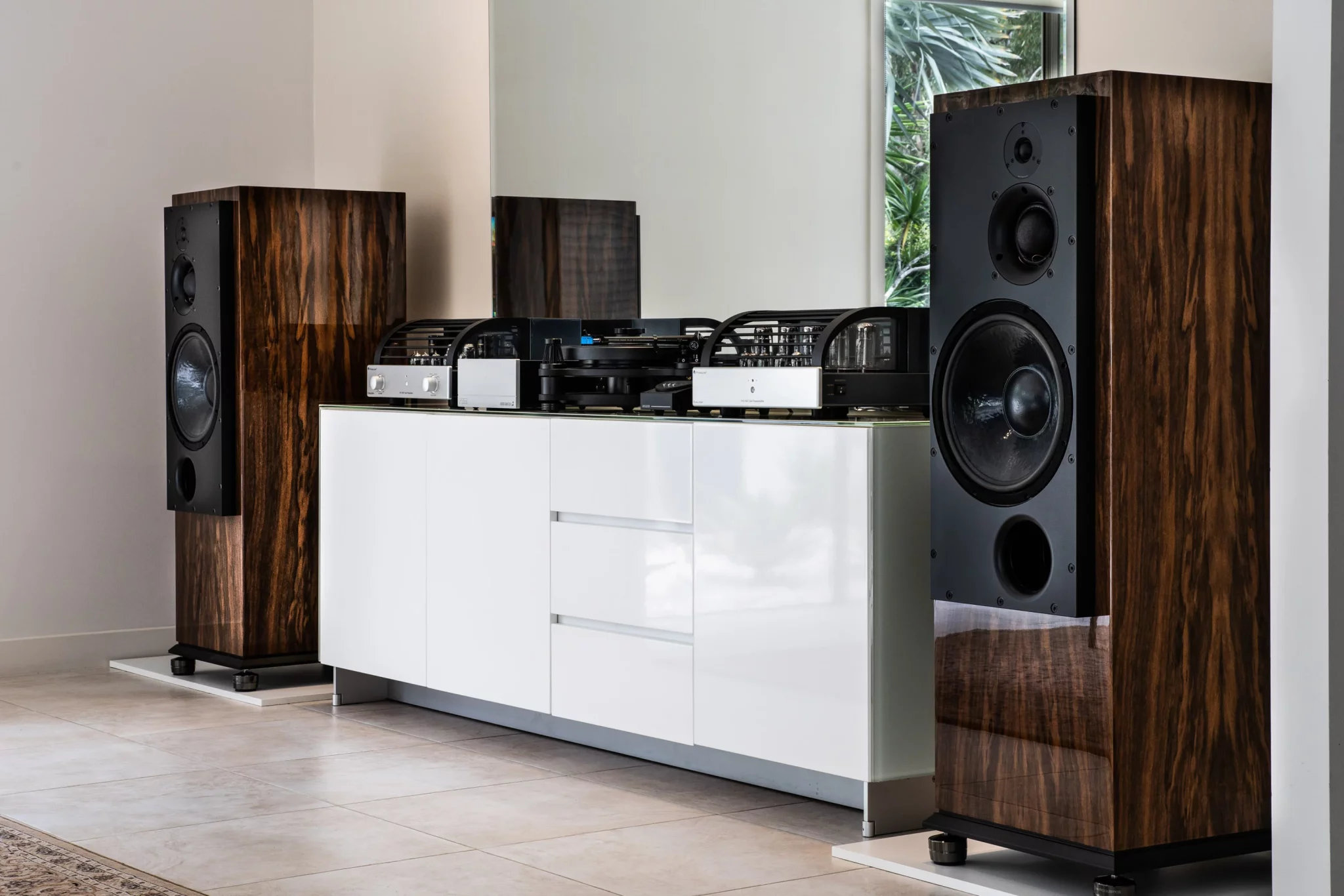

Something ATC SCM100-inspired (sealed or ported box, dome mid, wide directivity) would be ideal—just done with higher-efficiency components and optimized for use with low-power SETs. Given how many 300B amps are out there, I’m honestly surprised there aren’t more high-efficiency, no-horns TMW speakers using top-tier drivers. Is this just a pipe dream?
