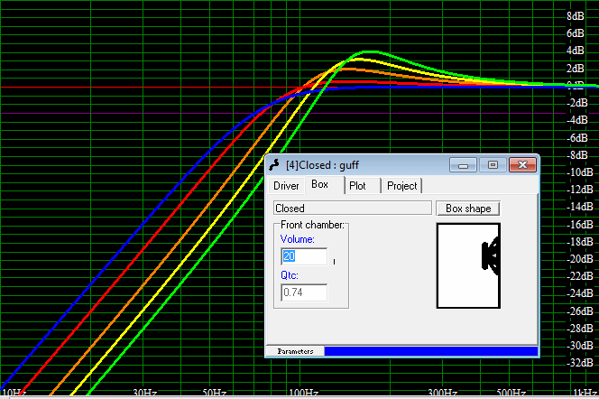

6 x 8" drivers in each 20L box will need shedloads of power to drive
them to there excursion limits in the bass*, and at 3.33L per driver
your living in cuckooland regarding any suitable drivers for the job.
You need to do some proper modelling.
rgds, sreten.
* Well beyond their thermal limits I suspect, but
I'm too lazy to do the actual modeling for you.
Hi, attached is 1, 2, 4, 6 and 8 NS6's into 20L sealed, rgds, sreten.

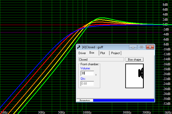

Hi, same thing with 30L instead of 20L, rgds, sreten.
The above also shows 40L by transposing, blue = 2 drivers.
FWIW searching indicates a better choice than the NS6 is
a shedload more expensive. The nature of the NS6 motor
indicates progressive lower harmonic distortion as levels
increase but no real critical excursion point where higher
harmonics suddenly appear, see Home .
