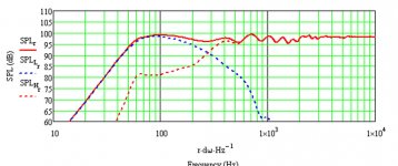

Driver I'm looking is going to be mounted on open baffle (45cmx100cm) with 2x Audax 12" per side so efficiency can go even as high as 96db/w and I'll still have enough bass but low efficiency is also OK as long as I'm getting what i'm looking for.
If those 2 Audax 12" are also on the OB, then you won't get 96dB/w of sensitivity. 45cm wide is not going to support that under 200Hz or so. (ok, with help of the floor, maybe 100-something)

Thanks guys. I've just bought used Supravox 135 VERY cheaply. They were just 130euro/pair !!! A real bargain and I can always sell them without loss if they're not good enough.
A friend of mine said that they're slightly quicker than b200.

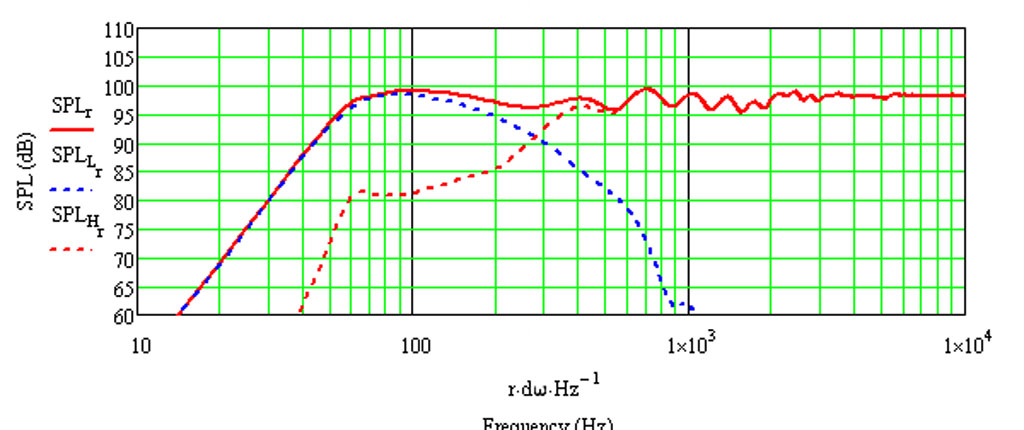

As for 2xAudax 12" per side - belive me they'll make it. With QTS=0.8 They make 101db/2.8v on the baffle at 100hz !
With Monacor ms-100chq (94db/2.8v) and Saba (96db/2.8v) they needed a little bit of series resistance.
On the graph you can see predicted response for Supravox 135lb and parallel woofers with 1ohm series resisatance built into the coil.
(2nd order 180hz, 1st order 370hz , 1ohm resistance for woofers)
They give very realistic, dry and even bass response down to 45hz with a little help of main room mode which occurs at 47hz . Additionally I also use modified Behringer DEQ to lift response in 30hz-60hz region wich makes bass even deeper.
