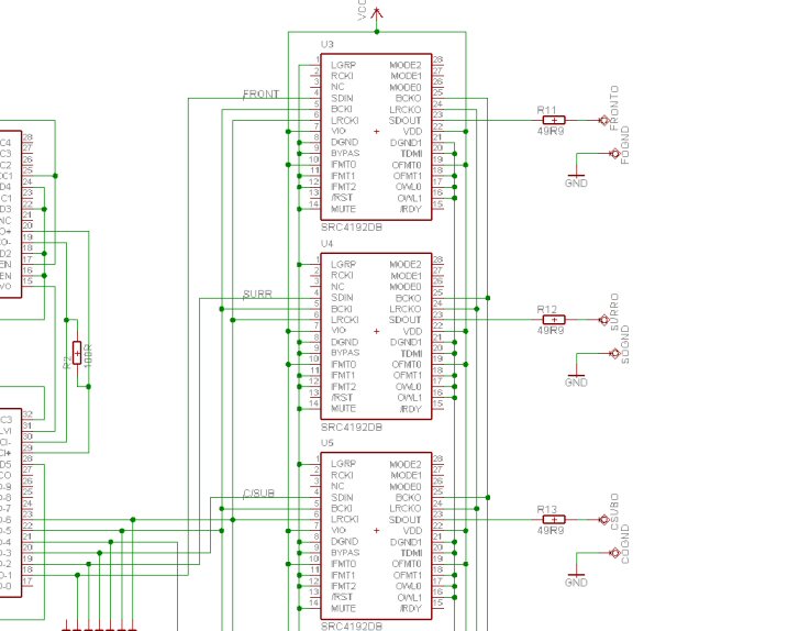

@Brian (or anyone who can help.) 🙂
I'm just trying to layout some PCB designs for muxit interfaces using SRC4192's, but I'm a bit stuck about how to configure them.....
I see in the datasheet that they don't need to be linked for matched phase, but how should I set the MODE pins? I'm guessing the first chip should be set as master and the rest of the chips set as slave seeing that the output BCLK and LRCLK pins are tied together?
The crystals on the Audiotrak Prodigy I will be using as a source are 24.576MHz and 22.5792 - does this mean I should be using 512fs or 256fs mode?
I've attached a screenshot of how I have the chips connected atm (no master clock or reset yet etc.).
Also, is your master clock actually on your receiver board, or is it taken from your amp's master clock? What speed clock are you using on your receiver board (I can't quite make it out on the pdf file.)
I'm also assuming that if I was to modify my sound card with a muxit transmitter, is it a good idea to have a low jitter clock on the sound card as well as a low jitter clock for the master clock at the receiver end?
Another area of confusion is - do you use the same low jitter clock for both the ASRC reference clock and equibit amps?
Thanks,
OzOnE.

Ok, I think I'm getting my head around some of it.....
I've set the first SRC4192's output port as master / 256fs giving me a 96KHz output sample rate when using a 24.576MHz reference clock.
The rest of the chips are set with both ports as slave, so they will receive the BCLK and LRCLK signals from the first chip.
So, the master clock on the receiver board WILL have to clock the DAC (or digital amp) section as well as the ASRC chips?
But, does this also mean that the input ports can be slaved, and they don't need a master clock from the LVDS receiver chip (because the ASRC is reclocking everything anyway?)
Also, I've grounded the TDM inputs on all chips - is this correct?
Plus, I'm probably going to add a multiplexer to the receiver board so I can switch between an external input and the amp's own inputs (from it's ADC's / DSPs) - can anyone suggest which type of logic to use for minimal jitter (I don't think it will matter too much though.)
OzOnE.
A glaring error I think I'm making is that I assumed the BCLK and LRCLK signals on the output ports were being generated by the ASRC chips themselves.
I'm thinking now that all the chips are slaved from the DAC / Equibit's own master clock, so the BCLK and LRCLK are in fact the "inputs" to the output ports on the ASRCs.
The BCLK and LRCLK signals mainly serve to allow the ASRC to sync the output data to the DAC's clock signals. (I'm probably wrong again here.)
So, your super-duper low jitter Kwak / Tent / Platypus / Tipi clock (only kidding) can still be connected to your DAC, and the ASRC chips will simply sync their data outputs to it.
But, does that mean the reference clock is literally a reference, and is asyncronous to the input and output ports?
OzOnE.
Correct.
The way I am using them, and the way I would probably recommend for most situations, is for the ASRC to be run as slaves.
Actually, you are correct here.
Yes, and an important point here is that the critical low-jitter Master MCLK signal that is feeding the Equibit or DAC IC doesn't even have to go anywhere near the ASRC. This is especially useful if the ASRC is being retrofitted on a separate board.
Correct. IF the ASRC is being used in slave mode, the reference clock is used to initialize the ASRC, and to drive the interface logic and rate ratio estimator circuitry. It isn't directly used to time any of the audio clocks.
(If the ASRC is in master mode, then the reference clock would also be used to generate the audio output clocks, which is why I usually wouldn't want to use it that way.)
Brian.:cubist:
