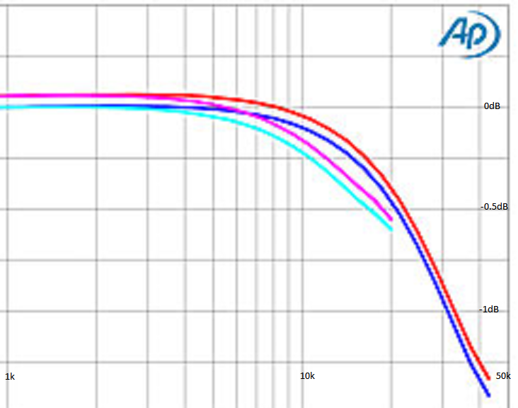

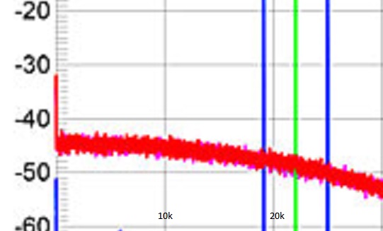

I wonder if the theoretical sin(x)/x -3dB drop of the zero-order sample-and-hold is real? Has anybody measured it with pink noise and an FFT analyzer? Not with a swept sine that could give false results at fractions of the sampling frequency.
Good point there about not getting a reliable FR with a swept tone with an unfiltered NOS DAC. Stereophile has a review of the BorderPatrol DAC here which is a good example of the genre : BorderPatrol Digital to Analogue Converter SE Measurements | Stereophile.com
The FR plot with the white noise stimulus is the correct one - that's the red fuzzy line starting around -45dB and drooping to -48dB by 20kHz. Contrast with the magenta/cyan lines in the swept plot where there's about 0.6dB droop @20kHz.

I recently bought a Behringer UMC202HD (cost me about $80) which works a treat as a low-cost audio analyzer in conjunction with Audacity (free open source audio editor). Using its capability to record up to 192kHz you can check filter responses up to 80kHz or so. Attached a screengrab of the FR of one of my droop corrected NOS DACs, running at 192k. Using FFT techniques is the only way to get a realistic impression of the FR of a NOS DAC, swept sinewaves give erroneous answers (see Stereophile's measurements of the BorderPatrol NOS DAC for an example)
