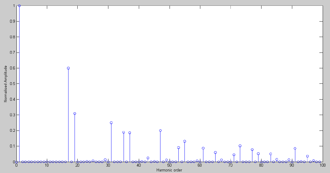

The Fourier series expansion for the above waveform is such that each term of the expansion is given by:
The plus / minus sign depends on whether the harmonic under consideration is odd (negative) or even (positive). Thus, by equating the coefficient of the sinusoidal component to zero, we're able to completely eliminate a particular harmonic. For example, eliminating the 7th harmonic (only) implies:

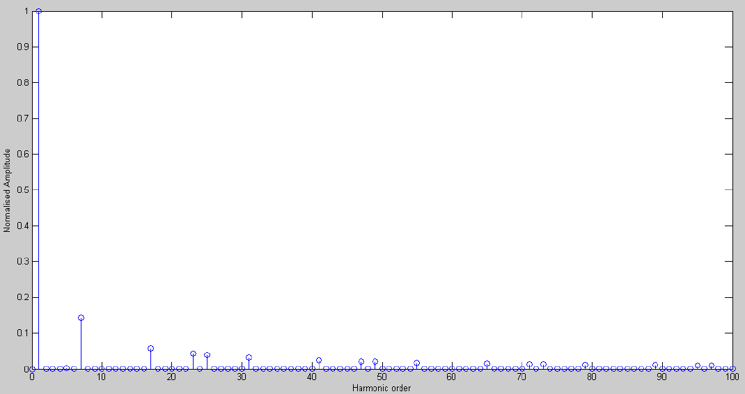

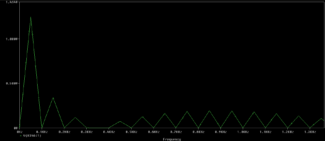

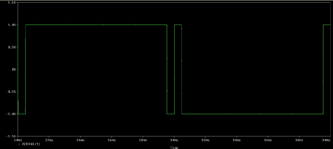

And, when we look at the pulse waveform and its FFT, the seventh harmonic is eliminated as expected. The extra switching for eliminating the harmonic occurs at 8.5 degrees and 180 - 8.5 degrees, as calculated above.
Note that the switching position is in degrees and is therefore applicable to a waveform of any frequency though the example shown below is that of 50Hz, with the 7th harmonic occuring at 350Hz.
Now, it is fairly easy to see that eliminating one harmonic (7th in this case) required an extra switching transition in the waveform, which also implies that eliminating every single harmonic into the kHz would require as many switching transitions. This is why this method is suitable for eliminating only a "selected set harmonics", so that the switchings / losses / EMI are also minimised.
Fortunately, this fact also suits the case of a 3-phase motor drive in which many triplen (3n) harmonics are already eliminated, and the only the remaining energy concentrated in the 5th and 7th harmonics need to be removed.

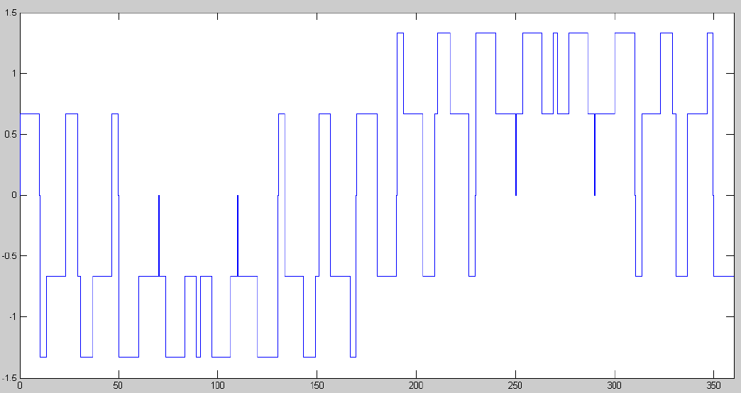

Modifying the equation in post #2 to eliminate two harmonics (5th and 7th) gives a system of trigonometric equations known as transcendental equations
that are more conveniently solved using computers. The mathematics for the same, being beyond the scope of this thread (and forum), is therefore omitted. Highly interested members may refer to the following paper:
J. Chiasson, L. M. Tolbert, K. McKenzie, and Z. Du, “A complete solution to the harmonic elimination problem,” IEEE Trans. Power Electron.,vol. 19, no. 2, pp. 491–499, Mar. 2004.
Available online at: https://web.eecs.utk.edu/~tolbert/publications/apec_2003_complete.pdf

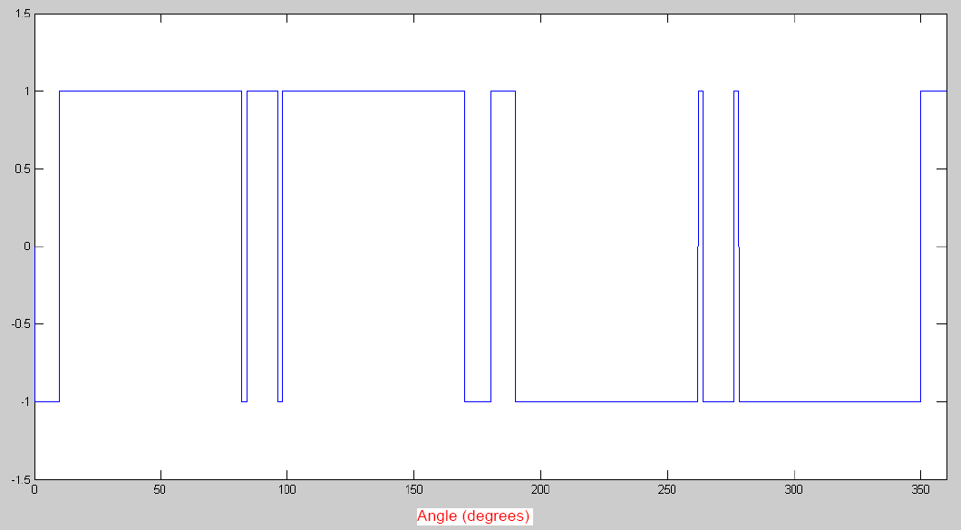

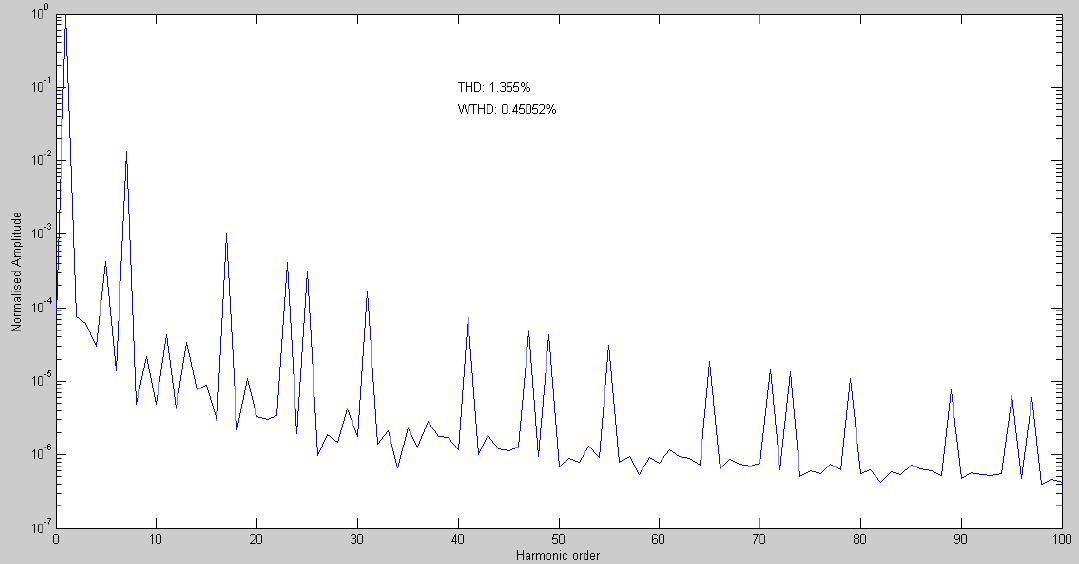

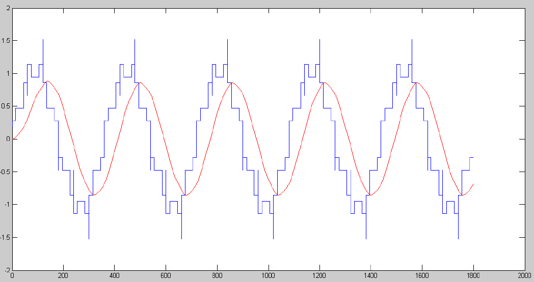

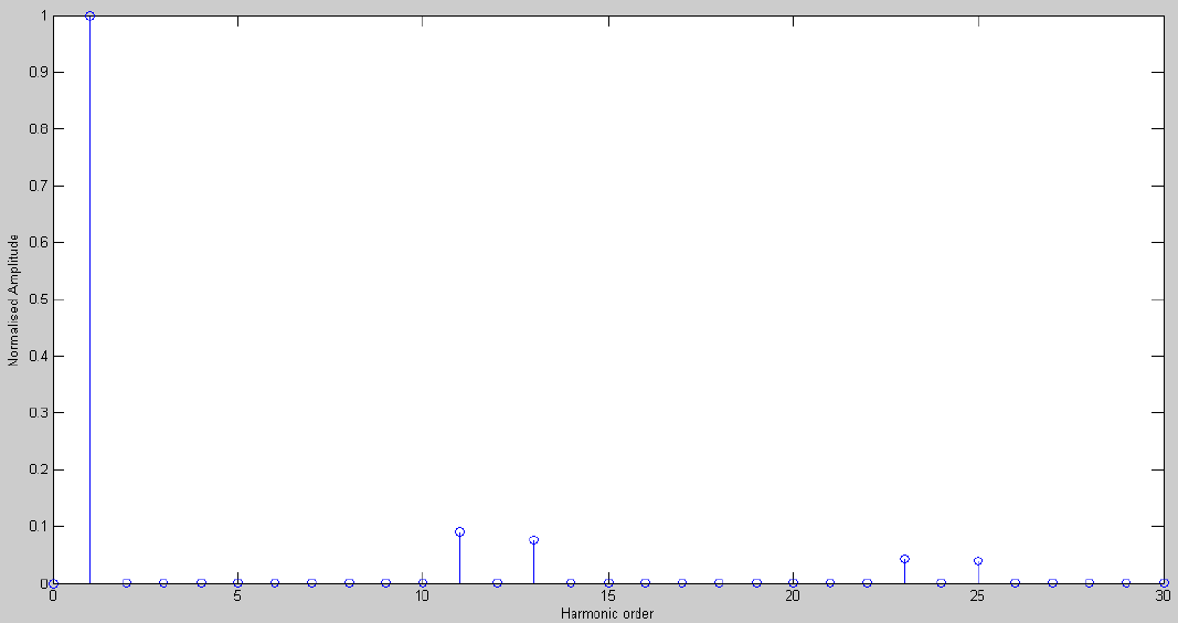

The resulting waveform for eliminating 5th and 7th harmonics and its FFT spectrum are shown below.

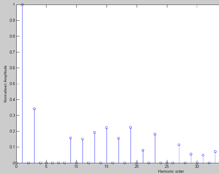

We see that:
As we see above in the FFT of the phase voltage, the first dominant harmonic is the 11th.

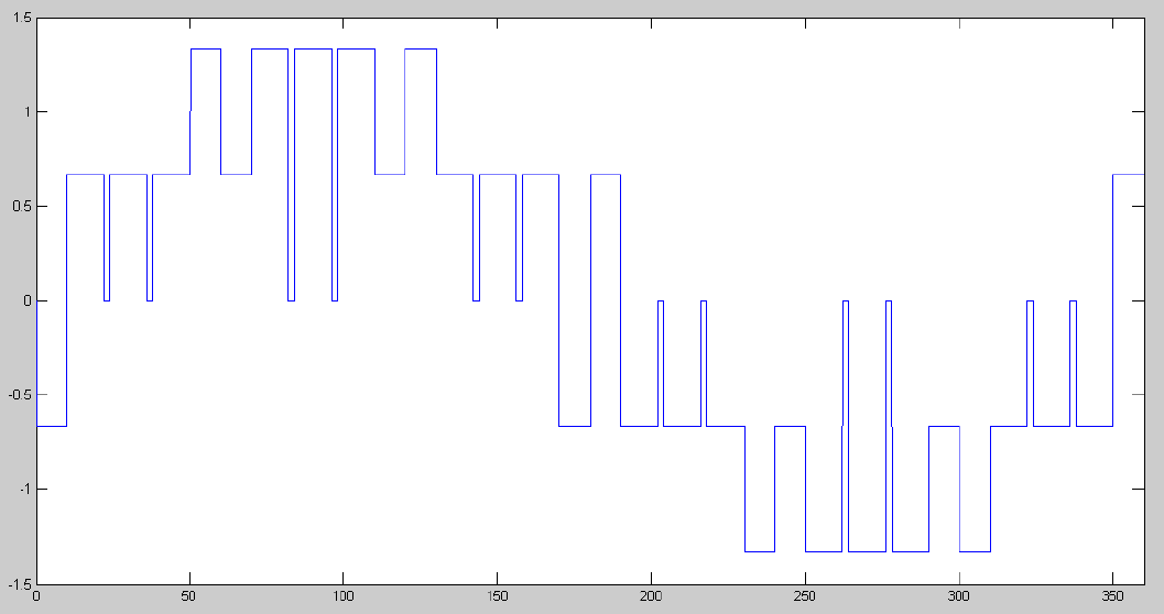

We see that:
- Orders 2, 4, 6, 8,... etc. are already eliminated using half-wave symmetry of the waveform.
- 5th & 7th are eliminated using SHE modulation.
- The triplen (3rd, 9th, 15th) would be removed by the 3-phase system and as a result, they wouldn't appear in the motor phase voltage, as shown below.
The switching angles used in the above-mentioned method (5th & 7th elimination) are:
To implement the above modulation, simply include these switching timings into the basic waveform in post#2.
Note that these angles are fixed and may therefore be "burnt" into the program memory of a simple MCU and then be directly put out through GPIOs as the gate-drive signals for the inverter.

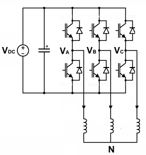

The preferred circuit diagram for Method 1 above (5 & 7th harmonic elimination) uses the floating star-connection as shown below. However, a delta-connected motor maybe used if desired. An open-end winding motor is capable of being reconnected as star or delta and should not be a problem in any case.

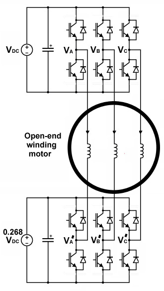

Method 2 - Non-SHE method for eliminating all harmonics of order 6n±1 (for n = odd).
- For open-end winding motors.
- Only 50% square-waveforms are used with no extra switchings as in SHE.
- Requires two inverters and two separate (isolated) DC voltages in the ratio 1: 0.268.
- More sophisticated and higher performance when compared to the single supply SHE methods.

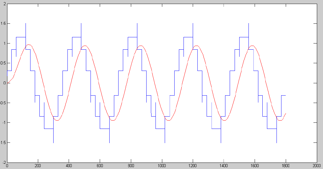

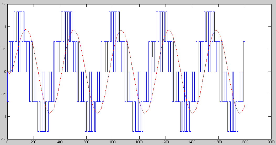

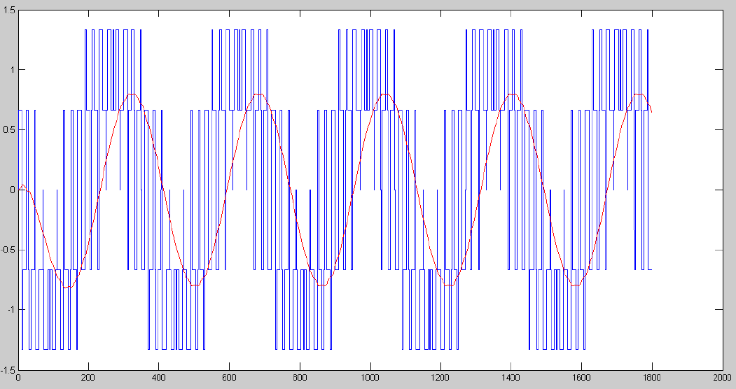

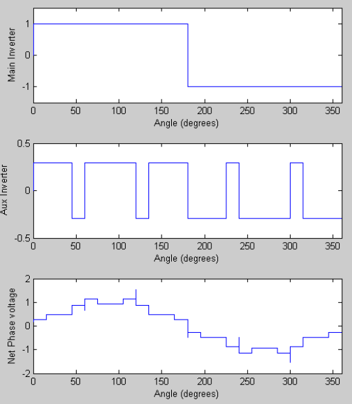

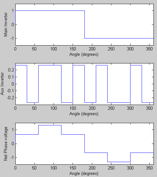

Modulation of the dual-inverter circuit in post #7
The main inverter (powered by Vdc) is fed with a three-phase square-wave of fundamental frequency while the auxiliary inverter (powered by 0.268Vdc) is fed with a suitable waveform so as to cancel all unwanted harmonic components upto the 11th, according to the following expressions:

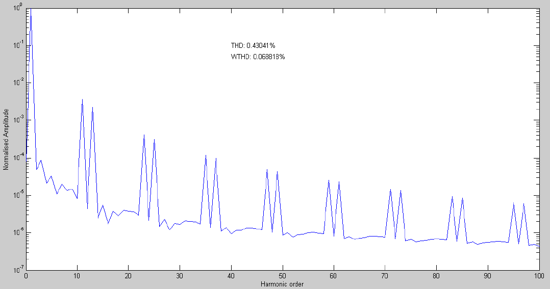

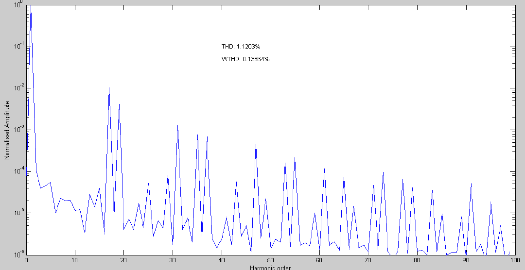

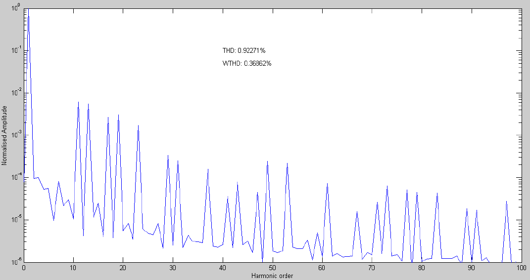

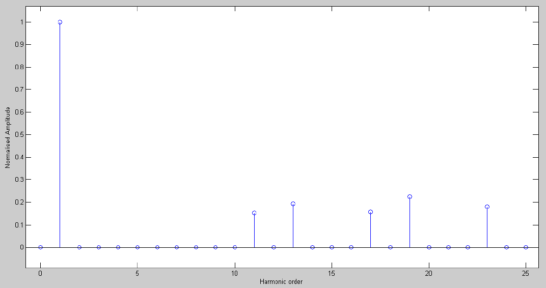

The waveforms for Method 2 are shown below with the FFT of the final motor phase voltage:
As seen above, all harmonic pairs around 6n for n = odd i.e. 6n±1 have been eliminated, as opposed to only 5th &,7th for the SHE method above.
