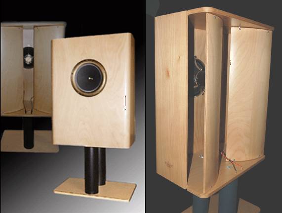

Auditorium 23- Solovox
http://www.6moons.com/audioreviews/auditorium232/solovox.html
@ 1/2 way down- dimensions
http://www.novacon.com.br/audioafca2ka.htm
http://www.auditorium-23.de/Speakers/SoloVox.html
"It is a stand mounted open baffle design."
http://www.auditorium23.de/Speakers/SoloVox_AW.pdf

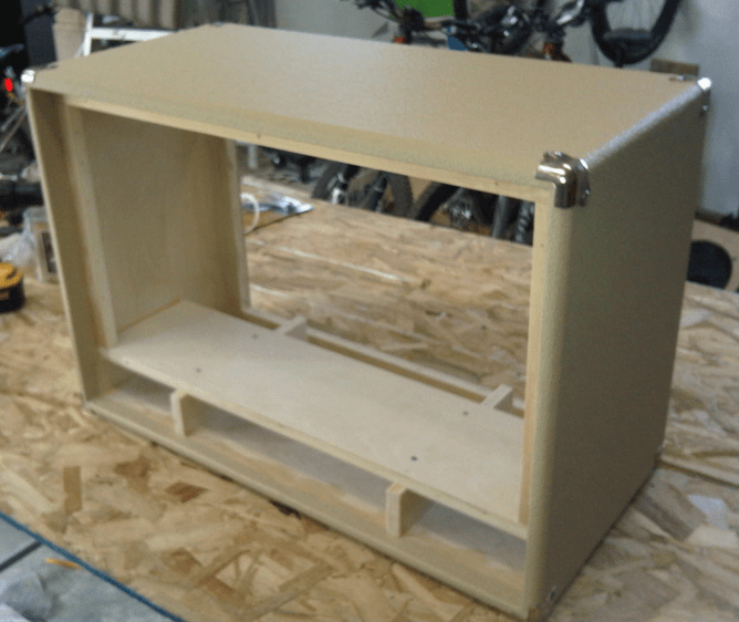

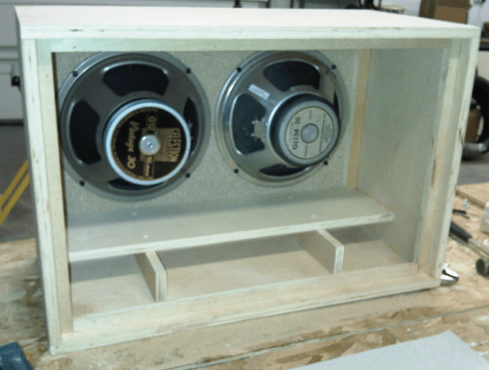

Hi, I've found this photos of a guy cloning an existing cabinet (that is very similar to a pair of TL806).
The back of the cabinet (removed in the photo below) is fully closed.
The opening is in the low part of the front (here below without the front baffle). Can it be considered a reflex?
I reply to myself by looking better at EV TL806 specs:
https://robrobinette.com/images/Guitar/5E3P_Build/TL806_builders_plans.pdf
They are indeed bass reflex cabinets:
