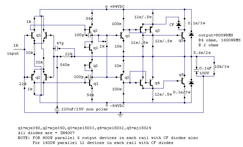

hello saint,
I'm planning to build ur amp design soon av400/av800, because I heared it is sounding good. I have a question, what is the total output power of av400 if I connect in bridge mode.
I have a simple calculation to find the output power bridge mode type as follows!!!.
bridge mode type.
@ 16 ohms=400 watts
@ 8 ohms =800 watts
@ 4 ohms =1200 watts--- it is possible to connect in 4 ohms load?
many thanks,
rlg

hello' guys'
pls. help, I just built av400 I make my own pcb of this version. my problem is during pre test the amp is ok. it read 1.6 vot at R2 , R4, but when I put the power mosfet the fuse was blow.
anyone can help, I expect that the op is damage. but I dont know on how to check the mosfet.

mosfets, gets easily zapped when there is nothing at the gate, i learn'ed that the hard way. make sure gate biasing is ok, and set not to high.
if fuse blows, check the mosfets drain and source, it shuld be a diode forward biased one side and infinitely high reistance at the other side, that is when using your ohmmeter when cheking.
