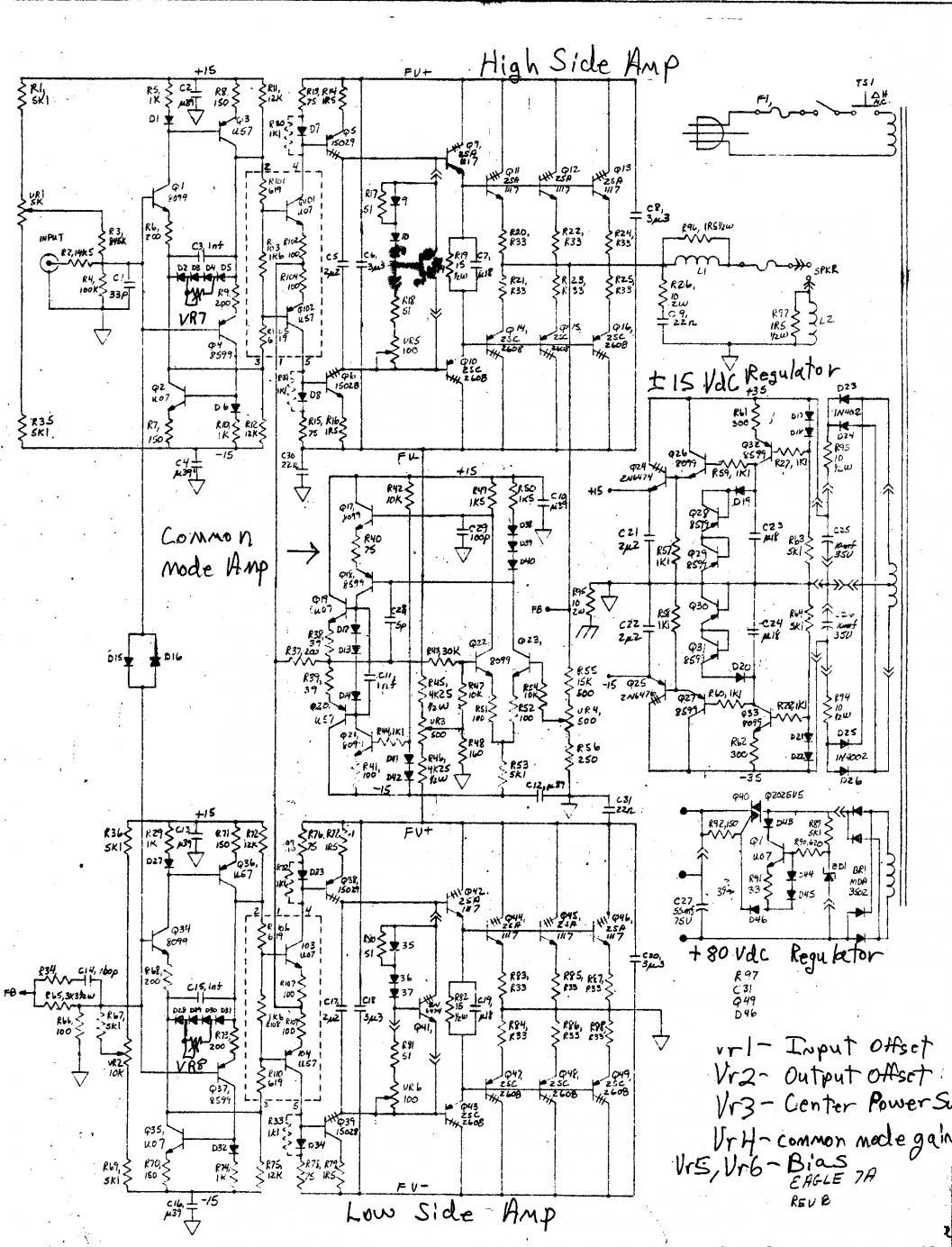

Why is it not common to see high power amplifier with single ended power supply? I have a big transformer (around 7A) with 14Vac or about 20Vdc that I want to use for as highest wattage amplifier as possible. The front end can be driven with higher rail voltage if necessary. Is there such amplifier design somewhere?
Yup, right here: Zeus Amp
That'll get around the need for a dual, +/- supply.
Multiplier! That's a good idea, thanks. I will use the 20V-0-20V for Quasi NBIP using 4x or 6x 2N3773 per channel.
It's not a multiplier. It's two back-to-back half wave rectifiers running off the same xfmr. You're looking at a whole essssssss-load of problems: DC core magnetization, and making the filtering job twice as hard as it would be with full wave rectification.
