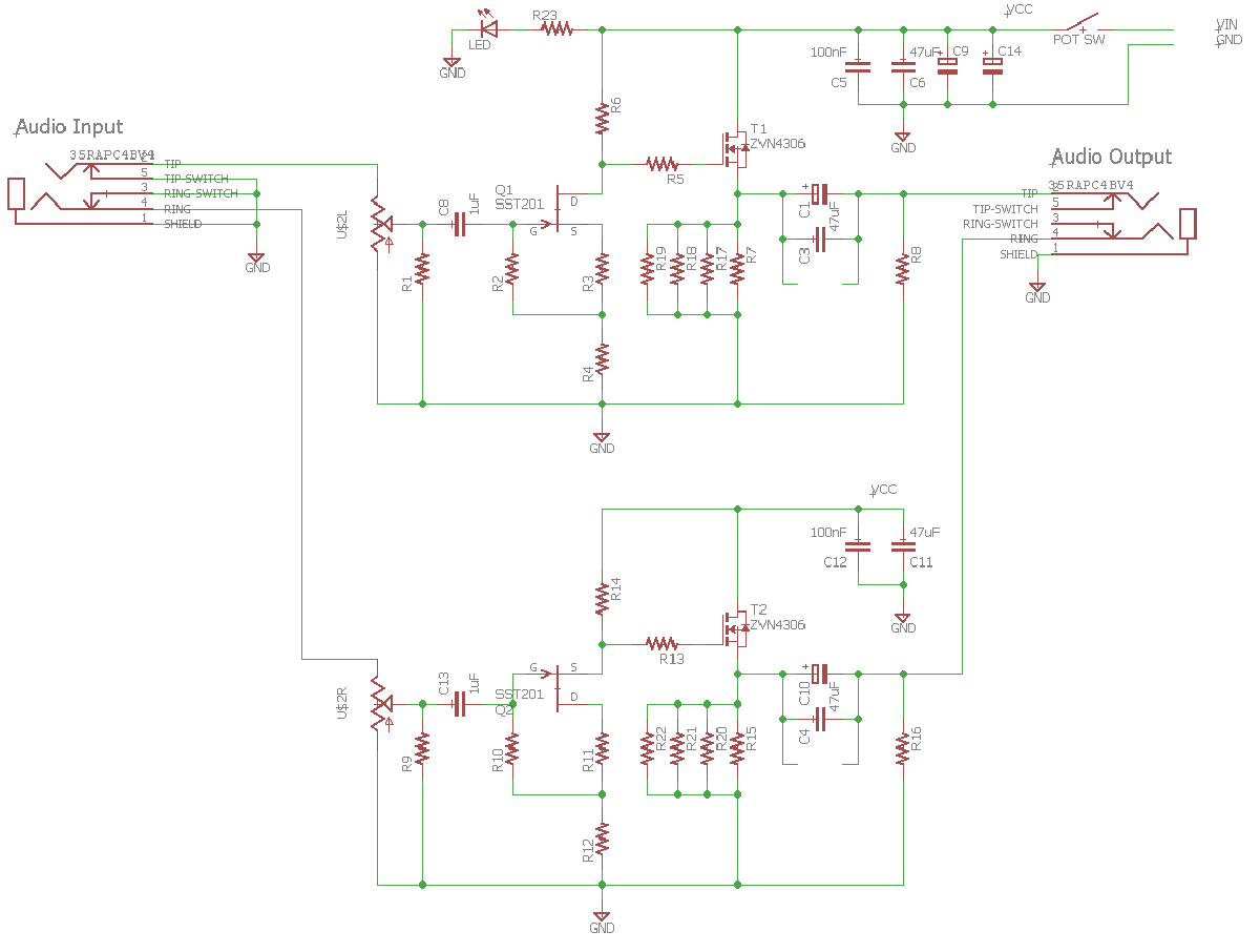

The SE Class A pocket amp is my own design. It will have the same harmonic signature of a tube amp but cleaner. Absolutely no hiss/noise dead silent.

Output caps
Thx for sharing the schematic.
I don't like caps (DC blocking caps) on the output or input. In all my designs, I either don't use them or servo the output somehow.
I see caps in your SE design. For the output, what are your DC voltage readings (powered up, but with no signal) if you bypassed (shorted) the output caps?

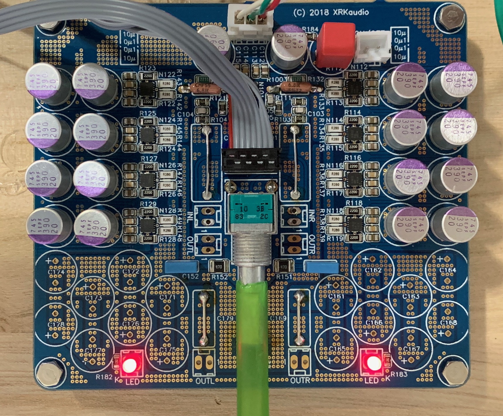

The OPa1622 is a good one and I think one of the posts that vanished was the one where I showed 8 of them parallel together. Send me a PM of you are interested, but the 8x OPA1622 has enough current to drive 8ohm speakers to a few watts. It also is very low distortion and has a pleasing sound.
This PCB had provision for AC coupling but it was bypassed on input and output as you can see the jumpers.
