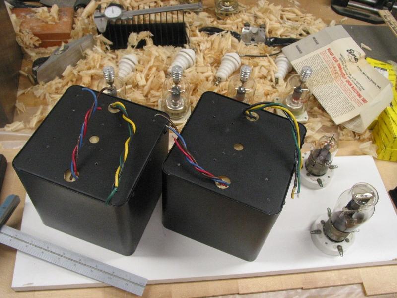

Yeah, that's nice construction and similar to what I have in mind
only 19" rack based. Love that wrinkle paint. That looks like a nice
recap job. What do these sound like? Are you using them full range?
Is the third can on the bottom level an oil cap?
cool...
Michael
I guess these are rated at 200 Watts. That looks like about a 1500VA
power transformer for each channel, a little bigger than I would expect.
I guess that's an honest CCS rating, convection cooled. Imagine these
in a metal shed at a drive-in in Alabama in July, 100 F and 100%
humidity. Must've been a bug zapper in it's own right;-)

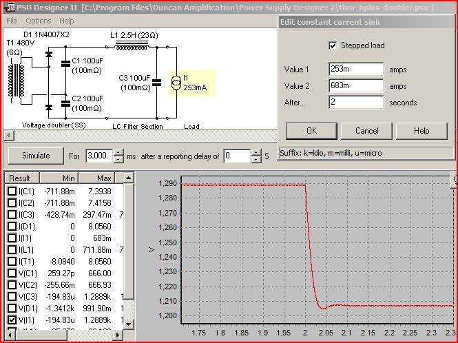

I think the doubler looks like a really good approach for a B+ supply
for this thing. It needs to supply 1200V at from 250mA up to 680mA at
full output. PSUD simulations look encouraging, just need to get a
control transformer that will handle 8A peaks at 480V. Probably will
take about 1.5 KVA, maybe up to 2 KVA .
There's one drawback to the whole plan. It may need a padded tube
caddy to go with it if I plan to actually move it around. I think that's
going to be OK since it's truly an amp for special occasions.
Michael

I identified a power transformer that might deal with 8 amp charging spikes from the doubler
I built a variable power supply that used a variac and a 1KVA control transformer with a bridge rectifier and a BFC (1200 uF 450 V) on each 240 volt secondary (circlotron experiments). The charging current for the BFC caused a 15 amp slow blow fuse to instantly evaporate on power up.
The fix. Inrush current limiters (4 of them in parallel). These things are a thermistor that is made for use in series with the power line. Their resistance is high (tens of ohms) when cold, but the current flowing through them raises their temperature causing the resistance to drop (tenths of an ohm). They come in several sizes. On a supply like this some experimentation is required to find the right one. I had only two sizes here (CL-70 and CL-90), hence the 4 in parallel.
This still doesn't help the fact that the conduction angle for SS diodes is narrow and a choke input doubler is kinda hard to do.
Keep in mind that most industrial control transformers are inefficient and run hot.

My latest build had at least 100lbs of Iron. The 17X10X3 Black Hammond Steel chassis didn't flex or bend, even when supporting the weight on 4 little rubber feet at the corners. If you havent already I'd give them a try.
I've held onto an old PC chassis just for that very purpose.
Build something out of or into it. Needing to be bulletproof.
I'm a terrible packrat, just can't trow away stuff that might
be useful 10 or twenty years down the road...
And I do mean PC, not AT, not ATX... Steel. Thick. Heavy.
It held some sort of external extension backplane for XT.
The power supply inside was LINEAR, believe it or not.
And the chassis very much build to handle the weight of
the huge low voltage transformer. Might be good for DC
filaments if it still works???
Externally, it doesn't look much like anything out of the
ordinary. Its only when you try to lift it!
I'm fairly sure I can fit all my Edcor, Hammond, and Antek
transformers and Chokes. Hundred pounds or thereabouts
sounds about right.
Constructing the power section has been holding me back
for much too long. But I got overkill chokes now. And they
opened a new Harbor Freight nearby, where I found tools
for making nice round holes in 10gauge steel. I can't think
of anything else I might need still lacking.
Though I got only one pair of 814's, with sockets and caps.
May lame out and default to 6L6's or 6GT5A compactrons.
I have those types in sufficient quantity for both channels.
The other tubes I have in quantity, are 6CU5 and 6DJ8.
Expect to see them figured in somewhere.
And I have that X100 Fisher thing to investigate 7189s.
That project has been held up, but not forgotten. As I've
had to spend my evenings fixing my broken truck instead.
But the truck just passed inspection, I'm done with that
distraction hopefully long enough to get something real
done with all this tube crap I've been collecting. Besides
simulation and measurement, show and tell, etc...
