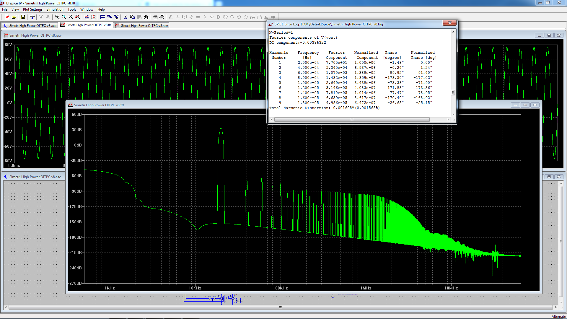

A 400w 8 ohm, 750w 4ohm amp would be what I would like to build. I want the amp to loaf. This is just an opinion.;)
Like this?
