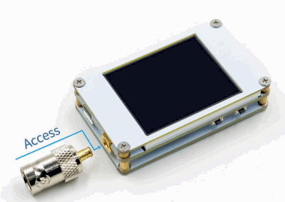

"the scope is DSO188."
DSO188, mostly $35-$47.
It may just be too small to set trigger mode, with human fingers....
Trigger mode: Auto
Size: 57 x 34 x 11 mm
Weight: 40 grams
Apparently it has a suspend button: "At any time, the waveform display (pause function) is frozen". If it then only displays the last trace it has captured, you may be able to see something that's too small to trigger on.
I don't think you stand much chance of seeing this on the scope you mention, but if it is audible then it should be pretty easy on a conventional scope of decent bandwidth if you handle the controls correctly.

"The capacitors in the 35th precinct are screaming..."There is a high pitched ringing (~15khz) coming from my system which seems to fluctuate in volume slightly, almost like tinnitus , which I assumed it was after checking on scope and seeing absolutely nothing.
But after checking more thoroughly it is definitely the system, test tones of any frequency show up clear as day, rapidly changing waveforms like music or noise still show up clearly even if the scope cant track them.
How could it be that this noise is not being picked up at all on the scope?
Also I could still hear the noise through the headphones as the scope was attached.
