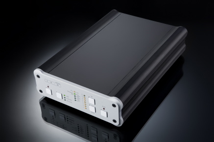

High performance DAC mDAC-2v(USB, Coaxial, Optical input)
High performance USB DAC come out...
Model : "mDAC-2v"
Key feature :
- Digital input USB, Coaxial, Optical
- Sampling rate
USB : 44.1KHz, 48KHz, 88.2KHz, 96KHz / 24Bit
Coaxial : 32KHz, 44.1KHz, 48KHz, 88.2KHz, 96KHz, 176.4KHz, 192KHz / 24Bit
Optical : 32KHz, 44.1KHz, 48KHz, 88.2KHz, 96KHz / 24Bit
- PLL based USB audio jitter cleaner
- True bit-transparent operation
- Fixed level & variable level output RCA jack (0dB ~ -55dB)
- THD+N : 0.00057%(1KHz, 44.1KHz, 0dB)
- Dynamic range : 116.6dB
- Output stage frequency response : 20 ~ 100KHz(-3dB)
- Cross talk : -125dB(1KHz), -112dB(20KHz), -105dB(80KHz)
- No AC-coupling capacitors in audio signal path
- USB only & External power operation
- Custom made ultra low noise regulator
- High quality audio grade component
www.sotm-audio.com
sotm@sotm-audio.com
Sorry! English home page is under construction... :D
