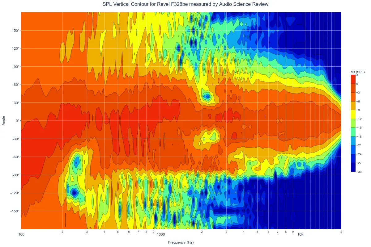

Hello All,
I have been reading along following this conversation about directivity.
Much, perhaps most of the thought process comes from the Harman research about listener preference in a standard listening room.

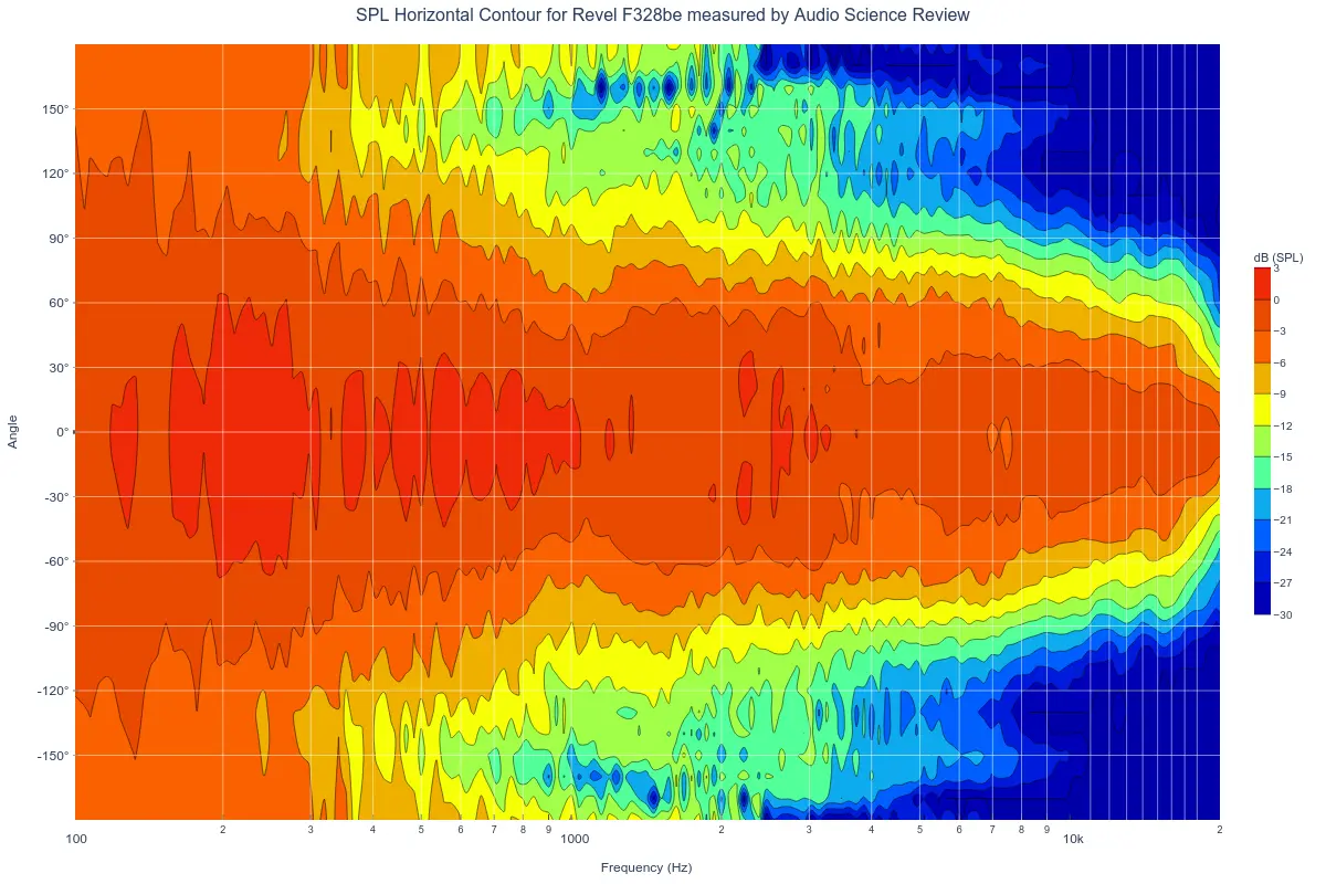

Using the Revel F328Be speaker as a sample, the drivers stairstep smaller in diameter and the woodwork is carved to effect a smooth continuous slightly increasing directivity Index. Get to the tweeter, then a waveguide is required to maintain the smooth continuous DI. Even then, the top
~octave begins to beam.
The directivity is held close to + / - 70 degrees for most of the BW of the speaker.
Is that + / - 70 degrees by design or is it the nature of cones and domes? You know, the best we can do?
Thanks DT
The F328Be doesn't have the front panel detailing that the Salon 2 has, as a result there is more effective flat baffle area. The DI is quite flat between 700 Hz and 7K, rising and falling at either end relatively quickly to give it an overall rising DI. The wider flat baffle area gives it the more constant directivity through the major frequency range. They may have chosen the dimensions to target that directivity but the outcome is a consequence of what happens with those size drivers in that configuration.
The best is dependant on a lot of factors but a speaker like that sounds good in many average size rooms at average listening distances across a wide range of genres. Average of course changes depending on which continent you are on, that has an effect on whether the speaker is too big, too small or just right.
The in room response is smoothly falling without any real peaks or dips, they get this from downsloping the on axis and listening window just a bit to offset the fairly constant directivity.
Can the “best we can do” directivity be determined from graphs/charts?
Versus
Versus
I’m not certain it can be…
One of the better tools that we have. Otherwise we are just waving our arms all around.

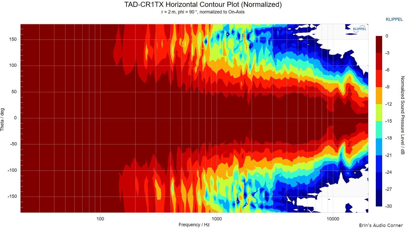

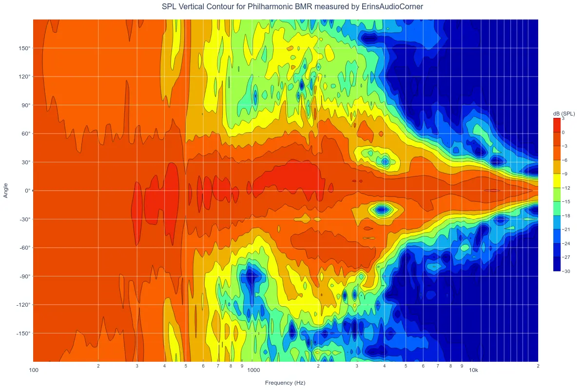

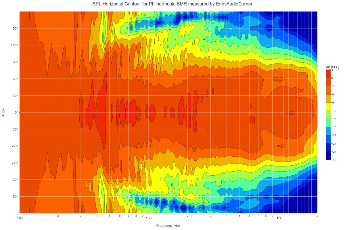

With modern off-axis data as spectrogram I look also beyond -3dB line (eg. -12dB) Deep waveguides and horns cast more sharp lined beam than open drivers.
Like this, cpmpare to shallow coaxial TAD in my previous post
or this small horn monitor

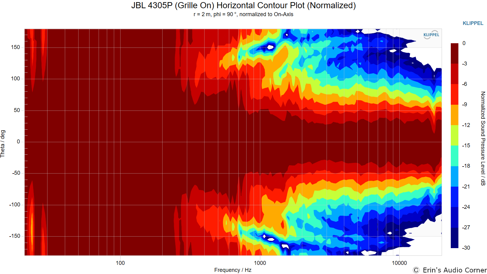

It is interesting to me that vast majority of home HI-FI speakers that we see data for, you know the cones and domes that we are talking about here have coverage in the + / - 60 to 70 degree range. I tend to think that the home listening spaces that most of us sit in are not too far removed from the Harman International Standard Room.

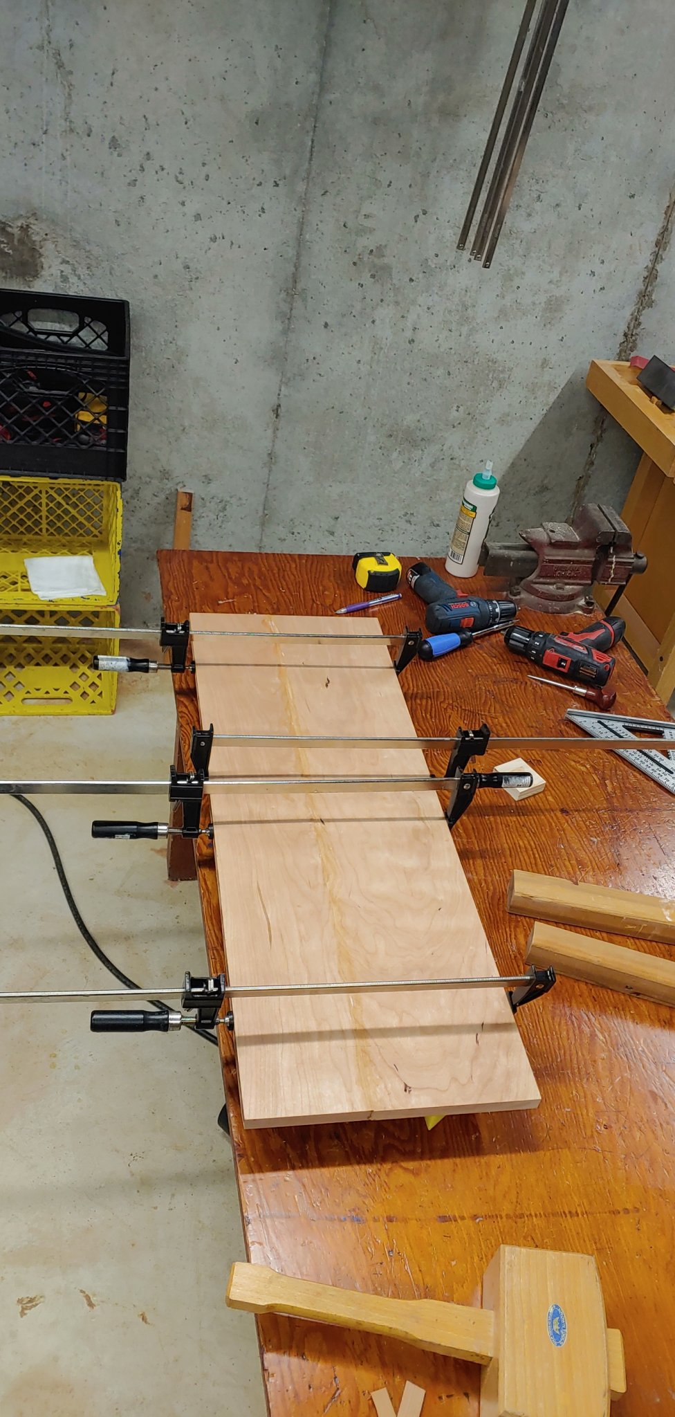

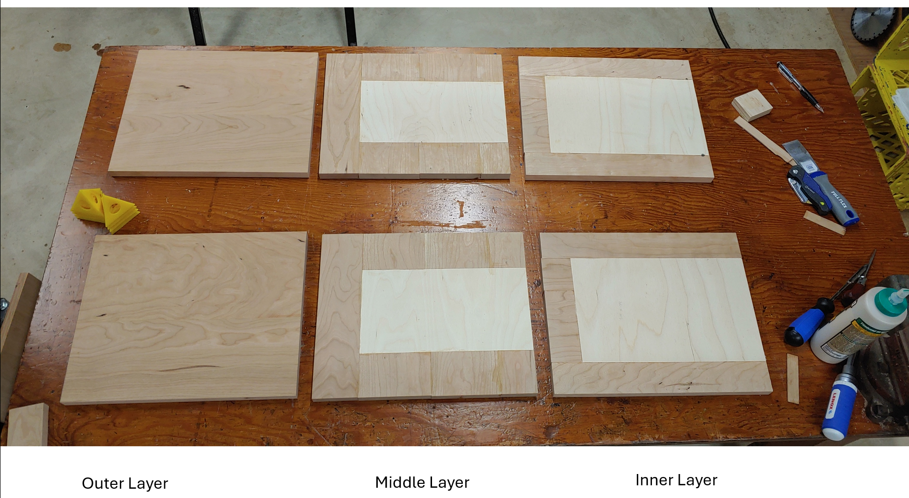

I have the laminated sections complete. There are three lamination layers in the midrange-tweeter baffle. The baffle is 350 mm H x 286 mm W.
The outermost layer is solid wood, with the grain oriented vertically. I glued two boards together to get the needed width.
The middle layer is composed of a Baltic birch plywood core that is 280 mm H x 146 mm W, bonded to a solid wood edging that is 70 mm wide. The solid wood has the grain oriented horizontally.
The innermost layer is composed of a BB plywood core that is 300 mm H x 186 mm W, bonded to a solid wood edging that is 50 mm wide. The solid wood of this layer is oriented vertically.
In order for this process to work, the solid wood must be planed to the same thickness as the plywood, which in this case was 17.9 mm. I used Titebond wood glue to bond the solid wood to the plywood cores, but I will use epoxy to bond the three layers together. The total thickness will be 54 mm.
If the weather is nice tomorrow, I will router the holes in each layer, including the recess in the outer layer. Then I will epoxy them together.
It feels good to make some progress.
