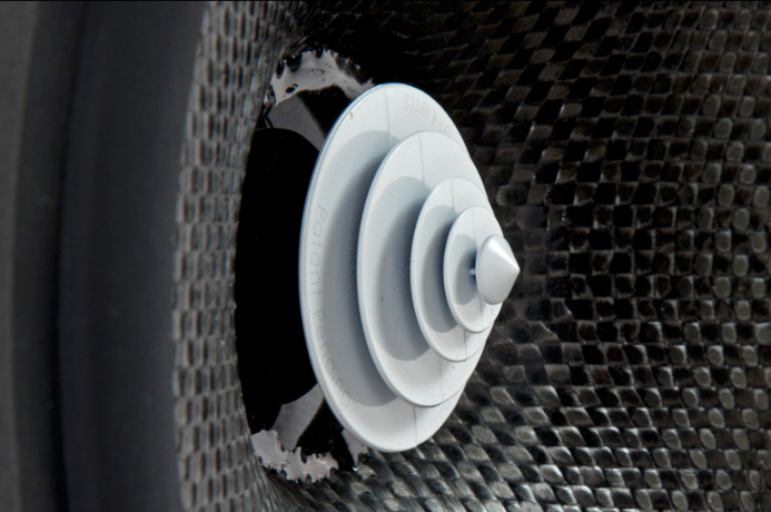

FYI AllenB. Here's an excerpt from Soundstage! HiFi's review of Reference 3A's MM de Capo BE:
"As I recall, the original MM had a carbon-fiber midrange-woofer, as does the new one, but this model’s cone looks a little different: at its center, in lieu of a dustcap, is an oddly shaped white object called a Surreal Acoustic Driver Lens. According to 3A, this “is used to prevent formation of air vortex’s generated by condensed air particles and turbulence in the deep center of loudspeaker driver cones. Inherent noise caused by this vortex is drastically reduced and is effectively diffused by the lens.” Interesting -- I’d never seen such a thing before. As always, no crossover is applied to the midrange-woofer, and only a single capacitor is used to roll off the tweeter’s low end."

This lens suggests an attempt to control the breakup region. I have not seen a demonstration. It claims to improve directivity. Then again it claims to be an aerodynamic improvement, not sure whether that is what I require in a cone.
Either way, using an electrical filter also deals with the breakup region and can do so effectively.

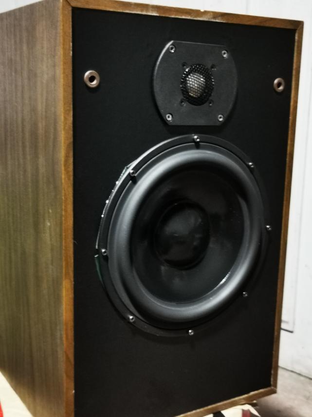

Hi everyone. Sorry this should have come first. I am pleased to report that my 2-way speaker project is finally a success after a month of planning and construction. As you know I tried to emulate Madisound's A26 kit but since I recently purchased a Thiel H1715 tweeter 92dB, a performer that exceeded my expectations, I had to go with it and find a partner.

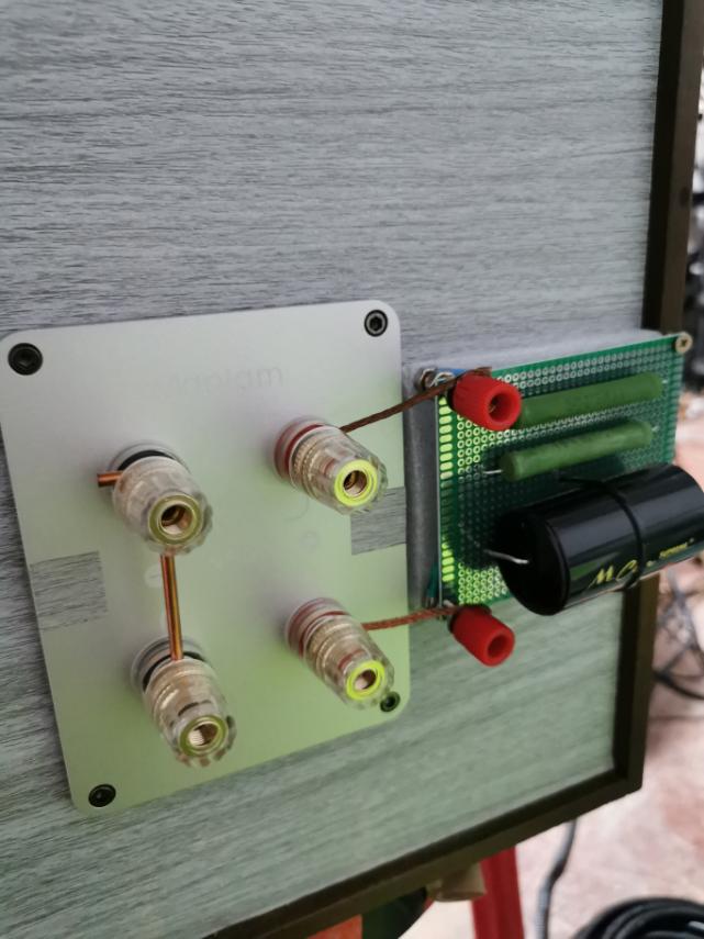

I had previously ordered the A26 Mundorf crossover set so again I had to use these somehow even if I hadn't decided on the woofer. I chose the Morel MW266 89dB. So I used the 3.3uF in series with 10+8.2 ohms to get an effective R of 24.2 ohms for Fc of around 2KHz.
Used Supra externally and internally. The toughest part was attaching the crossover directly to the binding posts internally. They were outside initially and used a copper braid to connect it. This sounded bad. Suspected it and moved it inside getting rid of it. Also used my extra Supra cable as jumper on negative binding post. And then...finally the open, transparent, and the wide range I had hoped were all there. Not worried about power handling at all. This Morel can take 1000W short term.
Thank you for your ideas and support. For the biggest fans of sophisticated crossovers I wonder if you've ever heard solutions from Lowther, Fostex, AER, Audio Nirvana, etc. They're even more extreme than I am.
