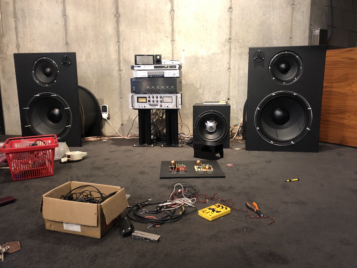

Attached image: "the night is young"...

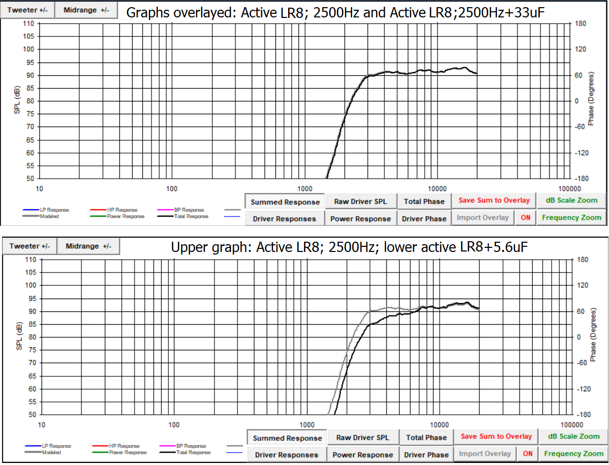

The protection against any AC voltage comes from a HP filter as long as it's working. This is a simulation of a real dome tweeter where one can exactly observe how combining active and passive filter affects frequency response.

The crossover you are using would be OK if you are prepared to work with what it is doing to get a total response that you can use. This is easier with some tools than others.
