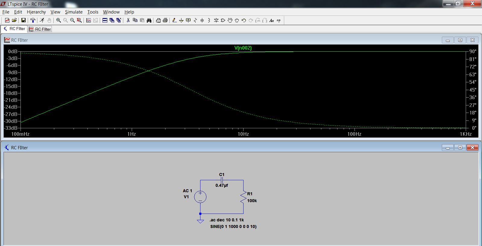

>My question is how do you determine the cut of frequency by adjusting the combination of R3 and C1?
Consider the opamp draws no current from its "+" input, thus you can do the calculation without the opamp, and it is a simple RC highpass. Pole is at frequency giving equal impedance to R and C.

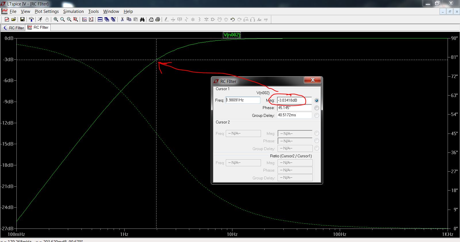

so if i have done the maths right then 100k resistor and a 0.47uf cap would work out to 29.5 ish htz

A 0.47uf cap with a 100K to ground forms a "first order" high pass filter. The "cut off" frequency is when the output voltage fall to 0.707 of the input voltage and is given by the formula in post #2
The 29.5Hz you worked out suggests a wrong decimal and you not taking the reciprocal of the calculation (dividing it into 1)

yes i was doing the maths wrong.
