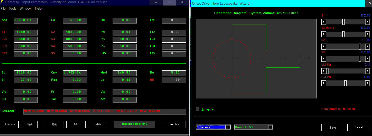

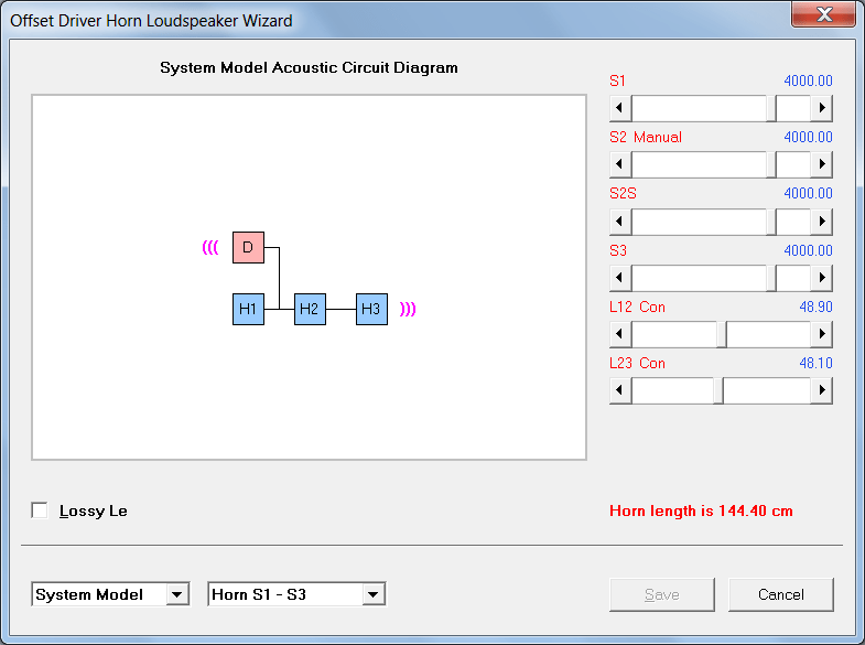

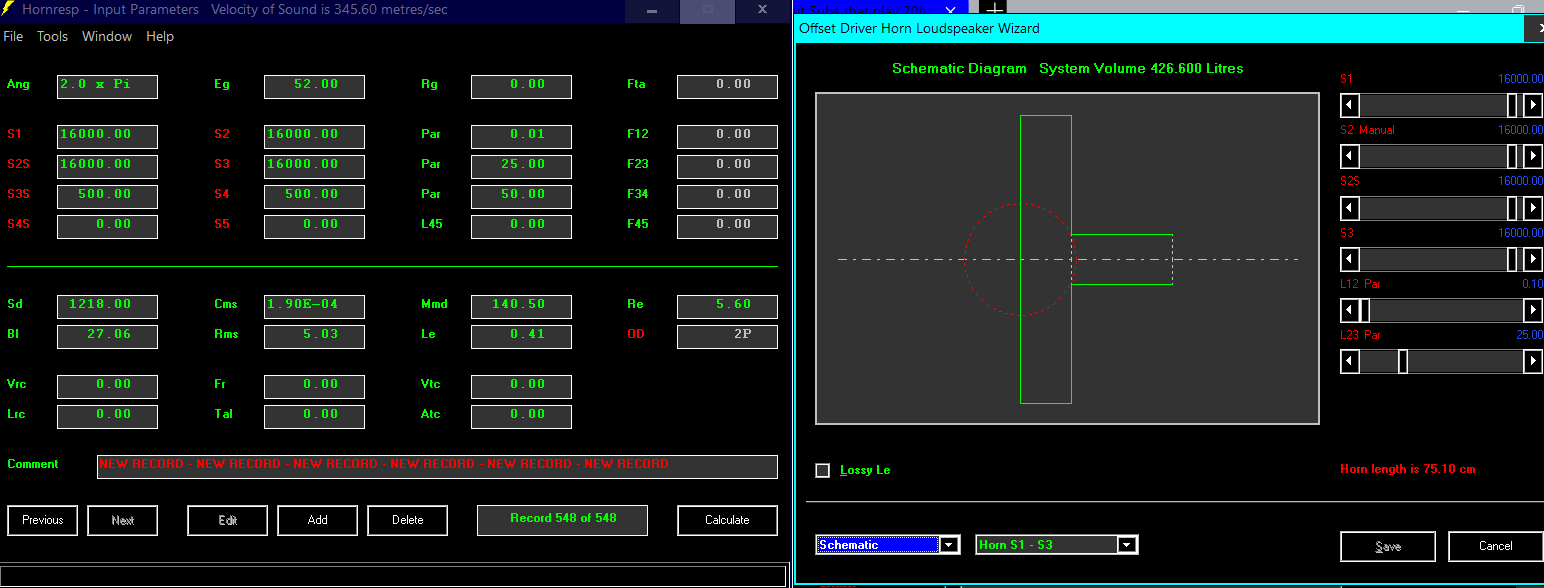

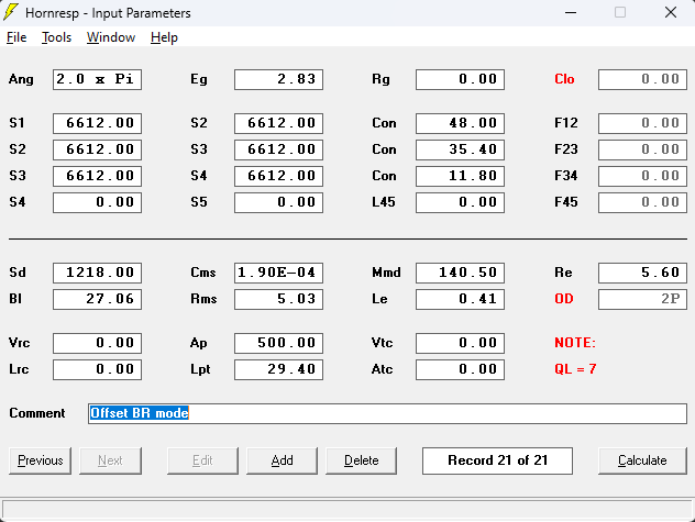

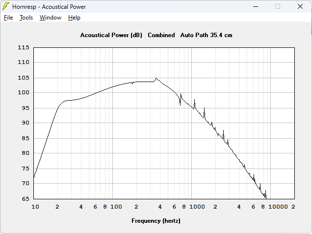

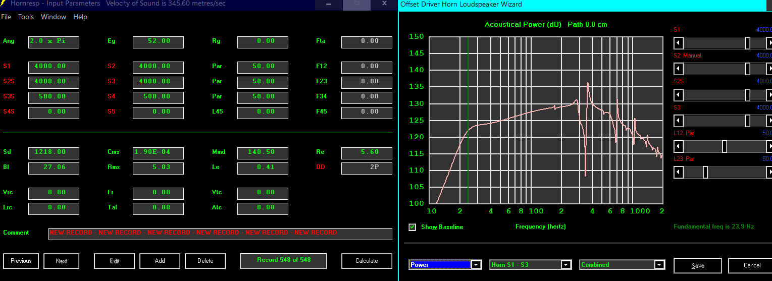

The pictured sim above is of an Offset TL mode, I wonder why I can't recreate this response in the Bass Reflex mode of HornResp, maybe I should ask @David McBean in his thread.
Like when you start at the input wizard, you get to chose different simulation templates where you could design very similar enclosures if not identical but result in different FR because of the aspects of simulation in the chosen mode.
You don't get to choose CSA in BR mode, it looks like it jsut centers the driver, so shouldn't it always be an offset BR?

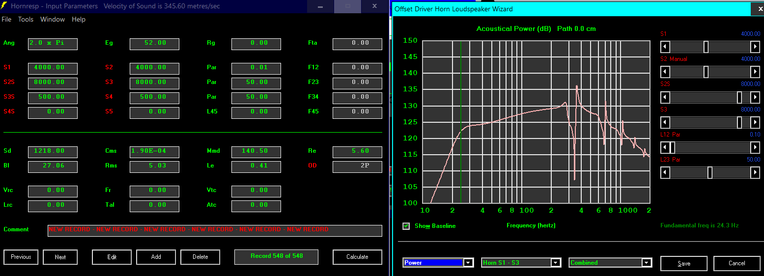

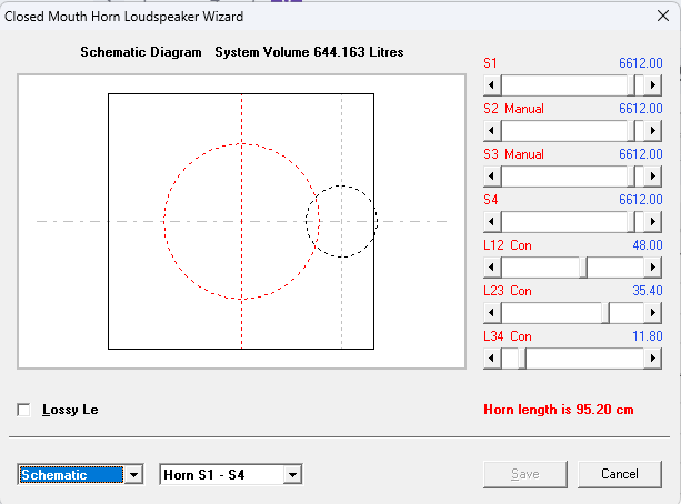

Oh, i see…. Yeah, definitely wanna pay attention to that ~48 cm (170 hz) 1/4 wave resonance if looking at the bandwidth up there

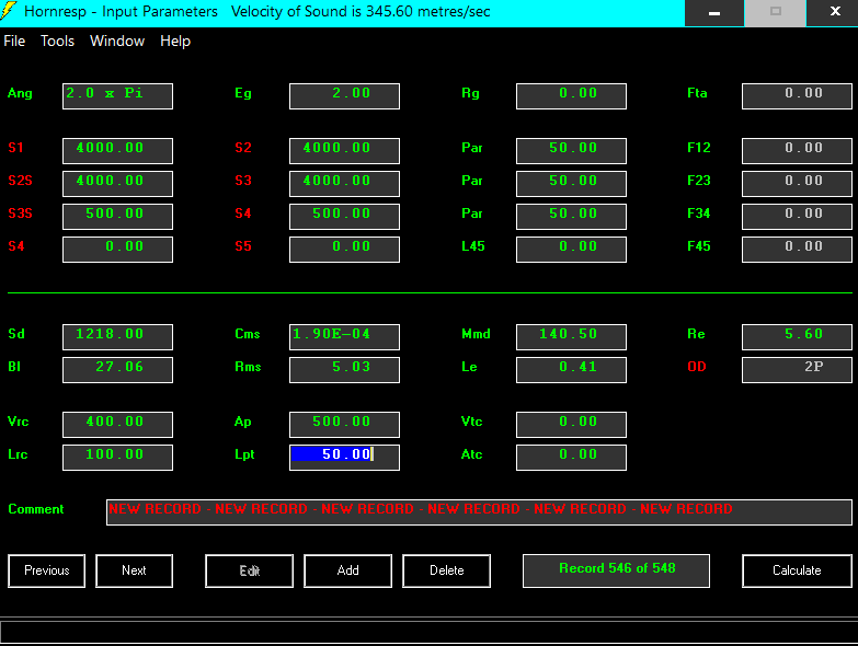

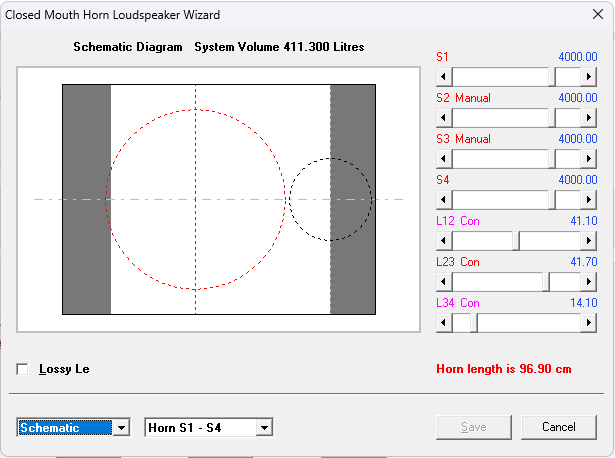

hover on LRc and adjust it to match the 4000 cm2 . it still puts the driver at the ‘closed’ end of the box/port though ..
sure would be intersting to know how horn response knows where all those 1/3,1/5,1/7…. Harmonics are and how to show us that placing the driver on one of them doesn’t allow it to get excited. i wonder if there’s software to design musical instruments in this way? Or antenas?

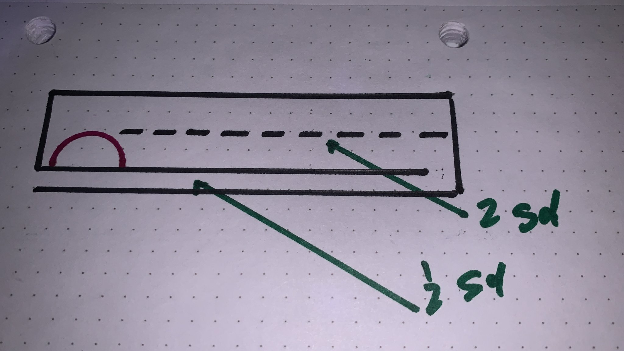

keep going......? This one is probably so long and skinny, its creating two offset stubs in the opposing directions (in reality)?

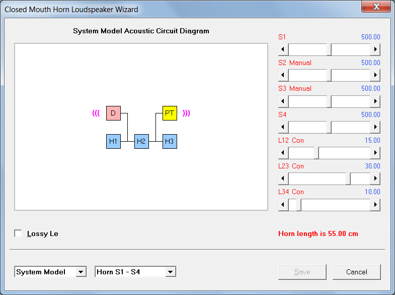

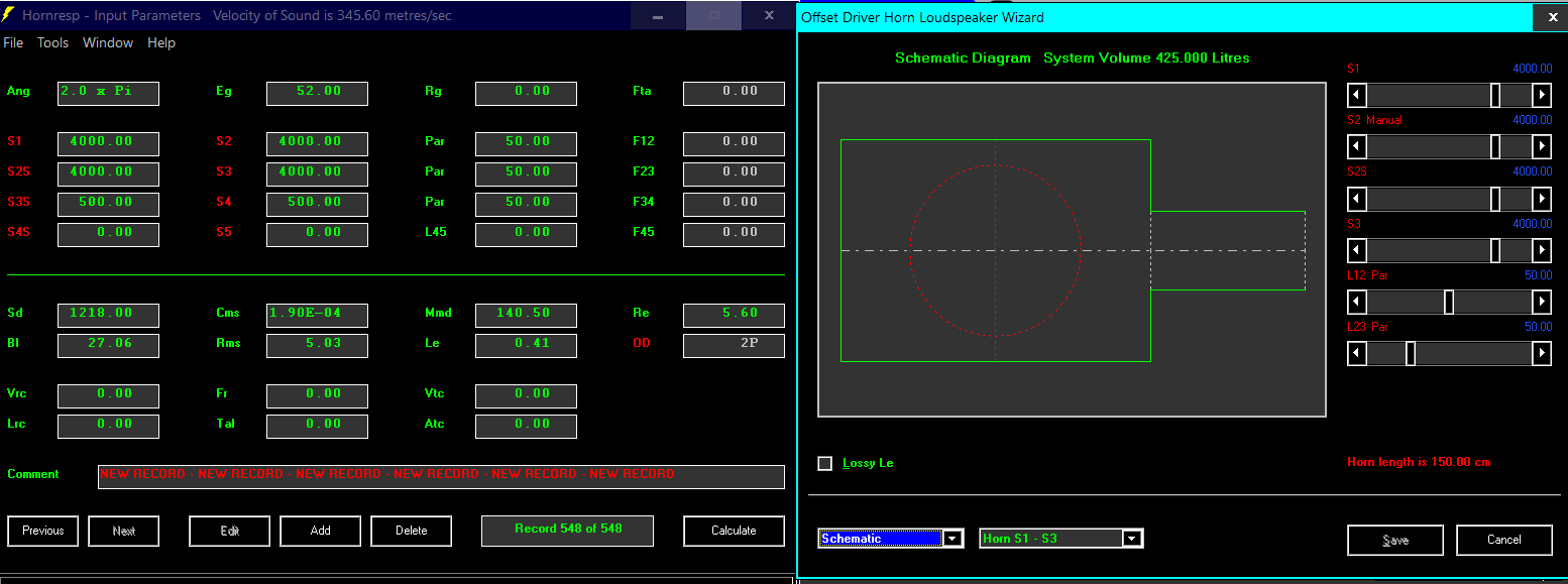

The topologies are quite different -
YOUR OFFSET TL DESIGN:

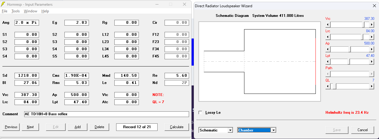

NORMAL BASS REFLEX:

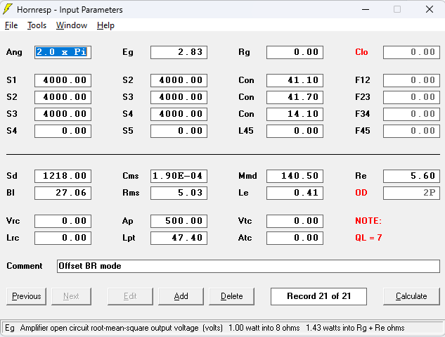

OFFSET BASS REFLEX:
Which topology should I follow? Looks like the closed mouth horn has all the components...The topologies are quite different

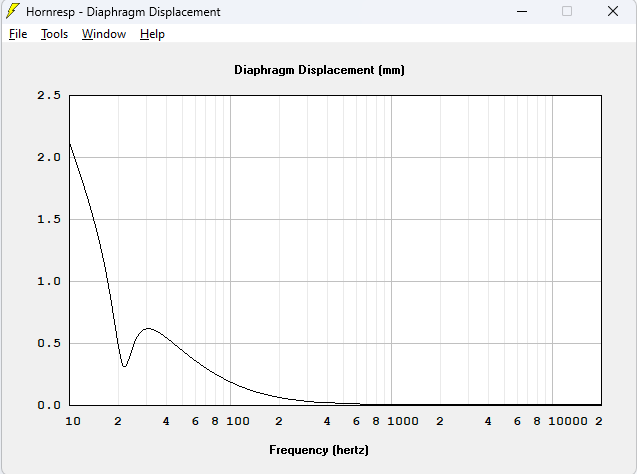

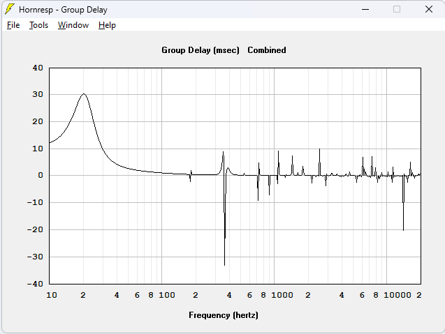

This is a representative rough of what I would be building if I did build a BR. I would stack the 18"s vertically. If you wanted to cross at 200hz you live with Ctc flaw that lives briefly towards the top of the register, maybe above 178hz or so... or you could use a passive XO on the lower woofer. Both scenarios allow you cover sub bass to a 200hz xo, while using one Amp and one DSP channel accept there would be some type of flaw from 178hz-300hz regarding time alignment and directivity, though it may not be a large or noticeable one. I am considering the latter using a passive XO but I have no idea how realistic a high power passive low pass is. This enclosure would be about 37.5 inches tall and I'd have to find a way to place the BR ports out of the way. Tuning to ~22hz It keeps group delay down to 10ms at 30hz. The alternative would be to tune to 25hz for cinema or 30hz for music. Theres no damping in this sim, I feel that getting the best response without damping is important. Adding damping in the actual build will only add to SQ of your already acceptable FR. My take on this build is a box thats 37.5 inches tall, with barely enough room to fit the stacked 18's and 31.5 inches long, 32.5 inches wide.
Not possible unless the port is rear exit. The bottom driver and port cannot overlap in the same area if the port has a front exit. Looks like the port is outside the enclosure too.
I look at it as an acoustical center, I would use a slot, not a round port, acoustically centered to mimic the sim. The port seems to not make much of a difference anyway. I am interested to figure out what @b_force was talking about, dealing with cab internal dimensions? Maybe he was suggesting to break up the internal volume to avoid resonance?
