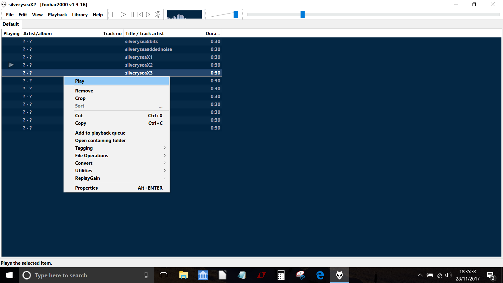

I'll pm you shortly with my findings. I didn't use an ABX routine but just listened to each. I wonder if the concentration wavers because I had 3 attempts and all were similar for the first 6 or so... and so I had a final attempt.
I have just tried an ABX with the two master files and seem to be able to get a reliable result.
For anyone following this I flunked the identification of the 10 random files getting just 4 out of 10 correct. I didn't ABX those but tried to rely on audible memory. Interesting 🙂
