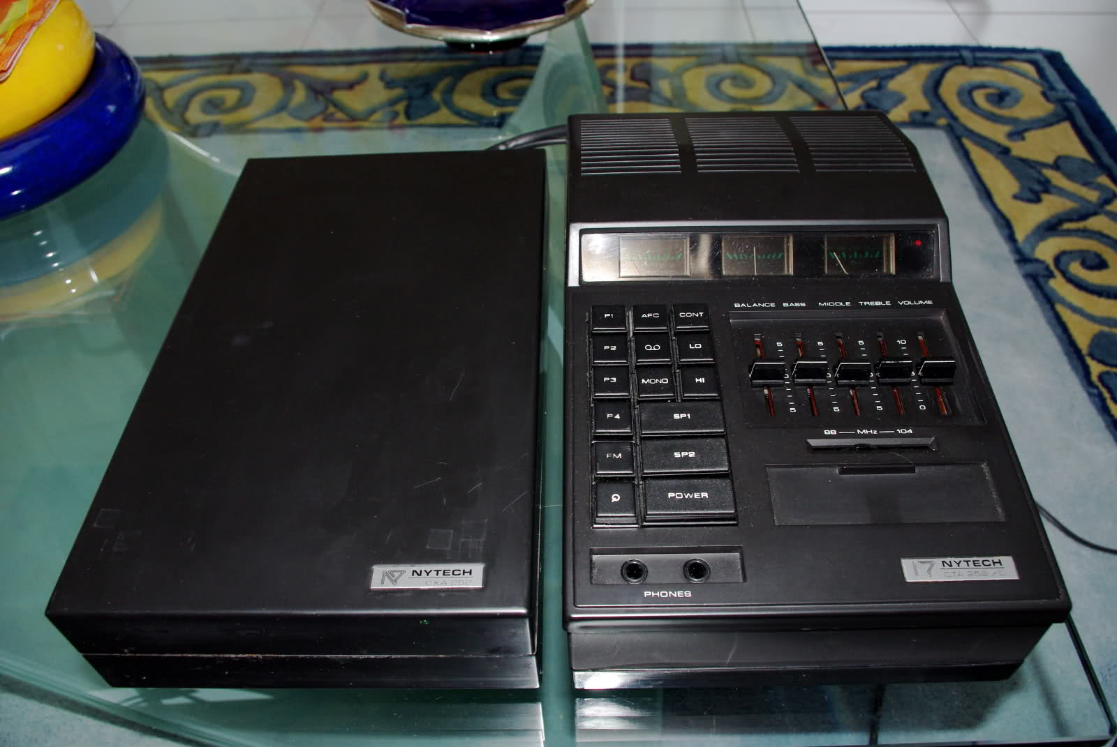

Sorry I did not make it clear. What I meant was the phono stage was good until recently. Now, the high is missing, sounded soft and muddy each time I play the turntable and not gradually over an extended period of listening.
There are only 3 electrolytic capacitors in the phono card. That is the reason why I am attempting to just change the 3 capacitors and hopefully the problem solved.
What is tantalums capacitors that you suggest I should also replace? Are you referring to the two red capacitors, or the two smaller brown capacitors with black insulation on their leads? I have no schematic so have difficulties finding the specifications of the capacitors.
The tantalums are the four (as you say red and brown) caps. The values will be printed on them along with the voltage. Logically, if both channels exhibit this soft muddy sound then I wouldn't immediately suspect those caps because a failure of one would only affect the channel that particular cap were in. There is nothing lost in replacing though as its literally a few minutes work.

May I know is the single (the bigger of the 3 caps) electrolytic capacitor (1000uf 10 volts) affects the PSU of the phono stage? If so, this cap should affect both channels if it is the problem. In another word, this cap is more likely the cause of the problem as compared with other caps.
The 1000uf is almost certainly just across the voltage supply to the phono board and so is common to both channels.

Could I use a 2200 uf 63v in place of the 1000 uf 10v cap for the PSU phono stage? I happen to have spare for this cap. How will it affects the phono stage?
HOLD ON A MINUTE!
There is something very wrong here!
Before you go swapping caps willy-nilly, never a good idea, further info is needed.
The photos of that pcb do not show any RIAA shaping network. Apart from the tantalum beads and electros, which are NOT used for FR shaping, there do not seem to be any other caps, apart for a few pF ceramic across the inputs.
As the more experienced of us know, caps on the rail do not have a first order effect on the frequency response so I strongly suggest you do not get diverted swapping these about.
Are you sure this is an RIAA MM pcb? How do you know?
More pics of the inside please, That looks like a buffer stage or a gain stage. There will be additional circuitry.

Yes you can but as others point out I doubt this is going to fix your problem. As I mentioned... and failure of a cap in any one channel won't affect the sound from the other.
Could that board be an MC front end ?
