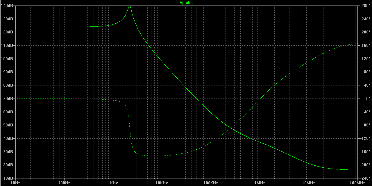

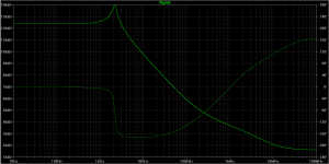

Walt Jung has long been an advocate of 2 op amp (or op amp + buffer) composite circuits and points out their advantages – check his web site; “Op amp Audio” series
Gerald Graeme has also advocated 2 op amp composite amplifier, with high loop gain from 2 pole responses – “Amplifier Applications of Op Amps” 1999 devotes a chapter to composite op amp circuits and their compensation
This sim circuit topology is close to circuits I have built and I have verified that they can achieve measured 1KHz harmonic distortion (and 1KHz IMD from 1:1 10KHz + 11KHz) below my 160dB instrumentation limit
Composite amplifiers can reduce active device contributions to audio frequency distortion to unmeasurable levels (1 V input, 20 KHz sim results: )
The output op amp is a modified integrator that provides large audio frequency gain, those in the know will object that the loop phase response, which exceeds 180 degrees around 100 KHz invites oscillation or poor recovery from clipping
(the Loop Gain Probe is available from the LtSpice Yahoo group files area - just cut it out and delete .prams lines if you don't want to use it)
The clipping response is greatly improved by the symmetrical clamping diode bridge that holds the input op amp to +/- 1 V output when the output op amp saturates, this means that the input op amp is held in its linear operating region, its contribution to loop gain and phase shift is minimized, and its output only has to slew ~ 1V to when recovering from saturation ((1.6 V @ 20 KHz input, V(n005) is Lt1022 output)
Simple back-to-back diodes would also provide for the improved clipping response, but the bridge reduces diode capacitance and nonlinear conduction current that add directly to the feedback error voltage and cause nonlinear distortion
(distortion and phase margin # may be off slightly, I plotted those with all 1N418 diodes before it occurred to me to reduce clamp voltage with Schottkys, this means diode feedthru may be slightly higher due to higher capacitance form lower reverse bias on D1,2)

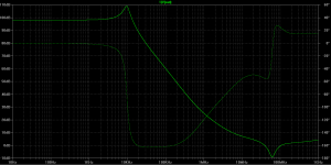

I have been playing for several years with power supply bootstrapped op amp circuits
One previously known composite op amp with power supply bootstrapping showing loop gain enhancement from the bootstrapping of the internal voltage gain stage is from Mohapatra and Sandman’ 1980 GB patent
The sim shows Mohapatra&Sandman’s topology with the OPA227 model, I call this a feedforward bootstrap topology
The loop gain is substantially boosted by the bootstrap connection when the load impedance Rload is high
Because the OPA227 is in series with the bootstrap amp there is no improvement in its output impedance so you can see the gain boost disappears with heavier loading
The “loop error” I’ve plotted (in green) is essentially the inverse of the loop gain – at 10 KHz with the high load impedance you can see 100 dB loop gain => 1 GHz “GBW”

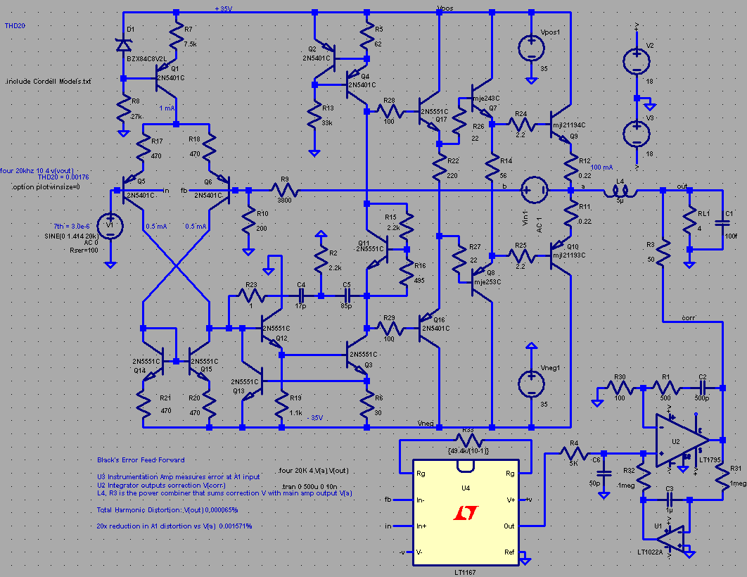

Black's Error Feedforward is a Composite amp too - is sub ppm good enough?
I grabbed Bob's example sim from the TPC/TMC debate in the Cordell Book thread http://www.diyaudio.com/forums/soli...lls-power-amplifier-book-119.html#post2413197
my poking at it seems to indicate that the distortion is limited by the slow output Q and simply can't be made much better by feedback - especially the THD 20KHz that Bob likes as a simple quality metric (at least without going deep into conditional stability territory with 3-rd order or higher loop gain schemes)
if you can't fix up a amp with more feedback then the other tool is Black's Error Feedforward - rare in audio because of the difficulties power output combiner but famous none the less due to Quad’s "Current Dumping" amplifier
a error feedforward amp is defined by having 2 independent power amp paths to control the output - and the consequent difficulty of combining the outputs without their mutual loading causing unwanted additional (destabilizing) feedback
The VanderKooy Lipshitz Error Feedforward paper http://quad405.com/jaes.pdf shows several schemes - "Current Dumping" actually wraps negative feedback around the "dumper" amp stage - but 2 other schemes are shown - I chose the Parallel Feedforward from their fig 4b - which doesn't intentionally add loop feedback to the main amp and the coupling through the output impedances of the amps is minimal when used with a frequency selective power combiner

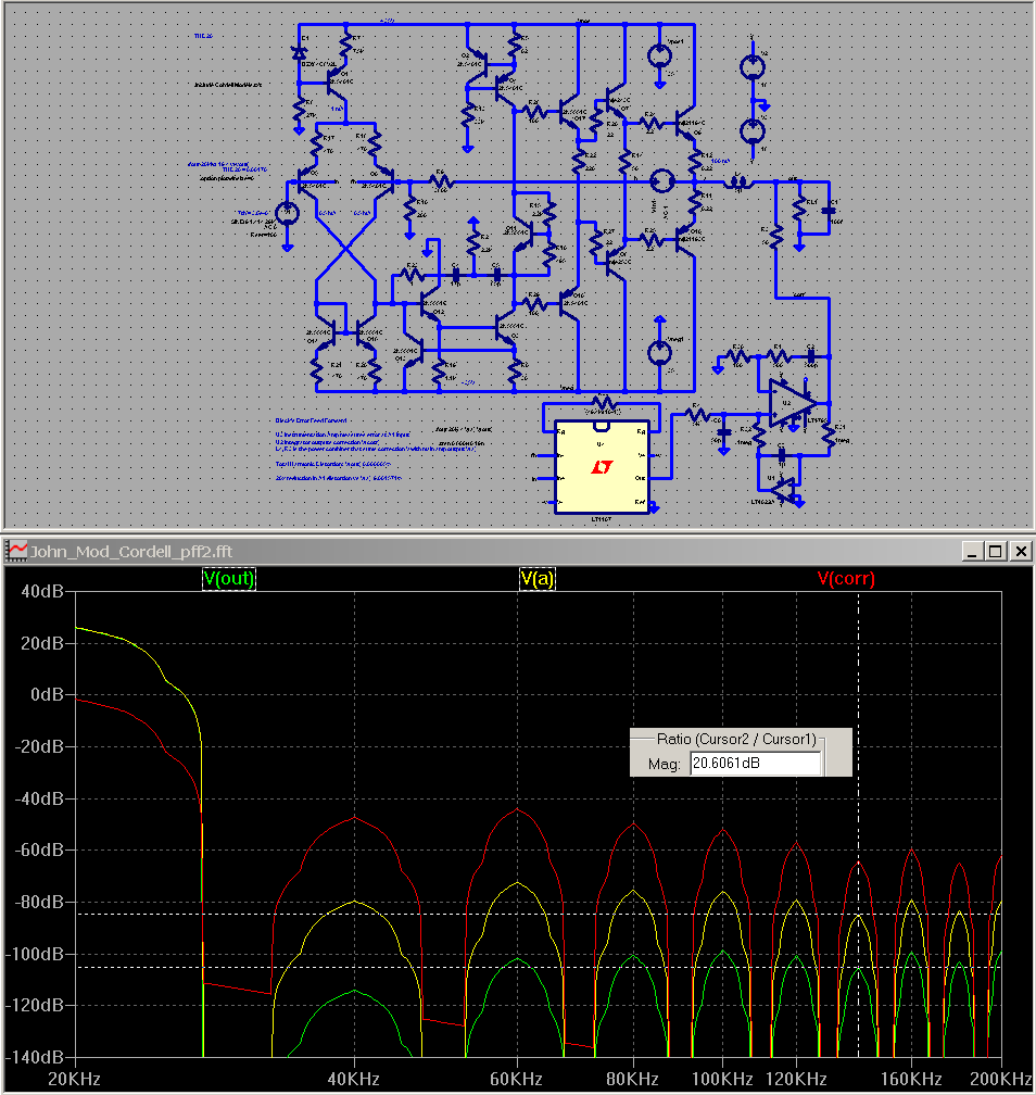

so the following is a Composite Amp using a large, slow discrete amp and a fast error feedforward op amp path
the instrumentation op amp measures the error at the diff pair input of the main amp with a gain of 10x, and then the CFA DSL driver op amp integrator provides the required error correction V drive for the Resistive leg of the L,R power output combiner network
Bob's THD 20KHz number is improved by ~20x in this sim
you will need Bob's zip file and to put my asc in the same folder with Bob's Cordell Models.txt file or you can download Bob's transistor models from his

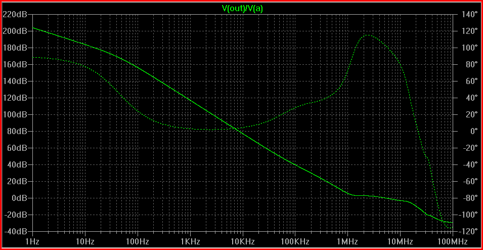

2 poles, 2 zeros, lots of gain... yawn

you mean something with a loop gain curve as complicated as this?
the "upper bode step" comes from the 2-pole T network feedforward around a slower level shift stage interaction with the combining network to drive the output Q
the point-to-point prototype built with slower parts shows good agreement with its sim, but isn't as tightly "tuned" as the sim the plot below comes from - time to start re-learning Eagle...
rh poles, zeros, aren't usually "desired" parts of a design - but may be consequences of other choices with desired benefits – sometimes you just have to work with them for the other benefits - think of designing around them as "learning opportunities"
