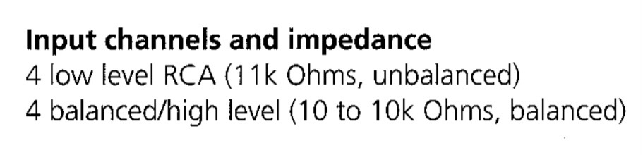

Hello, I’m planing to convert my system to be active.
My current system:
CD tranporter —> Integrated amp with built-in DAC —> Speakers.
The active system:
CD tranporter —> Integrated amp with built-in DAC —> Active crossover —> Power amp —> Speakers.
Since my integrated amplifier has no pre-out/main-in channels, I need to use speaker outputs to feed signal to the active crossover instead. According to the attached spec of the active crossover, there are four “high-level” inputs with impedance in each channel of 10-10k Ohms, my questions are whether the 10-10k Ohms is the impedance load presented to integrated amplifier? If yes, should I connect all four inputs or simply connect only two channels, the amplifier is two channels stereo? To my understanding, connecting all four inputs will halve the impedance i.e. 10-10k to 5-5k Ohms on each channel, am I correct? Last question, the integrated amplifier is rated at 100 Wpc, will it detrimental to the electronic crossover?

That actually won't do a thing. The maximum output voltage of a 100W amp is around 28V, or around 30dB higher than 0dBV. So...you might need an attenuator. How much attenuation? Need the full specs on your crossover first, a make/model would be nice. The posted specs make no sense. But in general, you only need to drive one pair of its inputs, not all of them.

The crossover is a/d/s/ 642ix. And the integrated amp is Sansui AU-X911DG.

The crossover you're trying to use was designed for the mobile market. It is missing nearly every control that would make tuning an active crossover possible. The frequency and slope of the crossover filters are fixed by "modules" that apparently are swappable, but not tuneable. In the world of optimizing active crossovers, this is like having two hands tied behind your back while blindfolded, in that the chances of any of the pre-set curves and tunings being right are minimal at best.
The next problem is interfacing your integrated amp to the crossover. The mobile crossover was intended to work with a "head unit", probably of limited power (since it assumes power amps follow the crossover). While power is not the problem here, the output voltage of your amp will be. The maximum output voltage from a head unit, with no external power amp, will likely be around 9 or 10 volts (rms), differential. Your 100W integrated will produce around 28Vrms, single-ended. To get that to play well with the crossover you need to first adjust the balanced input controls to their minimum setting. This may be adequate, but it might still be possible for your integrated amp to over-drive the crossover. You'll just have to try it, you will not blow anything up doing so. But if you get distortion from the crossover, you'll need to pad the crossover's input by around 10dB so the crossover input doesn't clip.
