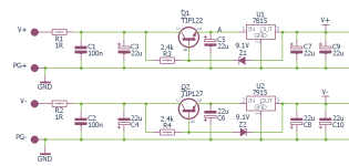

I need some advice how to increase input voltage in LDO? Input voltage will be double +-50V. I need to build psu for preamp. So L7815CV; L7915CV max input 34V so it will fail.
I found circuit, I think its good idea, but I wanna use transistors BD139 & BD140 instead mosfets. Can someone help me and draw circuit? Resistor values etc. Zener I will choose 24V

With 50V in and 15V out you do not need an LDO so you can use anything.
Jan, you are absolutely right. There are many people, even professional electronic design engineers, who don't seem to remember that LDO is not a generic term for a series regulator, but an abbreviation of low drop-out.

It can be anything you want. My advice would still be an LM337 and LM117 with say +/-30V out, followed by a 78xx and 79xx.
Remember that the 40V max for the '337 is between input and output. With 50V in and 30V out that's just 20V I/O difference. *
Only needs a protection zener for the start-up phase.
The beauty is that you can spread that 7W across 2 devices.
Take a look at the typical circuits in the data sheets and come back with a circuit we can take a look at.

You can cascode ordinary three-pin regulators with transistors like this:
This is much simpler than a DC-DC converter and better than zeners in series with the raw supply (three-pin regulators tend to perform better when the voltage across them is fixed). You can vary the zener's voltage (choose the resistors accordingly) to adjust the split of power dissipation between the transistor and the regulator. Depending on that split, either or both of the transistor and the regulator would need to be heatsinked - (50V-15V)×0.2A=7W total dissipation per rail requires a sizable heatsink. If most of the dissipation is given the the transistor, it makes sense to bolt the regulator to the same heatsink - in case of over-temperature, its internal protection will shut down the whole thing.
Also, the input filter resistor can be large - it will dissipate part of the heat and will add some filtering, too.
