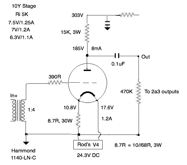

Attached the circuit that the PSU is feeding. A laboratory rat is a great activity - I'd enjoy it!I'm exactly the opposite. No musically trained but Electronic Engineer and I consider myself as a laboratory rat.

A tube stage is no good to me if it doesn't sound right, so I do a lot of building and listening. What I'm hearing is that the smaller the capacitor value above a respectable size, the more lively and realistic the sound. This seems to go against the theory that big capacitors are better. So why could that be? Can you find any theoretical reasons?
what is the meaning of "respectable size"?the smaller the capacitor value above a respectable size
Very good question - that's exactly what I'm trying to find out.what is the meaning of "respectable size"?
What are the values of the plate loading and decoupling resistors and capacitors in the sketch at post #22?
They are not active - I should have deleted them. The PSU in post 18 feeds the anode resistor directly.What are the values of the plate loading and decoupling resistors and capacitors in the sketch at post #22?
