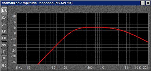

high frequency response in box?
am I right that box simulators (working based on T&S parameters) do the calculation for the low frequency response but have nothing to do with the high frequency roll-off but the measured response curve (given e.g. on the data sheet) is to consider here?
I'm asking this because in simulator BassBox Pro high frequency roll-off is also calculated and it differs a lot from the measured values stated on the data sheet (roll-off starts at much lower freq. according to the simulation) so I got a bit confused if box influences high freq response, too or the low one only?
Thank you!
Péter

It is actually clear that what simulators calculating only based on T&S parameters are not correct for high freq roll-off but for low freq response only hence their results for high freq roll-off can be disregarded and datasheet response curve can be considered as a basis plus other simulators or methods can be used for more precise calculations of the high freq response of a woofer or mid range speaker. Is this correct?

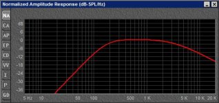

Just as an example attaching the simulation results done by BassBox and the factory datasheet of the same mid range speaker where simulator showed roll-off much earlier (only T&S and electrical parameters were used) - simulator result is not correct because of the above, right?
Thank you once more also for the additional design softwares!
Péter

Dear Allen,
this is exactly what is strange for me: correcting simulated response by measured values (which is indeed possible in BassBox) was switched off and I got the result uploaded beside this condition. So, the high freq roll-off (which is much earlier than reported by the measurements) is purely coming from the simulation w/o any correction by measured data. This is why I'm confused: does this mean that the box influences high freq response, too (simulation is correct and has to be considered in this case) or this comes from some improper simulation which delivers incorrect results for the high freq roll-off which can be disregarded and the measured values can be used instead while simulation results are relevant for the low frequency only?
Thank you,
Péter

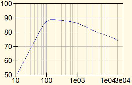

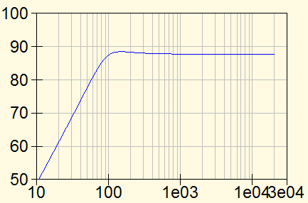

you say it is coming from electrical parameters and that it is "theoretical" so this means that it is not necessarily there in the reality?
Here is the simulated response of a 5" woofer in a sealed box (7.7L) with and without the actual measured inductance factored in. The actual measured frequency response is reasonably flat until 10kHz.
I don't know what you are stuck on. The assumptions made in making a T/S modeler are such that it is not valid at high frequencies.

I think I got it finally - what sim (e.g. BassBox) takes into account is the effect of the electrical parameters but doesn't do it with other contributors like break up thus it reports roll off at significantly lower frequencies than measuremenst published by e.g. the manufacturer of the speaker (typically measured in standard IEC board). Measurement incorporates all the effects by nature thus it gives the real response at higher frequences not the simulation (only sorrounding electrical parameters like that of the amp can have an effect on it but not the box itself).

One more comment for the above: I made a try and set the inductance parameter of the speaker to 0 mH and BassBox calculated infinite high freq response so no roll off at all thus now I'm convinced that as it was guessed it calculated it based on the electrical parameters only but nothing t do with the box itself.
Péter
I agree wholeheartedly with TMM and AllenB. Regarding BassBoxPro, it simulates HF roll-off using ONLY the voice coil inductance. I've always wondered why they didn't include diaphragm mass as that's calculated in the parameters.
