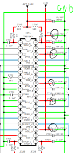

The supply comes from the SMPS board to the main board through CN61 (see filtering_1.png).
->Now on the schematics, I can see some small filtering cap at the entry on the board (see filtering_1.png), and some other at the digital amp chip (see filtering_2.png). The electrolytics are good (there are one per channel of 3300) and the little ones are film caps, nicely soldered.
So I guess all caps are good doing their job
-> Now, I see inductance in serie with the outputs, but both right and left channels of both A and B speaker output are noisy so I don't suspect a problem in a particular component bur rather in the supply.

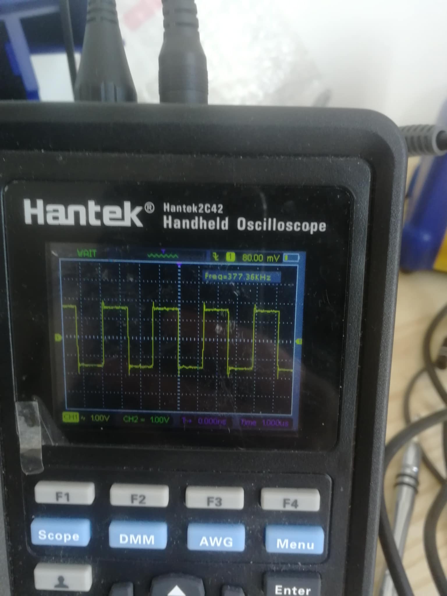

I've been measuring the input of the digital amplifier with no input in the amplifier. I got this at steady state :
So there is an input with the roughly the same frequency as my noise ! I am not well acquainted with digital amplifier, am I supposed to have this input from the PWM generator chip even with no signal ?
Also, with volume at 0, the noise disappears.

It’s a little hard to read, but I think I saw 408kHz in one of the scope shots. That is almost certainly the modulation frequency of the Class D amplifier. It’s impossible to completely filter it out, so it’s normal to see some residual noise across a resistive load. The inductance of the speaker will filter out even more, so it’s inaudible and harmless to the speaker.
