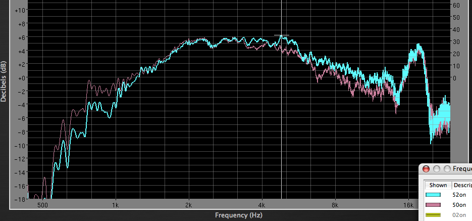

Thats an amazing report! It looks like the BMS 4550 is a little bit more powerful than the BMS 4552 in the lowest part of the pass-band. For a Unity/Synergy horn, with a 4th-order effective high-pass (and 10-15dB of padding due to EQ) at 1200hz, and judging from all your measurements and listening, would there be much of a performance difference between the two drivers?
All the graphs I've seen make the 52ND look a little "smoother" than the 50. Does it sound a little smoother?
Keto,
The difference in “smoothness” is quite little as you can see in post #33, the 4552 having a slight peak around 5000 Hz, the 4550 two small dips around 6500 and 8500.
It could be argued that the 4550, with lower and upper response more equal in level, is “smoother “ than the 4552.
The recordings were posted for you to listen to and make your own decisions, please share which sounds “smoother” to you.
Art
