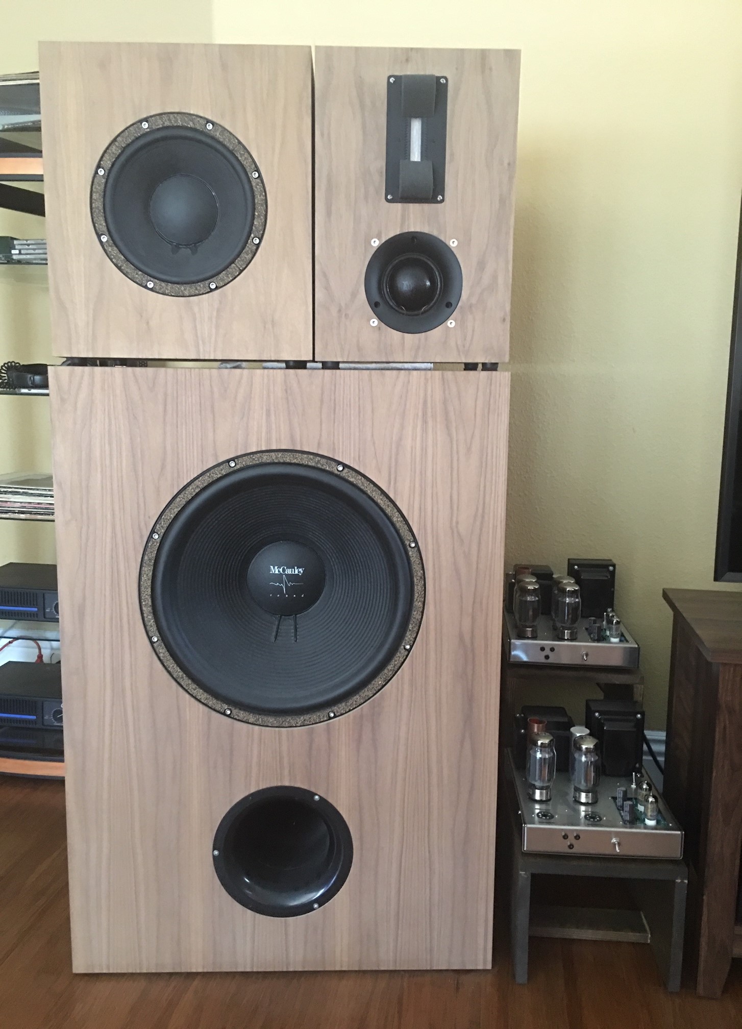

Hi, first I want to thank the forum for the great expertise and collaboration that provides to DIY Hifi enthusiasts like myself. Second, I want to explain my system and try to get answers and feedback to my questions.
I am new to the forum however, I have been experimenting with hifi sound systems for many years. My system is 4-way with active crossover and comprises of the following:
• 2 McCauley 6174 subwoofer drivers in individual vented boxes (13.15 ft3 or 372.4 liters) tuned to 20Hz driven by a professional Carvin DCM2500 amplifier.
• 2 McCauley 6224 woofer drivers in individual seal boxes (1.337 ft3 or 37.9 liters) each driven by its own VTA M-125 Monoblock tube amplifier.
• 2 ATC SB75-150 mid drivers in the same box as the tweeters driven by its own VTA M-125 Monoblock tube amplifier.
• 2 tweeters RAAL 140-15D driven by professional Carvin DCM600 amplifier.
• NAD Preamplifier C 160.
• NAD CD player C 521i and a Linn LP12 turntable (almost ready with Audio Technica MC cartridge and step-up transformer).
• A Rane AC24 active crossover (4 way) driving all power amplifiers.
This system, although not complete in terms of upgrading amplification, sounds good (relative term) to my ears. I can clearly distinguish each musical instrument and I must admit that the mids and highs have some of the best fidelity I have heard comparing to systems that cost much more $. In addition, the 6174s from McCauley are monsters when it comes to low frequencies generation.
My issue is the bass guitar does not sound as live and as high fidelity as I expected. I think that the 6224 McCauley’s should sound more realistic and defined.
My question is what is the best (relative term) hifi 8”, 10” or 12” driver for the frequencies of 80Hz or 100Hz to 800 Hz. The crossover points in my system are 100Hz, 800Hz and 3,200Hz. Thank you in advance for your feedback.

My recommendation, before swapping out drivers, would be to do some measurements and figure out what the problem is or might be.
For instance, it looks like your crossover is analogue, so how have you approached time alignment?
How does the sealed box rolloff stack up with the electrical slope of the active crossover?
You get the idea.
It's possible that your lower-mid driver isn't integrating well with the other drivers, and some playing around with the crossover will fix that.
If not, you can use the measurement equipment to get the next driver dialled in.
FWIW, in the HiFi driver arena I'd look at the Seas metal cone units. If you fancy PA drivers, the Faital Pro 10FH520 is very good.
