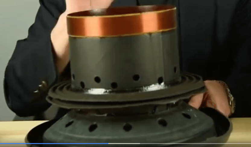

" Dont you know there is dual spider drivers with 60 to 70 mm Xmax these days "

If you really need that much excursion , just use 2 drivers
Less than half that, on a good day.
"78mm peak to peak Xmech excursion (65mm Xmax)"

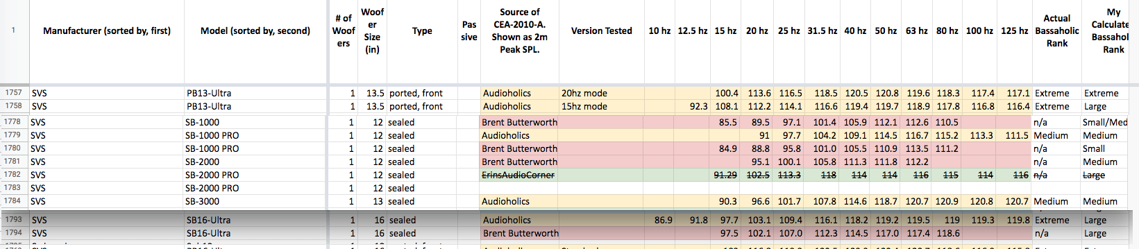

SVS states a 13.3mm Xmax for the SB-1000 Pro, which appears to align with CEA-2010-A peak output/distortion tests from multiple sources compiled by @sweetchaos in his Subwoofer Comparison.

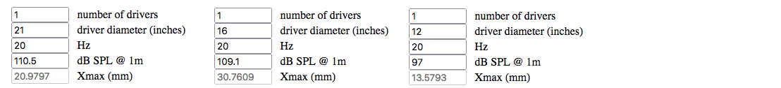

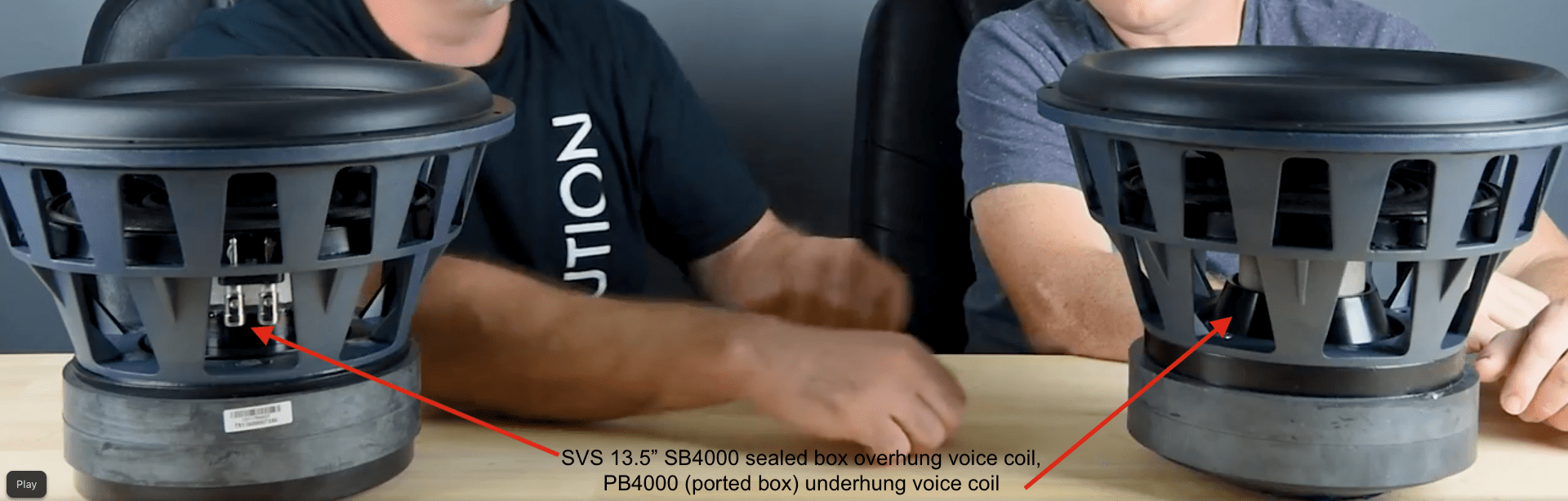

A bit less than half the 65mm peak to peak excursion (65/2=32.5mm seems to correlate with the SVS SB16 Ultra's CEA-2010-A "pass" at 20 Hz, around 102/103dB at 2meters ground plane when adding +6dB to make up the difference between 2meters and one:
CEA-2010 is an industry standard first published in 2006 (updated as CEA-2010-A in 2012) that specifies a method for measuring maximum SPL before distortion reaches a "fail" level at various frequencies, requiring progressively less high order distortion to "pass".
https://docs.google.com/spreadsheet...fyBjaxK69dkXte6ZL6anVTW2_M/edit#gid=834598950
The SVS SB16's 20 Hz output appears to be around equal to Josh Riccis Data Bass CEA-2010-A measurements of the 21" (16.5mm Xvar) B&C21D115 in a sealed box.
