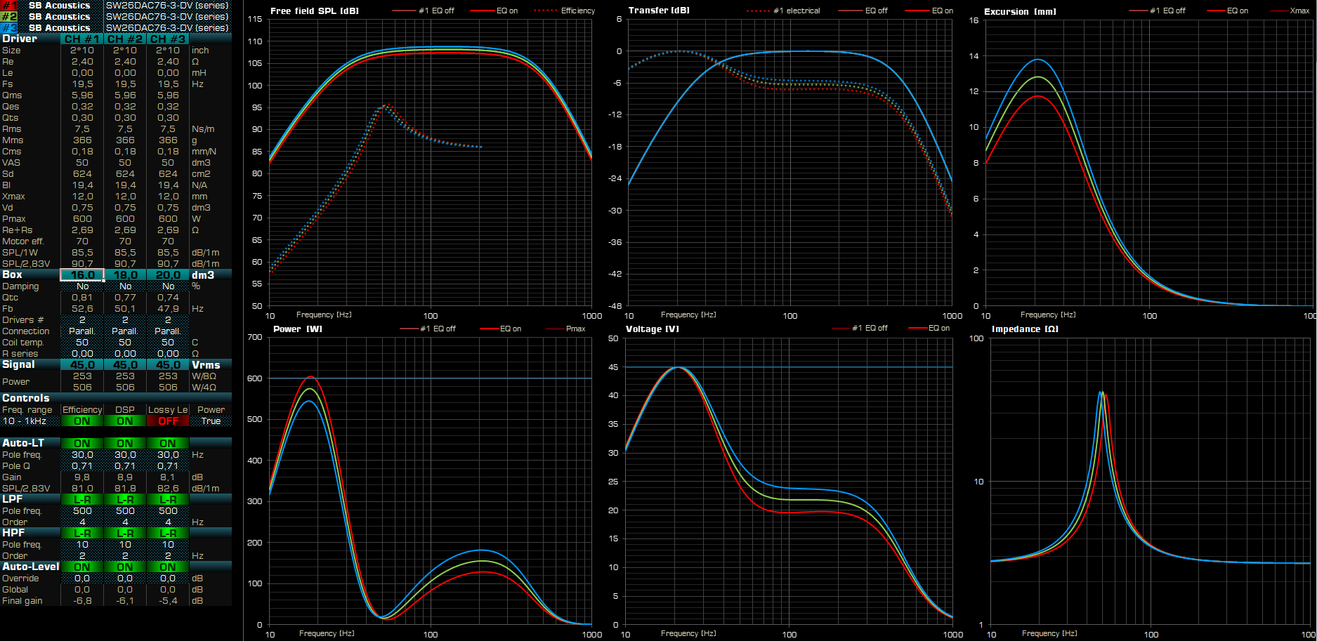

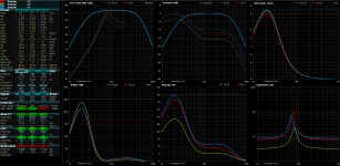

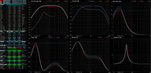

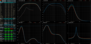

In the attachment there are my sims of mentioned SB driver I did earlier in the day in function of box size, cut-off frequency and voice coil temperature.

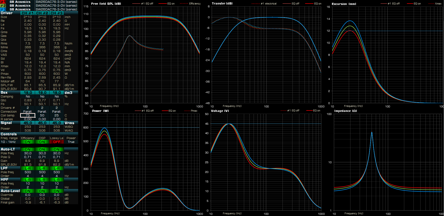

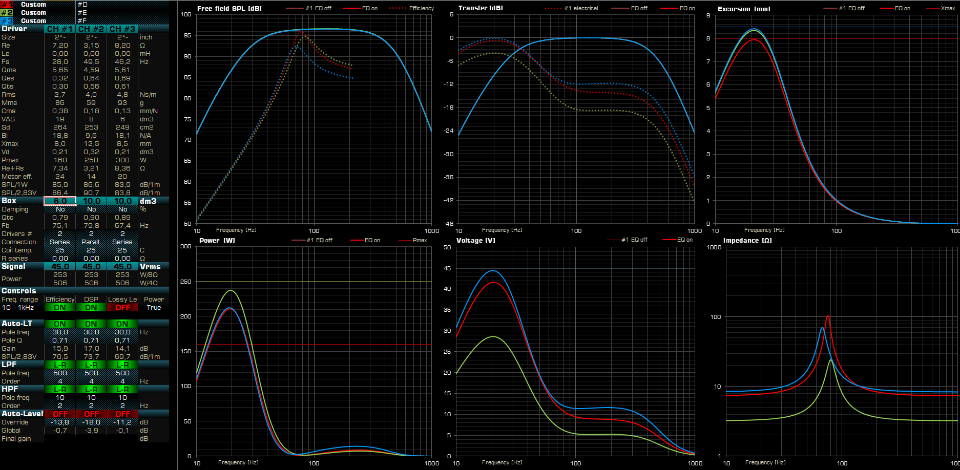

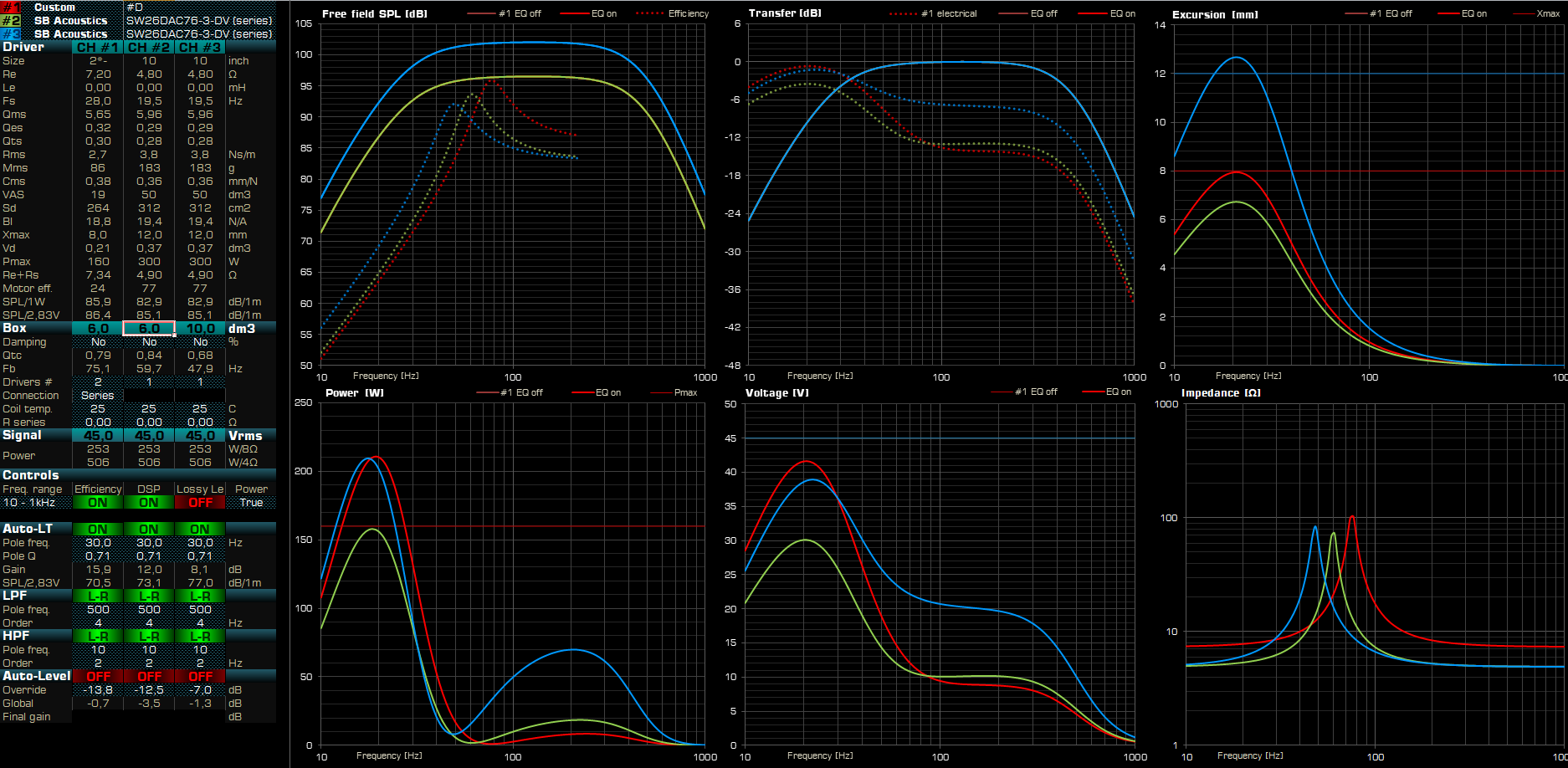

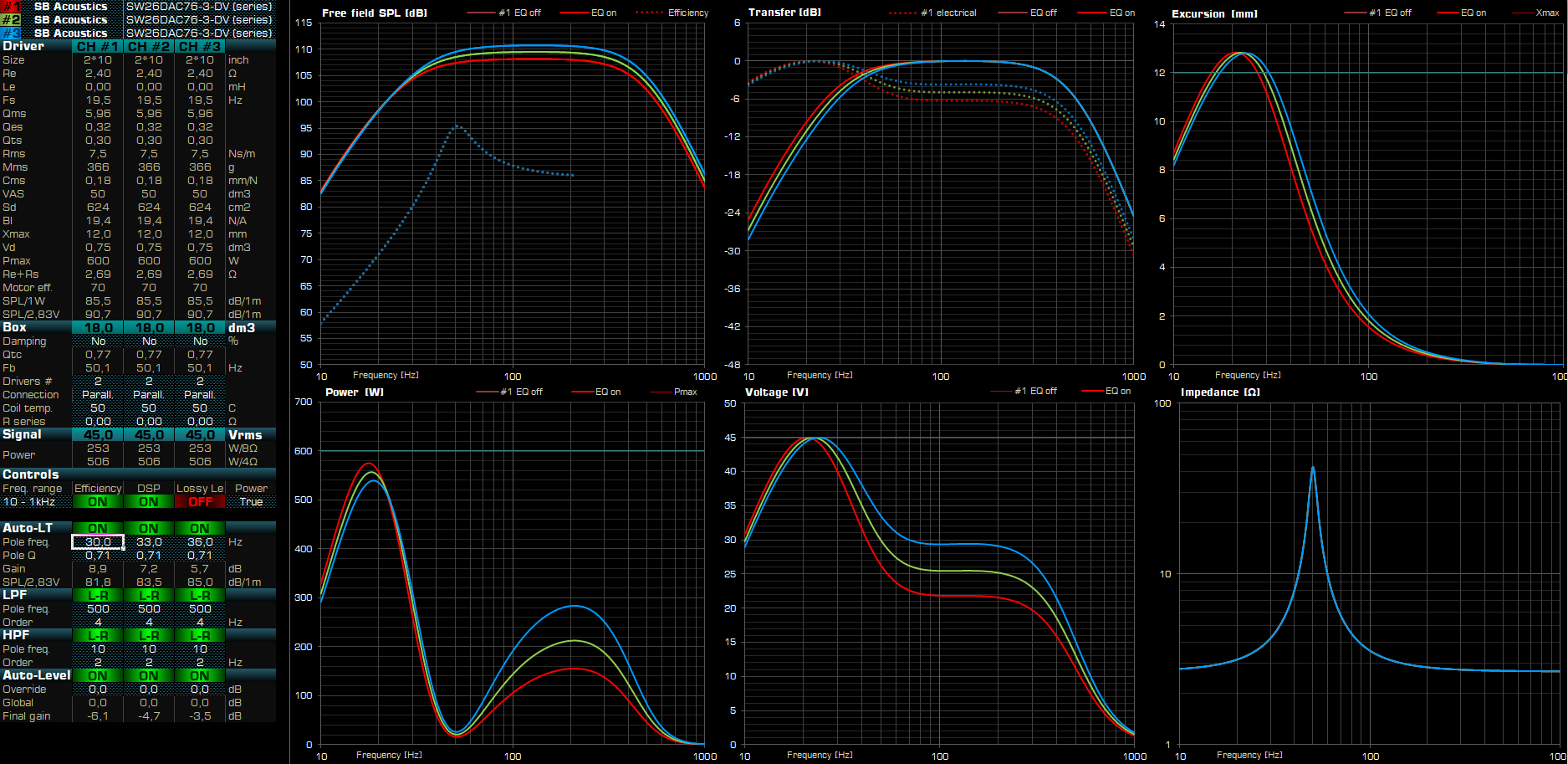

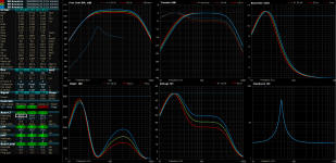

It seems that SW26DAC76-3-DV wins by a far margin, first attachment shows sims for three 7" woofers - red is Reckhorn, green is Anarchy, Blue is Tymphany SBS160F35AL. Reckhorn can provide the same bass efficiency in considerably smaller enclosure (6 dm3 vs 10 dm3) than Tymphany and Anarchy woofers. It is visible on first graph where dB per Watt dotted lines are placed closest to each other in the bass range. Unfortunately it will run out of steam becouse 80W per driver RMS power rating is exceeded. In turn, Anarchy will not be able to fully stretch its wings in this cabinet size and when pushed, it will also jump over the rated RMS power (higher drive levels are not shown, they are brought to the same SPL level). Series vs parallel connection of woofers pairs is irrelevant from power consideration, only from driving voltage.
#2 simulation shows blue and green channels swapped for single SW26DAC76-3-DV woofer. This insane driver will start the game already at 6 dm3 (!) providing even better power efficiency than a pair of Reckhorns in the same cabinet space and also the same SPL at lower cone travel (but its red graph is covered by green on the first diagram). Changing cabinet size to 10 dm3 ends with +6dB SPL gain at the power usage of pair of Reckhorns and utiliziation of full cone excursion under moderate drive voltage.
SB woofer wins heavily also in category displacement per driver's weight and is a bit worse in displacement per dollar as Reckhorn.
